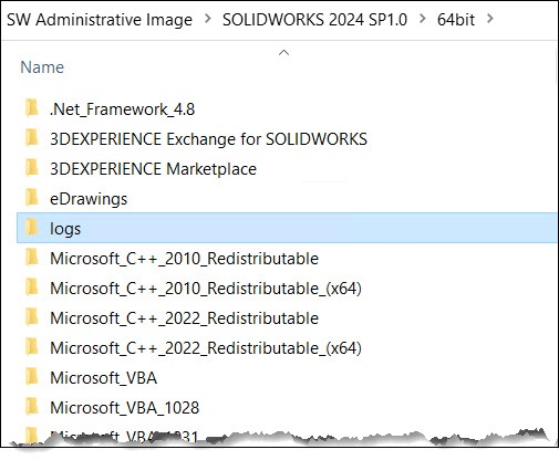

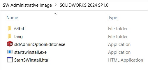

In case of Administrative Image Installations: If you enable the Administrative Options “Create a diagnostic log during each installation”, the SOLIDWORKS Installation Manager requires that all clients have write access to the Logs directory that is created as part of the administrative image, which is “[Administrative image directory]\\x64\\Logs”. Client installations will fail if the client is unable to write to this location.
If you see the message: “You must set write permission to the logs directory or client installations will fail,” click OK and modify the permissions to the newly created logs directory, where needed, before performing a client installation.

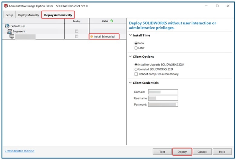

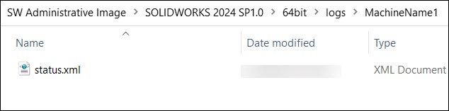

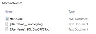

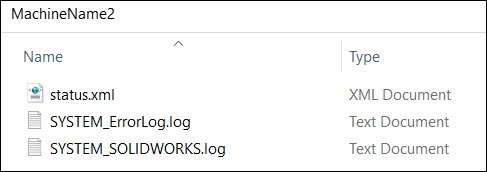

Files created in the [Administrative image directory]\\x64\\Logs\\[machine_name] folder based on the deploy method are listed below;
  1. Status file: The “Status.xml” file contains the status information like Install Scheduled, Installing, Install Successfully or Install Failed.
  2. Error log: The “*_ErrorLog” files are created by the SOLIDWORKS Installation Manager. Basically, these files are copies of the sldlMLog file.
    1. For Manual/Pull Install it is [UserName]log”
    2. For Automatic/Push Install it is “log
  3. Product log: The logs that contain the product name are the Windows® Installer(Verbose) logs. These logs are created by the Microsoft® Installer (or MSI), that installs each product.They contain information that corresponds to the product specified in the file name. For instance, the “[UserName]_SOLIDWORKS.log” file will contain information only about the solidworks.msi installation. Upon installation of other products, there will be addition of product name log files.
    1. For Manual/Pull Install it is [UserName]_[ProductName].log”
    2. For Automatic/Push Install it is “SYSTEM_[ProductName].log

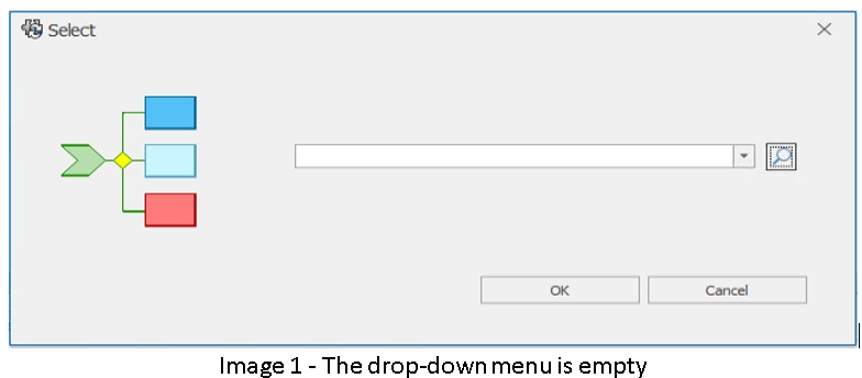

The Send to Process option allows a record to be sent straight to a process. If the Send to Process button is clicked, the user must select a process from the drop-down list in the popup window. Most of the time, while configuring a new process in SOLIDWORKS Manage, System Administrators forget to include certain options. When a user attempts to send a record to a new process, the drop-down menu is empty, or the notice “This process does not allow items with this status: Checked Out. Press Ok to ignore or Cancel to abort this operation” appears.

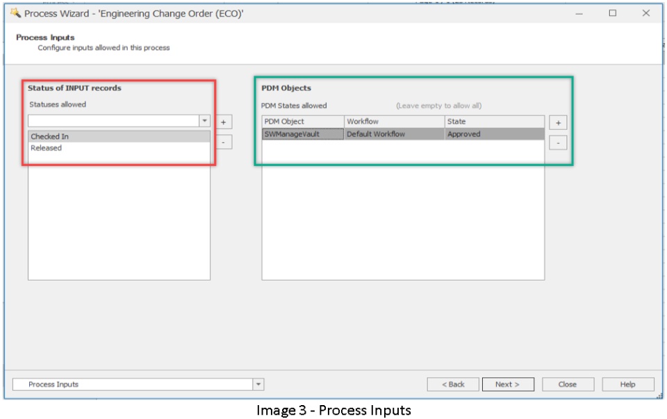

  1. Process Inputs: Each process has the option to allow or restrict the records that can be sent to the process’s initial stage based on Record Status and/or PDM State. Only records with status added under ‘Status of INPUT records’ will be allowed in the process. For the PDM records status needs to added under ‘PDM Objects’. If there is no status added under PDM Objects, then all PDM States are allowed.Image 2 displays a warning indicating that this process does not allow items with the status Checked Out. Image 3 clearly illustrates that only ‘Checked In’ and ‘Released’ records can be sent to process, and the file with the warning notice is in the Checked-Out state.

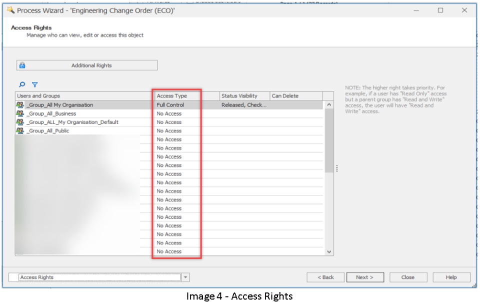

  2. Access Rights: The Access Rights option determines which Users or Groups have access to this procedure. The group or user that initiated the new process must have Full Control over it. Check the Access Rights tab to ensure that the process has permissions.

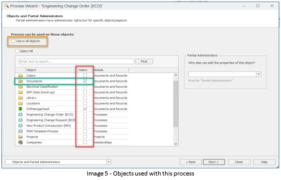

  3. Objects and Partial Administrators: Choose which objects can be used in this process. This process will thereafter be available when a user provides a record to process from one of the permitted objects. Under Objects and Partial Administrators, ensure that either the object that will initiate the process is selected. You can also select the ‘Use in all objects’ option if all objects require access to this process.

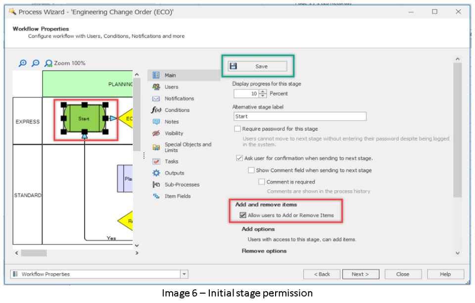

  4. Workflow Properties:Under Workflow Properties, select the first stage and enable ‘Allow Users to Add or Remove Items’. Once this option is selected, objects can be added or removed from this procedure. Don’t forget to click the Save button on the same page. You should now be able to submit your object or record to this process.

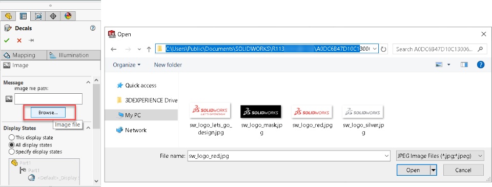

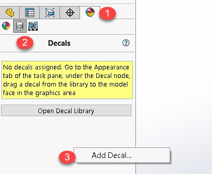

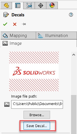

  3. In SOLIDWORKS, navigate to `Display Manager > Decals`. Right-click in the Display Manager and select “Add Decal.”
  4. The Decals Property Manager opens with three tabs: Image, Mapping, and Illumination. From ‘Image’ tab, Select “Browse” and choose the image file from the downloaded folder location to map correctly.
  5. After configuring the decal settings, save the decal locally within SOLIDWORKS.
  6. Once the decal is saved, upload the content back to the platform’s bookmark folder

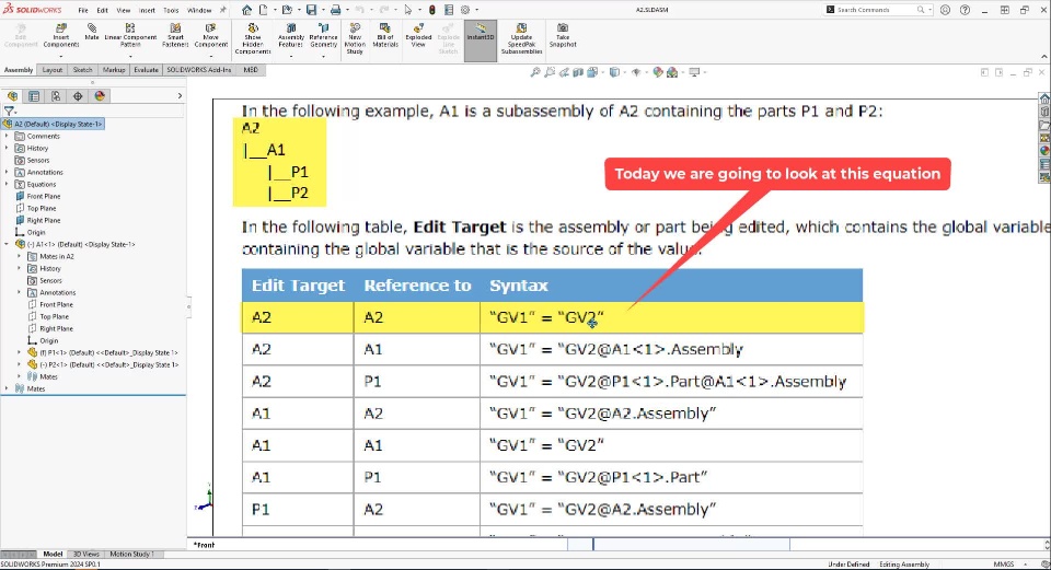

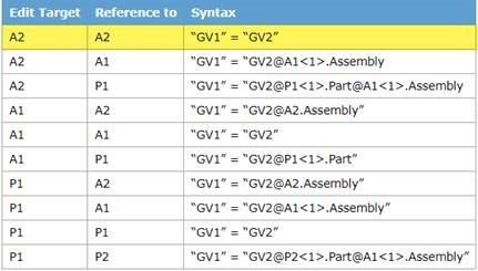

Throughout the years I got several requests to explain with examples the SOLIDWORKS online help “Equations in Assemblies” https://help.solidworks.com/2023/english/solidworks/sldworks/c_equations_in_assemblies.htm
