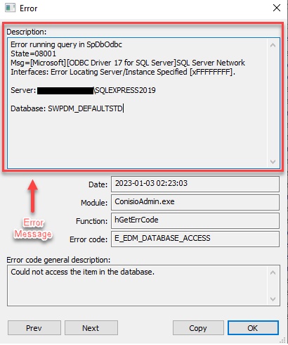

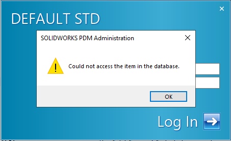

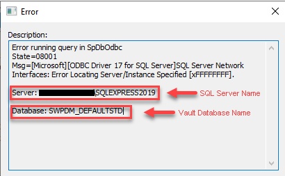

When trying to connect to a new/existing vault in SOLIDWORKS PDM, you may see this generic error where you cannot log into the vault view (Refer Fig 1.1). However, in this blog, we would be specifically focusing on the detailed error in the SOLIDWORKS PDM Client log and would look at different ways to troubleshoot it (Refer Fig 1.2)
fig 1.1
fig 1.2
The error is usually observed on PDM client machines when the protocol,  that is required for communication between the SOLIDWORKS PDM Client and SQL Server is absent OR it is not running. This is why it cannot communicate with the protocol and has trouble locating the Server/Instance.

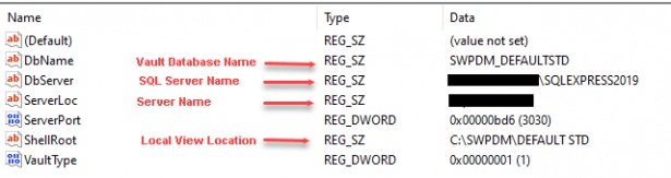

  1. Whenever you see the message ‘Could not access the database’ when login into the vault, it is important to go through the details of the error in the SOLIDWORKS PDM Client log (Open Administration Tool, and Double Click on ‘Log File’ found under Local Settings). The next thing to check is the SQL Server details, as the instance/database name may be incorrectly defined. We have seen some cases where during a server upgrade or Move/Restore scenario, the SQL Server is pointing toward the old machine details, and just checking the error thoroughly can save a lot of time and this issue can be rectified immediately (Refer Fig 1.3.1 & 1.3.2).
    fig 1.3.1
fig 1.3.2
The location where the Server entries are found in Windows Registry location mentioned below:
Computer\HKEY_LOCAL_MACHINE\SOFTWARE\SolidWorks\Applications\PDMWorks Enterprise\Databases\
  • Computer\HKEY_LOCAL_MACHINE\SOFTWARE\WOW6432Node\SolidWorks\Applications\PDMWorks Enterprise\Databases\

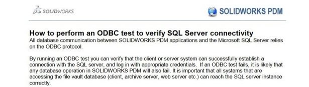

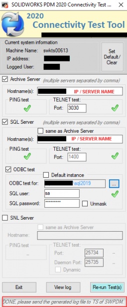

  1. The next thing to check is whether the client can communicate with the server. You can either ping/telnet Server machine or use the Connectivity Test Tool (Refer QA00000119794 in Knowledge Base) from the client machine (Refer Fig 1.4). If the PDM client machine is not able to communicate with the SQL Server, it is recommended to involve the IT team to look as if the necessary ports are open, and not blocked by any firewall

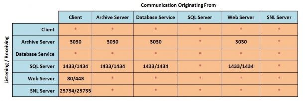

Tip : You can go through the following matrix to see the list of necessary ports that should be opened to be able to communicate between a PDM Client machine and Server (Refer Fig 1.5).

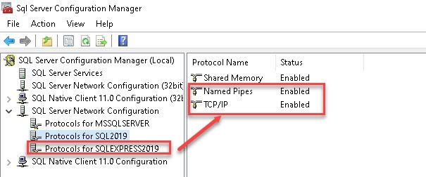

    1. In SQL Server Configuration Manager, Navigate to ‘SQL Server Network Configuration’ and check if the ‘TCP/IP’ and ‘Named Pipes’ is enabled for the SQL Server Instance (Refer Fig 1.7). It is often seen that for PDM Standard Vault (Since it uses SQL Express version), the ‘TCP/IP’ is disabled and thus the error is seen while login into the vault. fig 1.7

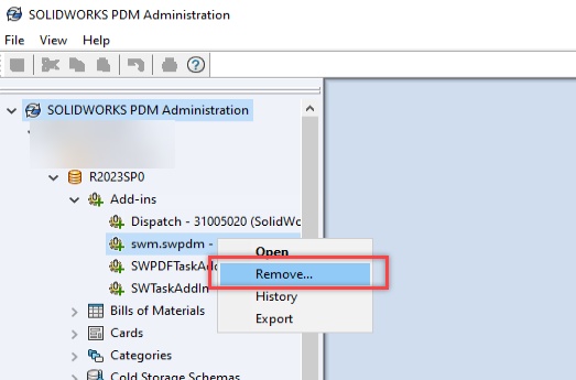

  1. Remove existing Manage Add-in :
    • Open the SOLIDWORKS PDM Professional Administration tool.
    • Login to the vault that you connected with SOLIDWORKS Manage and expand the Add-ins Node
    • Select the previous add-in > Right-click > Remove

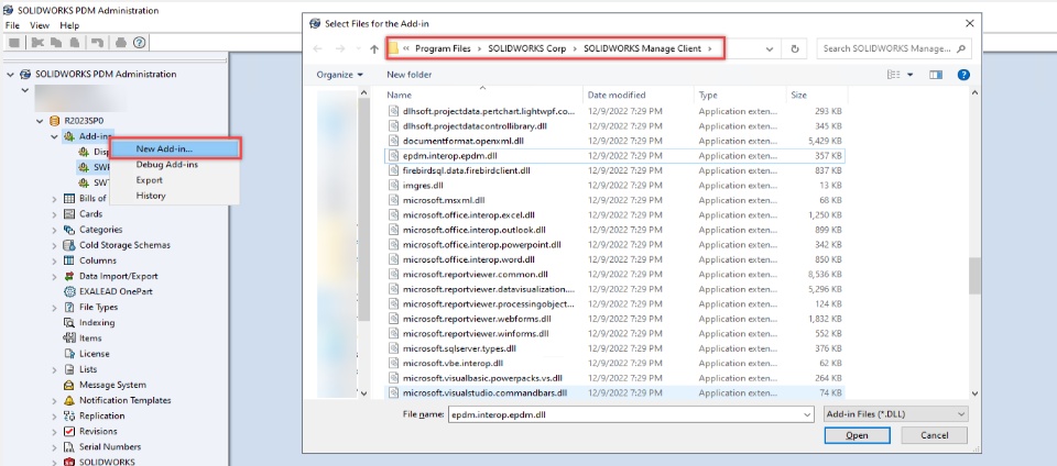

  2. New Add-in :
    • Right-click Add-ins and click New Add-in
    • Navigate to the SOLIDWORKS Manage client installation (such as C:\Program Files\SOLIDWORKS Corp\SOLIDWORKS Manage Client) and select:
      • swpdm.dll
      • Interop.epdm.dll fig 2 : New Add-in

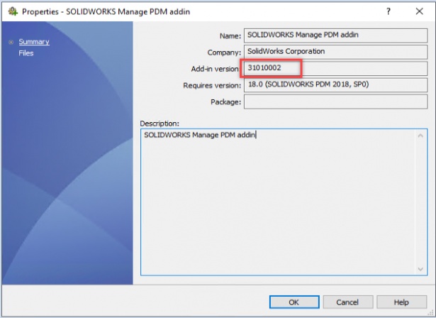

  3. Hit OK on the add-in properties dialog
    • – Note the new version number

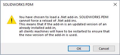

  • Note the warning and hit OK
fig 4: SOLIDWORKS PDM Warning

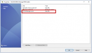

After loading the Manage add-in, you should also add the SOLIDWORKS Manage Configuration  (.swmc) file to the add-in. This is necessary to accommodate SOLIDWORKS PDM users that do not have a SOLIDWORKS Manage client installation. To load the configuration file, follow these steps:
  1. Open the SOLIDWORKS PDM Administration tool.
  2. Expand the ‘Add-ins’ node > right-click on the Manage add-in ‘swm.swpdm’ file> click ‘Open’.
  3. In the ‘Properties’ dialog box, go to the ‘Files’ page and then click ‘Add Files’
  4. In the ‘Select Files’ dialog box, change the filter to ‘All Files (*.*)’, select the Manage Configuration file, and then click ‘Open’.

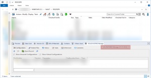

Completing this action includes the configuration file with the add-in.  For a visual reference, see the attached image. If there are subsequent changes to the configuration file, you will need to remove this file from the add-in and then add a new configuration file.
Kill and restart any active PDM Clients and the new version of the add-in is loaded within SOLIDWORKS PDM;

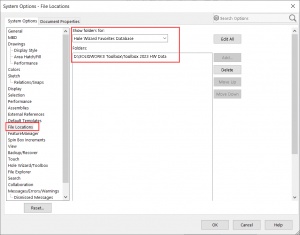

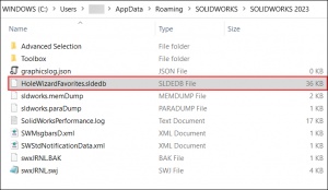

The error message, “SOLIDWORKS needs a folder to store user data for Hole Wizard.  Since the default “data” folder does not have read-write privileges, please select a folder that does” This could be either due to Windows user permissions set on the computer, or specifically the Hole Wizard Favorite’s folder not having read/write access.
Windows user login needs to have read/write privileges at the location, where the hole wizard writes the default database file “HoleWizardFavourites.sldedb”. The default location for which is:
“C:\Users\\AppData\Roaming\SOLIDWORKS\SOLIDWORKS 20XX”
User can also define a different location through Tools Menu > Options > File Location > Hole Wizard Favorite Database. Refer below image for example:
Ensuring read/write permissions to the specified location shall resolve this issue.

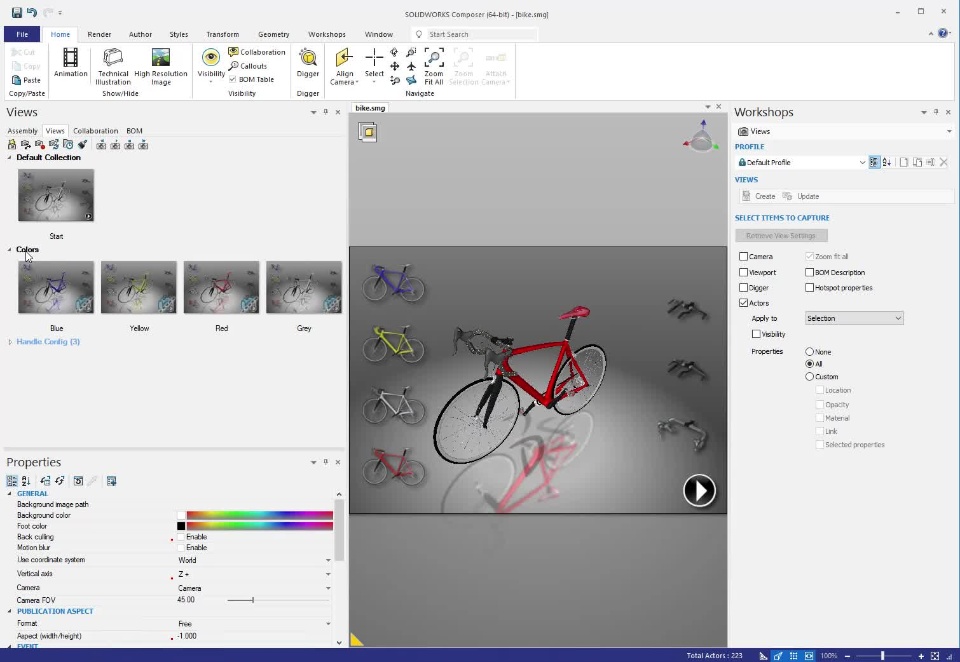

What’s New in SOLIDWORKS Composer 2023 has the ability to categorize the Views into collections. This helps the user segregate / organize the views as per requirement which results in easy interactions of views available in the Project file within Views Pane. I have explained this with help of the following video :
  • Create Collection – To create a View Collection. Select the “ Create View Collection ” in View Pane heads-up bar (OR) ‘Right Click’ View > Add Collection.
  • Rename Collection –  To Rename a View Collection : ‘Right click’ the Collection name  > Rename Collection
  • Drag Views into Collection – Easily move the Views from one collection to other : Single select or Multi-Select with Ctrl / Shift > Drag to Collection.
  • Activate / Deactivate Collection – Useful to Activate a Collection or Deactivate it. ‘Right click’ the Collection name  > Activate / Deactivate Collection.
  • Delete Collection – It deletes the Collection, however keeps the Views in it. ‘Right Click’ the Collection name > Delete Collection.
  • Delete Collection Views – It keeps the Collection, however deletes the Views in it. Right Click the Collection name > Delete Collection Views.
