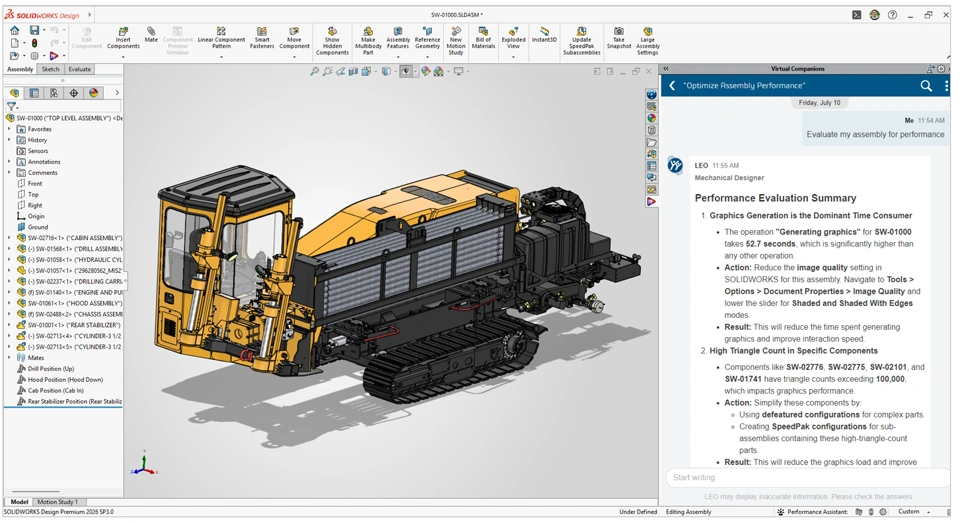

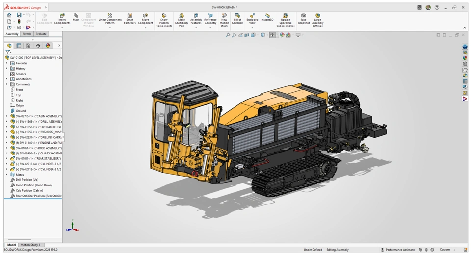

  1. In your SOLIDWORKS Design session, open an assembly from the 3DEXPERIENCE platform or from the local file system.

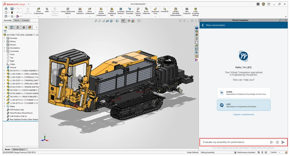

  1. From the Virtual Companions tab in the SOLIDWORKS Task Pane, select LEO.

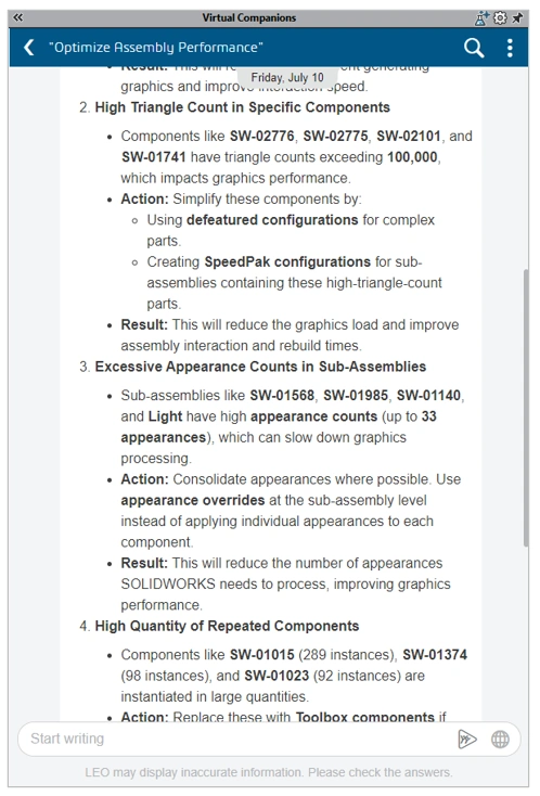

  1. To get LEO to evaluate the assembly by typing the following prompt "evaluate my assembly for performance" in the Start Writing area, followed by the Enter key.
  2. After a few moments, LEO will reply with a summary report. The report will highlight any potential issues that are impacting performance related to saving, opening, rebuild times, and graphics performance.
    If any issues are found, LEO will provide recommendations on how to maximise the performance of the assembly. The recommendations are intended as guidance; it is up to the user to decide whether to make the suggested changes or not.

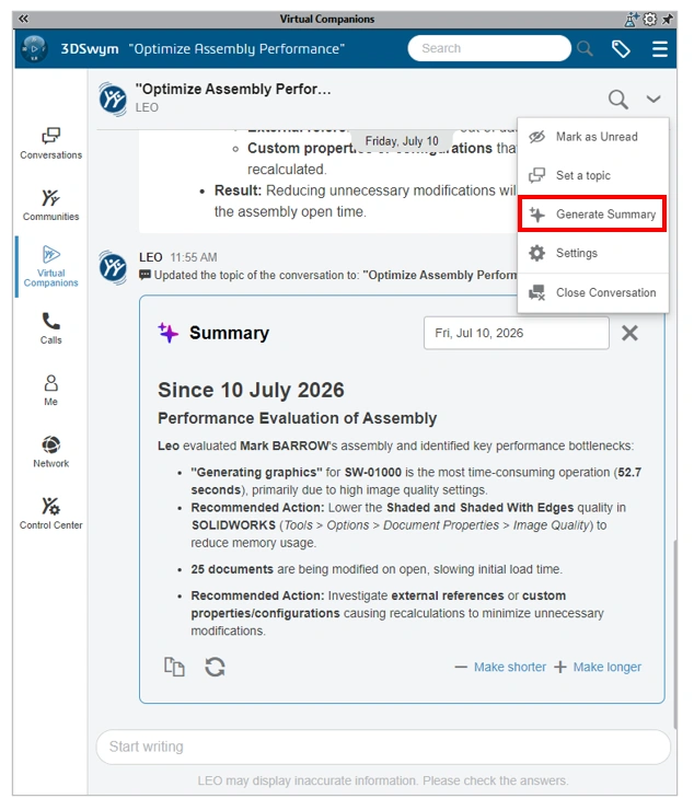

  • If LEO creates a long and detailed response, the Generate Summary option can be used to get a brief overview of the response if required.
