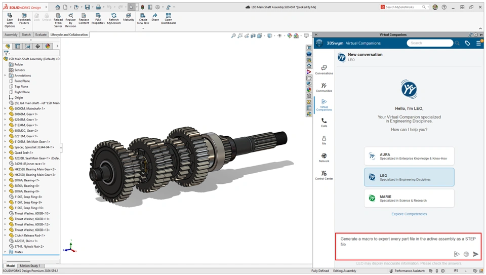

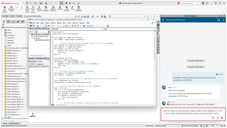

1. From the Virtual Companions tab in the SOLIDWORKS Task Pane, select LEO and type a prompt in the Start Writing Area.
Example: "Generate a macro to export every part file in the active assembly as a STEP file".

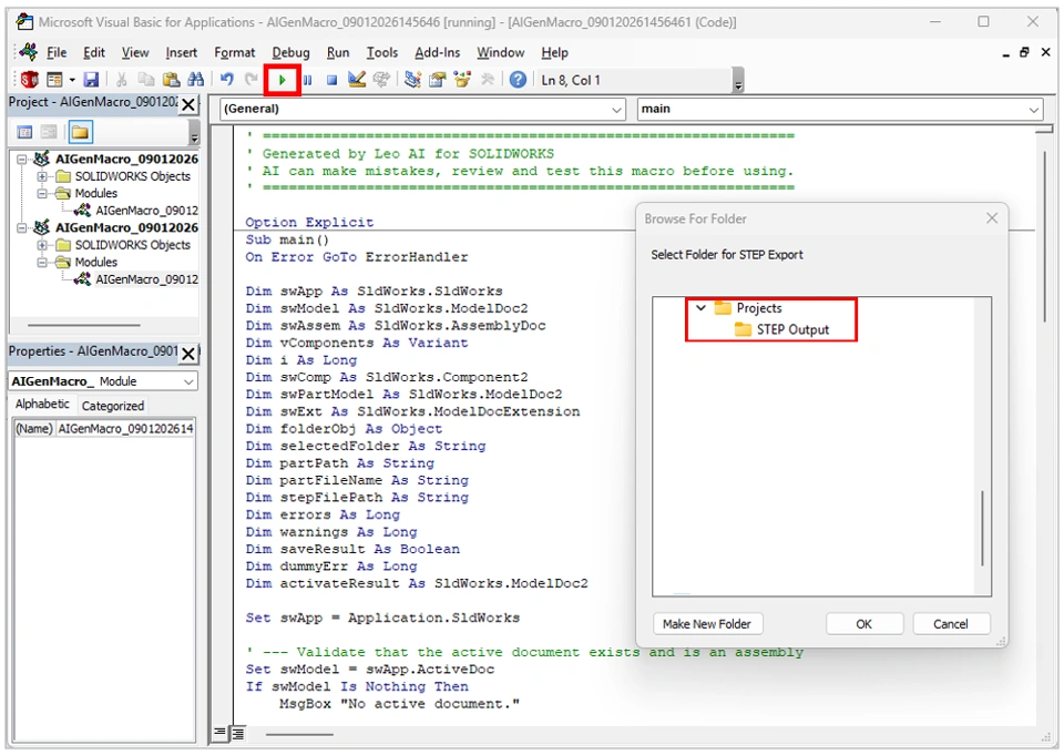

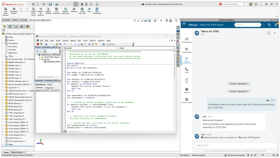

2. When LEO has finished creating the macro, it will open the Visual Basic for Applications (VBA) editor and display your finished macro. VBA is the engine that records, runs, or edits macros, and is embedded in SOLIDWORKS Design.
Note: The VBA editor can be used to edit the macro manually if required.

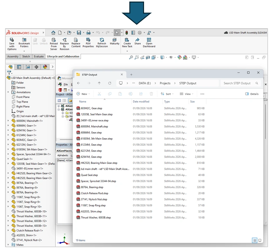

3. To run the macro, select the Run icon in the VBA window. In this example, the LEO has designed the macro to prompt the user to choose which folder to save the STEP files to.

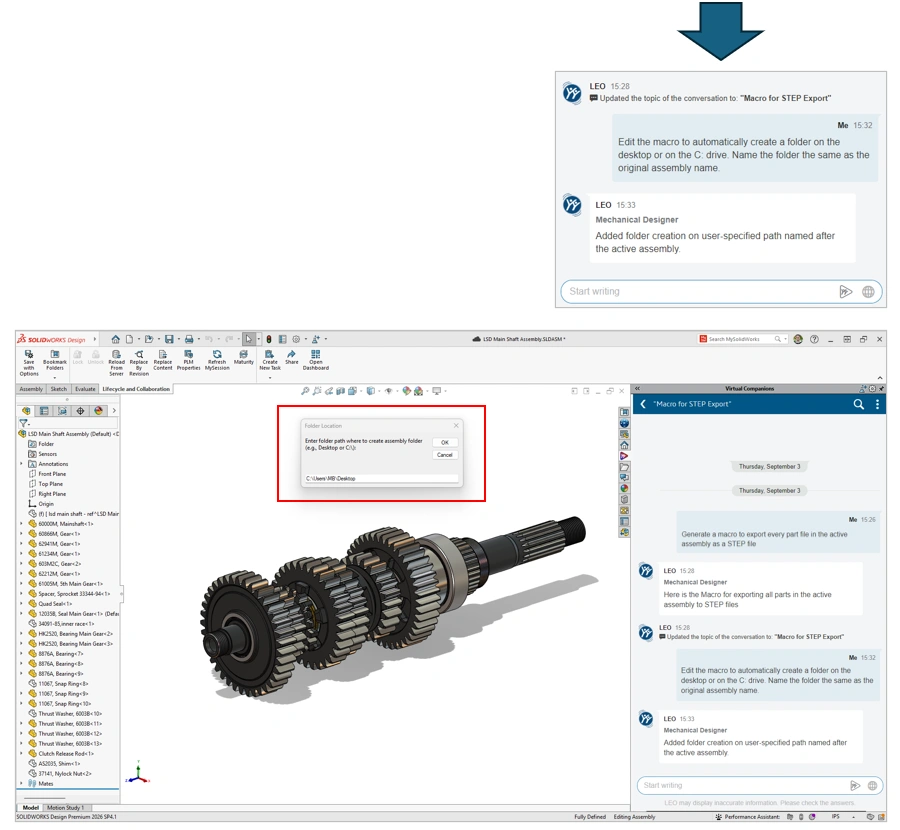

4. LEO can also assist with editing the macro. Just type a description of the changes that are needed in the current LEO conversation, and LEO will rebuild the macro with your changes. Re-run the updated macro to validate it.
Example: "Edit the macro to automatically create a folder on the desktop or on the C: drive. Name the folder the same as the original assembly name.".
Further modifications can be requested by continuing the conversation with LEO.
There may be times when a requested modification is not possible. This could be due to exceeding a limitation of the macro tools. In this situation, LEO warn the user.

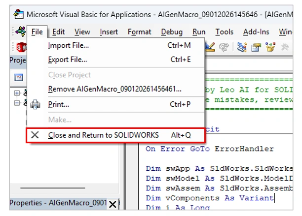

5. Using the VBA editor, you can save your macro. When you are finished, exit the VBA editor via File-> Close and return to SOLIDWORKS.
