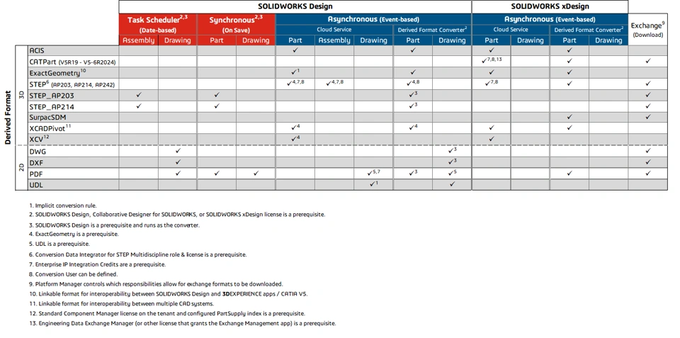

  3. 2D and 3D data used to generate other derived output. See section 6) Derived Output for more information.

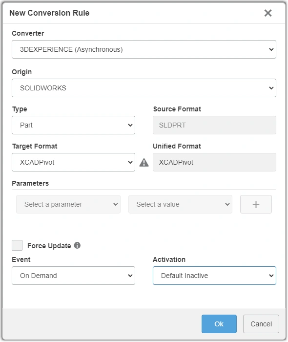

To add conversion rules, in the Derived Format Management console,
  1. Click New Conversion Rule:
Figure 6 – The New Conversion Rule icon.

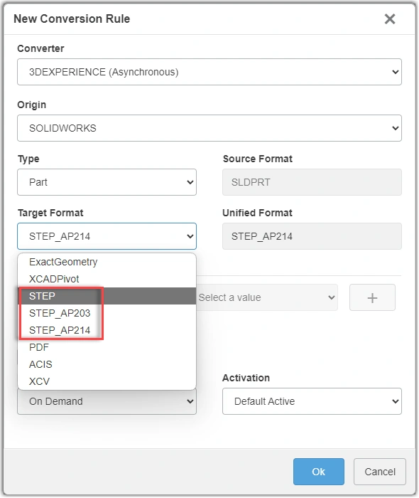

2. Define the conversion parameters.
The following parameters are available for synchronous and asynchronous rules:
Figure 7 - Blank conversion rule dialog
  • Converter: The application that generates derived output.
  • Origin: The source of your CAD data. For this document, SOLIDWORKS or 3DEXPERIENCE.
  • Type: The CAD document type, part or drawing.
  • Target Format: The file format that you want to generate.
    The following parameters are only available for asynchronous rules:
  • Parameters (Optional): Only for some formats.
  • Force Update (Optional)
  • Event
  • Activation
  • Conversion User: Only for STEP and CATPart.
<span class="cke-highlighted" style="background-color:#f8afc8">For more information, see section </span><a href="https://r1132100503382-eu1-3dswym.3dexperience.3ds.com/community/swym:prd:R1132100503382:community:52?content=swym:prd:R1132100503382:wikitree:kyXBfvO8SeWd_akvr0M3jQ§ion=ii_asynchronous_converter" rel="nofollow"><span class="cke-highlighted" style="background-color:#f8afc8">4)b)ii) <strong>Asynchronous Converter</strong></span></a>
3. Click OK to close the New Conversion Rule dialog.
Figure 8 – Example of a new conversion rule that is not deployed.
The rule shows in the table, and the Deploy Status has the following symbol. This symbol means, New, not yet Applied.
4. Click Apply to deploy the conversion rule.
The Deploy Status changes from (New, not yet Applied) to (Applied).
NOTE: If the <strong>Deploy Status</strong> is <strong>New, not yet Applied</strong> and you click <strong>Reset</strong>, the system deletes the conversion rule. The <strong>Reset</strong> does <i>not</i> delete deployed conversion rules.
i) Synchronous Converter
Figure 9 - If the converter is set to anything other than 3DEXPERIENCE, then it is a synchronous rule.
Synchronous converters, like SOLIDWORKS Design, create derived output jobs, process the jobs, and generate the derived output when you save to the 3DEXPERIENCE platform. The derived output generates at the same time as a CAD operation.
Synchronous converters have the following advantages and disadvantages:
AdvantageDisadvantage
Derived output is always synchronized and up-to-date.Save performance is slower.
The derived output result is identical to
File > Save As or File > Export As.
A limited number of formats.
No requirement for an additional converter.Derived output generates on save only.
Derived output generates quickly.No optional parameters.
 Only applies to 3DEXPERIENCE SOLIDWORKS and Collaborative Designer for SOLIDWORKS.
 Only SOLIDWORKS users create jobs.
 You cannot control derived output filenames.
ii) Asynchronous Converter
Figure 10 - If the converter is set to 3DEXPERIENCE, then it is an asynchronous rule.
Asynchronous converters rely on the 3DEXPERIENCE platform or a web app to create derived output jobs. The converter (ConversionAdministration Cloud Service or Derived Format Converter) processes the jobs and generates the derived output after an event. The derived output does not generate at the same time as a CAD operation.
Asynchronous converters have the following advantages and disadvantages:
Save performance is faster.DO is not always synchronized and up-to-date.
More formats are available.DO result can be different from File > Save As.
DO generates after an event of your choosing.There can be a requirement for another converter.
More parameters and options for some formats.There can be a requirement for more licenses.
You can create jobs outside of SOLIDWORKS in web apps.There can be a requirement for more workstations.
Non-CAD platform members can create jobs.Derived output generates more slowly with DFC.
Applies to all 3DEXPERIENCE Works roles and apps, including SOLIDWORKS Cloud.
You can control derived output filenames.

c) STEP
Figure 21 - Asynchronous STEP_AP214 conversion rule which requires SOLIDWORKS to be generated.
A 3D format based on one of seven ISO 10303-21 or STEP Application Protocols: AP203, AP203 E2, AP214, AP214 E3, AP242, AP242 E2, or AP242 E3.
It can generate synchronously or asynchronously. It is an exchange format that you can download and delete.
Three formats are available. STEP_AP203 and STEP_AP214 use the Derived Format Converter or SOLIDWORKS as the converter. STEP, which includes all seven protocols, uses ConversionAdministration Cloud Service or the Derived Format Converter as the converter.
This format requires a Conversion Data Integrator for STEP Multidiscipline license.
Figure 22 – Synchronous (SOLIDWORKS) generated STEP AP203 derived output details.
Figure 23 – Asynchronous (Derived Format Converter + SOLIDWORKS) generated STEP AP203 derived output details.
Figure 24 - Asynchronous (Derived Format Converter) generated STEP AP214 derived output details.
Figure 25 – Asynchronous (ConversionAdministration Cloud Service) generated STEP AP242 derived output details.

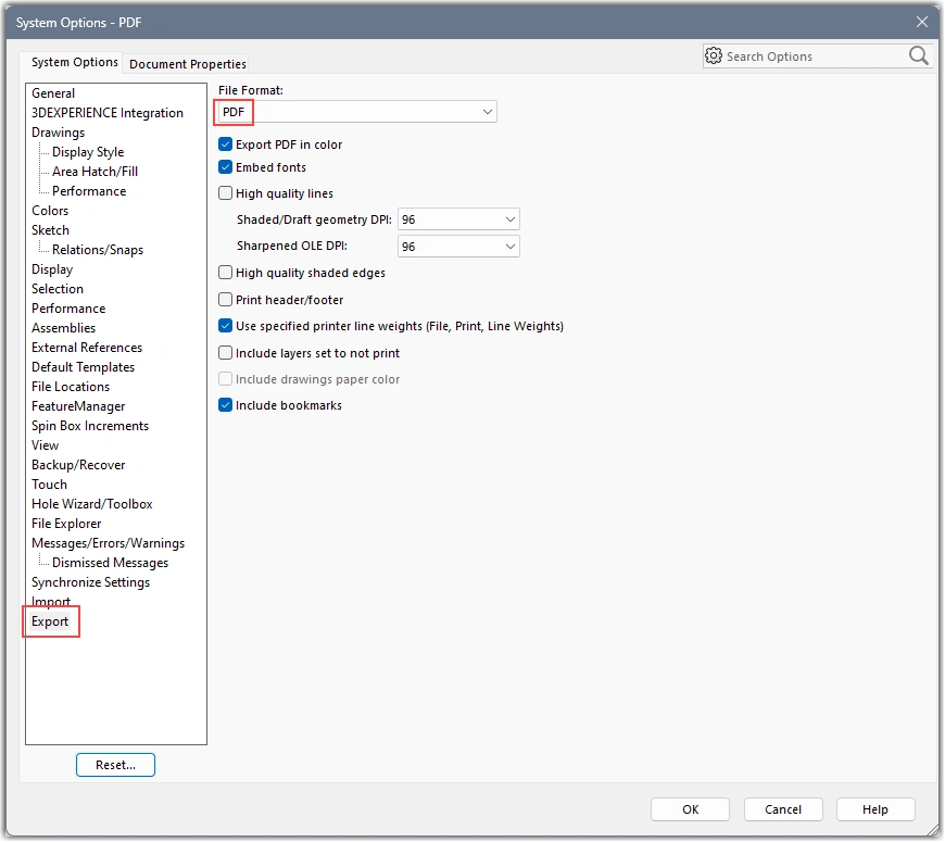

Figure 29 - Synchronous PDF derived output uses SOLIDWORKS export options.

f) XCADPivot
Figure 32 - Asynchronous XCADPivot conversion rule.
A 3D format based on ISO 10303-21 or STEP Application Protocols: AP242 E3.
This format generates asynchronously using ConversionAdministration Cloud Service or the Derived Format Converter as the converter.
It is a linkable format that you cannot download and cannot delete.
This format is for interoperability between any CAD system.
Figure 33 - XCADPivot derived output details.

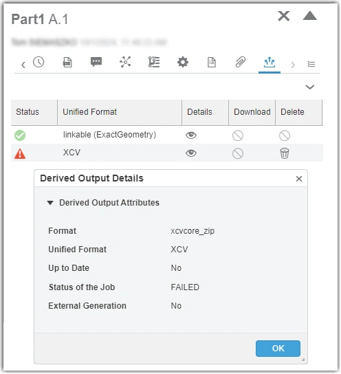

h) XCV
Figure 36 - Asynchronous XCV conversion rule.
A ZIP format which uses data from ExactGeometry derived output. It is a 3D component signature that enables semantic search and 3D similarity capabilities. The Standard Component Manager / Preferred Component Consumer roles, and PartSupply Enterprise Manager / PartSupply Enterprise Reuse apps use this format.
This format generates asynchronously using ConversionAdministration Cloud Service as the converter.
It is a linkable format that you cannot download and cannot view details of. You can delete it.
Figure 37 – XCV derived output details of a failed job because improperly configured PartSupply index.

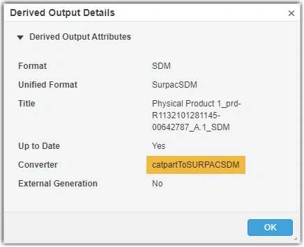

i) SurpacSDM
Figure 40 - Asynchronous SurpacSDM conversion rule.
A 3D format, SDM is a native file format for the GEOVIA® Surpac desktop app.
This format only applies to SOLIDWORKS web apps. Within that context, this format generates asynchronously using the Derived Format Converter as the converter.
Figure 41 - SDM derived output details.

The following matrix summarizes all the synchronous derived output capabilities for the SOLIDWORKS Connected and Design with SOLIDWORKS apps.
Figure 42 - Synchronous derived output matrix for SOLIDWORKS Connected and Design with SOLIDWORKS.
Figure 43 - Synchronous derived output generates during step 6 of the save to 3DEXPERIENCE process.
b) Asynchronous
The following matrix summarizes all the asynchronous derived output capabilities for the SOLIDWORKS Connected and Design with SOLIDWORKS apps.
Figure 44 - Asynchronous derived output matrix for SOLIDWORKS Connected and Design with SOLIDWORKS.
The following matrix summarizes all the asynchronous derived output capabilities for the SOLIDWORKS xDesign.
Figure 45 - Asynchronous derived output matrix for SOLIDWORKS xDesign.

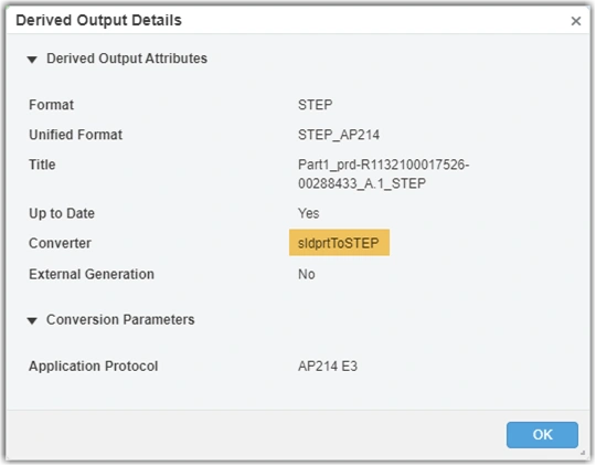

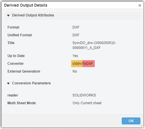

i) Format Details
As depicted throughout section 5) Derived Formats, the Derived Output Details dialog gives you many important pieces of information.
Figure 55 - Click the eye icon to view details of the job and format.
Most importantly, the Derived Output Details dialog tells you the Format of the derived output, its Title, and the Converter that generated it. The converters you can see here are:
Figure 56 - Asynchronous (ConversionAdministration Cloud Service) generated STEP AP242 derived output details.
3DEXPERIENCE =
sldprtTo =

Except for XCV and UDL, the status for all other derived formats shows in this interface. Each format can show one of five job statuses:
Submitted. A platform member or app created the job.
Running. A converter is processing the job.
Up to date. A converter processed the job and generated derived output.
Failed. A converter failed to process the job and generate the derived output.
Out-of-date. A platform member modified the CAD object. The derived output is not accurate. You must regenerate it.
Click Refresh view to update the view of job statuses or derived formats.
Figure 58 - Refresh view icon.
Of the five statuses, you can click the Submitted, Running, and Failed icons to view more information about of the corresponding derived output job. Clicking an icon opens the job in the Collaboration and Approvals app.
Figure 59 - Details of a Submitted derived output job in Collaboration and Approvals.
Figure 60 - Details of a Running derived output job in Collaboration and Approvals.
Figure 61 - Details of a Failed derived output job in Collaboration and Approvals.
The derived output job reveals some useful information:
  • The Name (attribute) of the job. In the example from Figure 61, the Name is:
    DOJob_3sh-OI000250532-00000019_A_1095083078748451
    The Name of a derived output job follows this naming rule:
    DOJob_ContentTypeName_Revision_UniqueID
    You can search your tenant for ContentTypeName to find the related part Physical Product or Drawing.
  • The part Physical Product or Drawing that the derived output links to.
    In the same example, you can identify that XCV derived output generates from the 3D Shape. If there is a failure, knowing the related object is useful for troubleshooting.

Figure 64 – Since the format is STEP, the Derived Output Details tells us it is an asynchronous job.
Figure 65 – The failed asynchronous STEP derived output job in Collaboration and Approvals.
Figure 66 – The Collaboration and Approvals log gives a specific error code, ERR_OMB_1128.
Figure 67 - The HTM report states that, "There is no object to process."
Figure 68 - The ERR report reveals the problem. The platform member processing the job does not have a
Conversion Data Integrator for STEP Multidiscipline license. This license is a requirement to generate STEP derived output.
The Derived Output Details dialog tells us that the target format is STEP. This format means that the job is asynchronous. And the ConversionAdministration Cloud Service or Derived Format Converter processes asynchronous jobs.
The Background Jobs table shows us that there is a log. The system only creates these logs locally. The existence of a log means that the Derived Format Converter processes the job. If ConversionAdministration Cloud Service processes the job, then there is no log. The log gives an error code along with HTM, ERR, and RPT reports.
The ERR report tells us the problem. The platform member running the Derived Format Converter – or the conversion user – does not have a Conversion Data Integrator for STEP Multidiscipline license. This license is a requirement to generate STEP derived output.
This error can also be an indication that there is a change to the signed in platform member, or a connection to a different tenant. If one of these conditions is true, then the platform member must stop or exit the app, delete the CATSettings (DerivedFormatConverter and ENODFBatchSettings), and restart the app.

Figure 73 - 3D derived formats that you can generate from SOLIDWORKS-mastered part Physical Products.

The ConversionAdministration Cloud Service or the Derived Format Converter generates asynchronous XCADPivot derived output. Extra licenses are not a requirement. This derived output is based on the STEP AP242 protocol. SOLIDWORKS opens this file format using 3D Interconnect.
4. STEP
The ConversionAdministration Cloud Service (with Enterprise IP Integration Credits), or the Derived Format Converter can generate STEP derived output. A Conversion Data Integrator for STEP Multidiscipline license is a requirement. This derived output can be any of the seven STEP protocols from 5)c). SOLIDWORKS opens these file formats using 3D Interconnect.
Figure 77 - Native 3DEXPERIENCE Physical Product, with XCADPivot derived output, opened in SOLIDWORKS Connected. STEP derived output has the same result.
<span class="cke-highlighted" style="background-color:hsl( 340 , 84% , 83% )">If a Physical Product has multiple derived formats, or all four, then SOLIDWORKS opens ExactGeometry, then STEP, then XCADPivot, then CGR. In other words, regardless of the derived output, if ExactGeometry exists then it opens.</span>

Refer to the asynchronous matrices in 6)b). The ConversionAdministration Cloud Service always tries to process the derived formats that it can process. If credits are available, then the service generates the derived output. If credits are not available, then the job falls back to the Derived Format Converter. If the system cannot find a Derived Format Converter system with proper credentials and licenses, then the job times out and fails.

If there is a derived format, like STEP_AP203 or STEP_AP214, that you require, and you cannot or do not want to purchase a Conversion Data Integrator for STEP Multidiscipline license, then use the Derived Format Converter.
