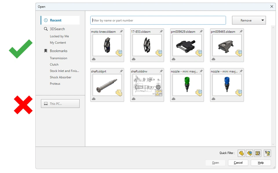

The first stage of any concurrent assembly design activity is for each user to open the design. There are a number of different ways a SOLIDWORKS assembly can be opened from the 3DEXPERIENCE platform, and it is important to understand the impact of each method and how it relates to the MySession task pane status display.
Starting with an empty local working folder, when a user opens an assembly from the 3DEXPERIENCE platform using File ->Open in SOLIDWORKS Design, a copy of the files is automatically downloaded to the user’s local working folder.
This is also true if a user opens an assembly from 3DSearch results or a Bookmark in the MySession Task Pane. When two users open the same assembly, a copy of the assembly will reside in the local working folder of each user.
Whether opening an assembly from File ->Open, 3DSearch, or Bookmarks in the MySession Task Pane, or directly from the local working folder, if some of the referenced files already reside in the user’s local working folder, the local versions of the files will be loaded into the SOLIDWORKS session instead of being downloaded from the cloud. This behaviour decreases the overall load time by only downloading necessary files. However, in a scenario where multiple users are working on different areas of the same assembly structure, the local copies loaded in session may differ from the versions currently stored on the 3DEXPERIENCE platform.

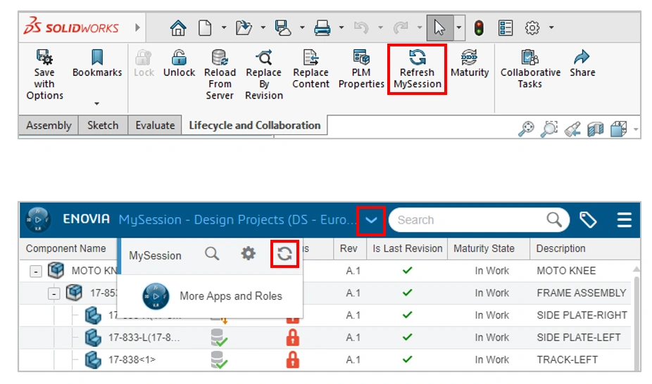

To ensure that the MySession modification status of all files loaded from the local working folder is up to date, it is recommended that the SOLIDWORKS MySession setting “Refresh MySession after opening files” is enabled.
This option, when checked, will automatically trigger a refresh of the MySession status information of all components after the loading operation has completed. Any later modified versions or new revisions that exist in the database will be highlighted in the status column.
<strong>Note: A refresh of MySession information is only triggered when opening content from the 3DEXPERIENCE platform, and not when browsing to and opening files directly from the local working folder using the "This PC..." option.</strong>
U<strong>sers should always open SOLIDWORKS content from the 3DEXPERIENCE platform when working in a concurrent assembly design scenario.</strong>
When the Refresh MySession After Opening Files option is unchecked,  MySession status information is not automatically updated after an assembly is loaded. Therefore, the user will not indicate whether later modified versions or new revisions of the files are available in the database. The MySession status information can be refreshed manually by using the Refresh MySession button in the MySession Task Pane and on the Lifecycle command manager tab.

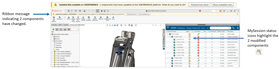

When a refresh of MySession Status detects that newer modified versions of some of the components are available in the 3DEXPERIENCE platform, the user is notified via a ribbon message in the SOLIDWORKS user interface and by status symbols in the MySession task pane.
At this point, a user has two options: they can choose to ignore the message and continue working, or choose to reload the modified components from the 3DEXPERIENCE platform. The Reload From Server command is used to download and replace modified files with their latest version on the 3DEXPERIENCE platform.

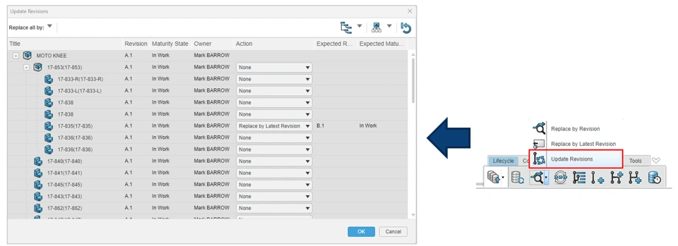

Replacing Out-of-Date Revisions
In a situation where a new revision of one or more components is available following a refresh of MySession, a red cross will appear in the Is Last Revision column next to each. A ribbon message will also be displayed in the SOLIDWORKS user interface, containing a prompt to Update Revisions.
A user can update one or more components to the latest revision in a single operation by using the Update Revisions command.
For further information related to the Update Revisions command, please refer to the following SOLIDWORKS online help page.
https://help.solidworks.com/2025/english/SolidWorks/sldworks/r_update_revision.htm

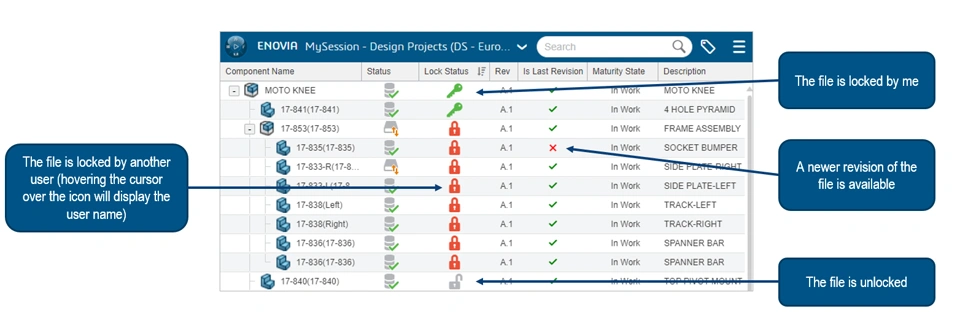

Locking and Unlocking Files

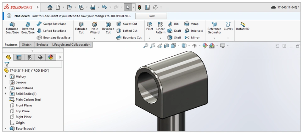

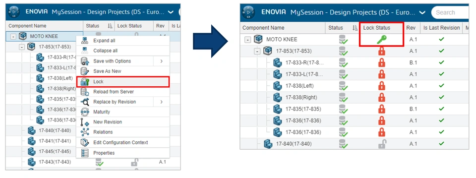

Before making any modifications to a part, assembly, or drawing in SOLIDWORKS Design, the user should first lock the component. Locking the file prevents other users from saving changes to the same file. In a concurrent design scenario, locking will avoid any saving conflicts. A modified component cannot be saved to the 3DEXPERIENCE platform until it has been locked.
An individual component can be locked by first selecting it and then selecting Lock from the right mouse button menu in the MySession Task pane. A green key icon will be displayed in the Lock Status column to signify that the component is locked by you.
To help guide the user whenever an unlocked file is modified in session, a ribbon message will be displayed in the SOLIDWORKS user interface, warning that the component is not locked.

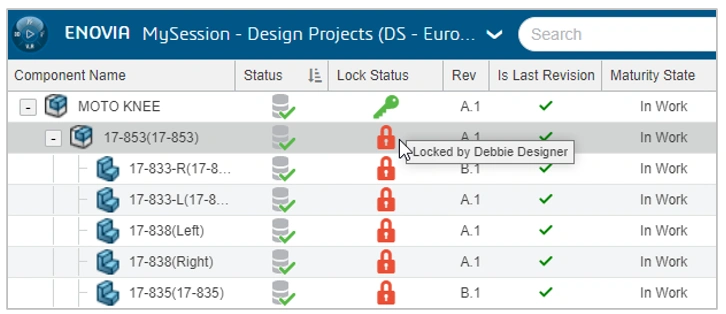

A grey open padlock icon in the lock status column signifies that a component is not locked by anyone.
A red padlock icon in the lock status column signifies that a component has been locked by another user. Hovering the cursor over the padlock will display a tooltip showing the user name.
<strong>Note: Components can also be locked and unlocked using web widgets for example Bookmarks Editor.</strong>

  • Open SOLIDWORKS content from the 3DEXPERIENCE Platform and not directly from the local file system
    • SOLIDWORKS will check the available files in the local working folder first before downloading
    • Only open SOLIDWORKS content directly from the local working folder in situations where a connection to 3DEXPERIENCE is not possible, e.g., travel, network outage

  • Use the manual MySession information refresh while working in a session to check for concurrent changes
    • Automatic refresh of MySession information on save will catch any updates if you forget!
