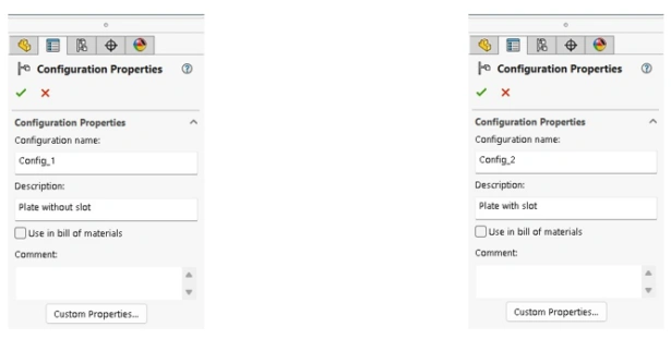

As we all know we can create multiple configurations in SOLIDWORKS®. SOLIDWORKS® also provides ability to add unique description to each configuration. In ConfigurationManager tab, select the configuration > RMB > Properties >, under Description, you can add unique description.
Some of our users have requirement that they want to map this description to the configuration specific custom properties, that is under - File > Properties > Configuration Properties, so that all the configuration related properties can be viewed at same place. Though this property directly cannot be mapped, we can achieve the desire result using design tables functionality in SOLIDWORKS®. In this blog , we will see how the configuration description can be added to custom properties using design tables.
Once the configurations are created and description is added to each configuration, we need to create the design table for the component. In design table, the description is already added for all configurations, we need to call that property in new column using \\\$PRP@
Let us understand this process in detail using simple example. Consider a part file is created having 2 configurations, say ‘Config_1’ and ‘Config_2’ and has description defined ‘Plate without slot’ and ‘Plate with slot’ respectively.

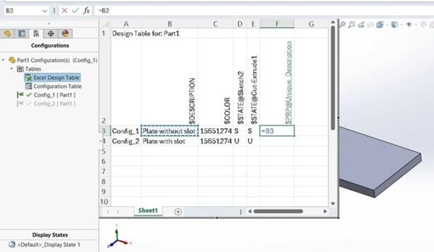

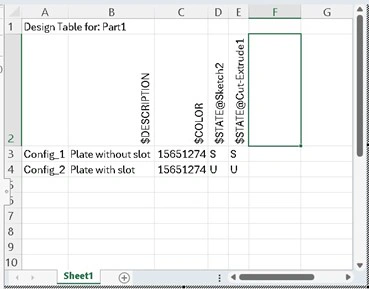

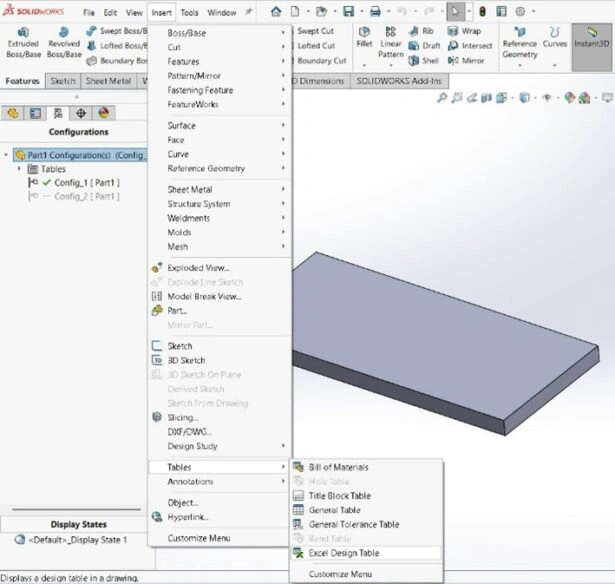

Now go to Insert > Tables > Excel Design Table > OK. Design table is created, You will notice, the configuration description also gets stored in design table for ‘Config_1’ and ‘Config_2’.
Now define the property in new column using syntax \\\$PRP@

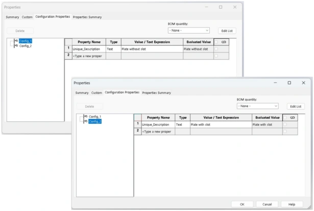

This will create new property named ‘Unique_Description’ under Configuration Properties tab in file properties. Refer image below.
Using this workflow, configuration description can be mapped to custom properties.

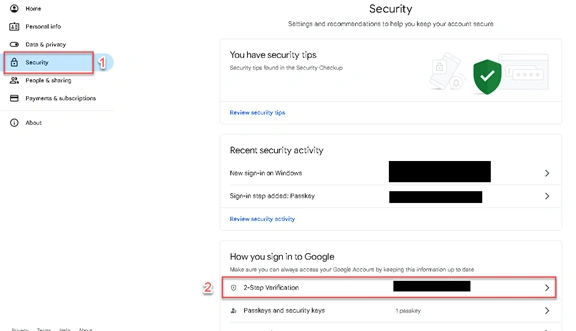

🔐 Step 2: Enable 2-Step Verification
1. Log into your new Gmail account.
2. Navigate to Google Account Settings > Security.
3. Enable 2-Step Verification to add an extra layer of security.

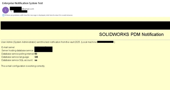

📩 Step 5: Send a Test Mail
Use the Send Test Mail feature to confirm your setup. If everything is configured correctly, you should receive an email almost instantly.

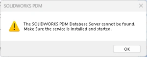

❗ Error: “The SOLIDWORKS PDM Database Server cannot be found...”
- Check that the Database Server service is properly installed and running.
- Verify that other PDM notifications (like database notifications) are working. If they’re failing, SMTP notifications may fail too.

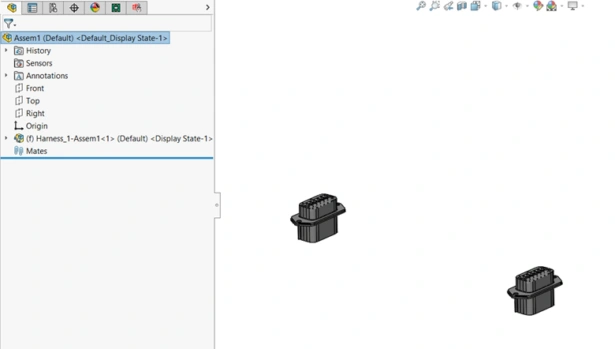

- There are two identical (can also be different) electrical connectors placed at some distance from each other.Note:
- The connectors displayed here are identical.
It is a multi-pin connector with 12 CPoints defined.

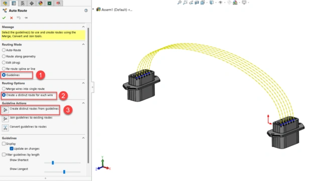

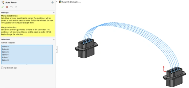

- Let us route the connectors using ‘Auto Route’Make the following selection:
- Routing Mode: select Guidelines
- Routing Options: select Create a distinct route for each wire
Guidelines Actions: select Create distinct route from guidelines
Left box select the guidelines in the graphics area
The splines are selected and displayed in the selection set.Click OK to exit Auto Route and exit route.

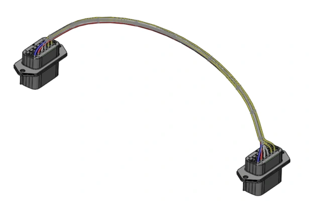

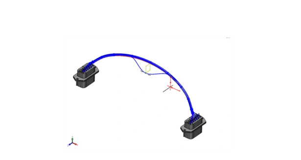

The route is now created and would display as below:
Edit Route and select a point on spline and drag:
Notice that other spline handles adjust to the new position of the single spline that was dragged in above step:
The other wires adjust to the new position. This is helpful when you want to represent a bunch of wires bundled together that will change position when a single wire position is changed; more often when the space is a constraint and the position of wires need to be adjusted with reference to the alignment of other components.
