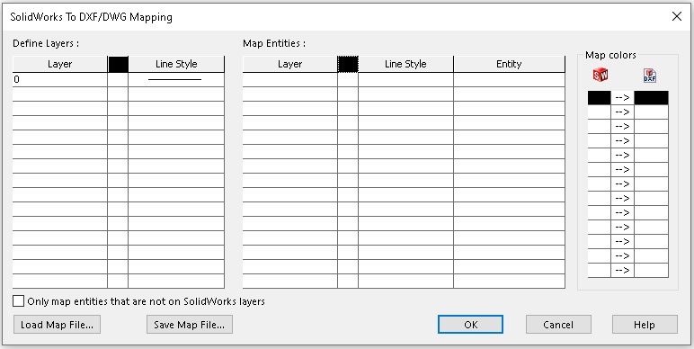

  • Go to File > Save As… > Select ‘.dwg’ file type > Click on ‘Options…’. System Options – DXF/DWG window appears.
  • From Custom Map SOLIDWORKS to DXF/DWG, check ‘Enable’. This activates existing map file browse option. Let this path be empty. Make changes in other sections if wanted and click OK to close this window.
  • Click on ‘Save’ in Save As window. SOLIDWORKS to DXF/DWG window appears.
2.  Go to File > Save As… > Select ‘.dwg’ file type > Click on ‘Options…’. System Options – DXF/DWG window appears.
3.  From Custom Map SOLIDWORKS to DXF/DWG, check ‘Enable’. This activates existing map file browse option. Let this path be empty. Make changes in other sections if wanted and click OK to close this window.
4.  Click on ‘Save’ in Save As window. SOLIDWORKS to DXF/DWG window appears.
  • Define Layers section allows you to define new layers, assign colors to them and set their line style.
  • Map Entities sections allows you to assign these newly created layers to list of entities that might be present on the drawing sheet.
  • Checking option ‘Only map entities that are not on SOLIDWORKS® layers’ only maps the new layers to entities on drawing sheet that are not on SOLIDWORKS® Layers or are on Default Layers.
  • Button ‘Load Map File…’ allows you to load existing map file.
  • Button ‘Save Map File…’ allows you to save recently defined layers in the window as a map file. This file can then be loaded at any given time to map entities with layers set in it.
5.  Define new layers by naming them in the first column. Let’s say, DIMENSIONS and BALLOONS. Set their colors (that do not match with ones in SOLIDWORKS® Drawing) and their line style to ‘Visible Edges’. Line style can vary to any amongst the list of styles.
6.  In ‘Map Entities’ section, select the layer name (DIMENSIONS in this case) from the drop down list by clicking in the blank cell under Layer column. Set the color and Line Style to ‘BL’ (By Layer). In the Entity section, select entity to which you want to assign this layer to. In this case, Dimensions. Similarly, select the second layer and assign it to the Notes in the last column to assign BALLOONS layers to balloons on the sheet as balloons are considered as notes. Also View Labels and notes in sheet format will be considered as notes.

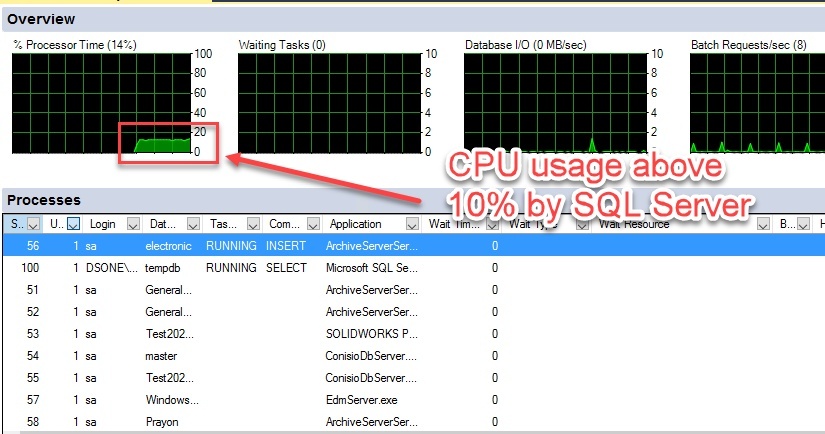

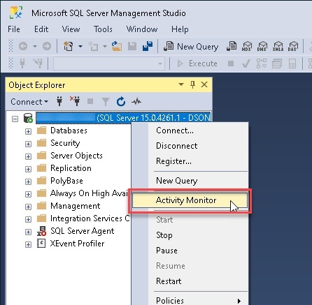

Activity Monitor is a quick way to obtain an overall CPU usage by the SQL server service. After launching and connecting to the SQL Server instance, right-click the server and select ‘Activity Monitor’ option.
SSMS displays the activities for a set time interval. The interval can be changed by right-click the ‘Overview’ heading and selecting the ‘Refresh interval’ option.
The image below shows the archive server service using greater than 10 percent of the total CPU.

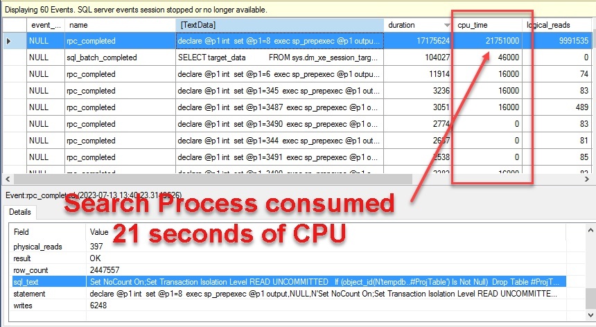

XEvent Profiler is based on Extended Events using two customizable Extended Events templates called QuickSessionStandard and QuckSessionTSQL. Review knowledge base article  QA00000117731 for details on using Extended Events. XEvent Profiler provides a live view of captured events. After stopping the capture, events can be sorted by column values to determine high CPU usage. The image below shows a process lasting 25 seconds.
