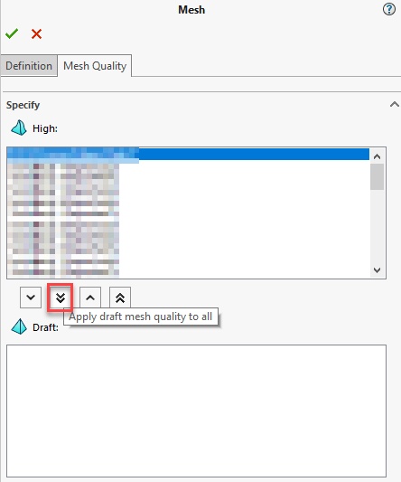

  3. In the copy of the study, change the mesh for all bodies from High Quality to Draft Quality elements (to expedite troubleshooting).

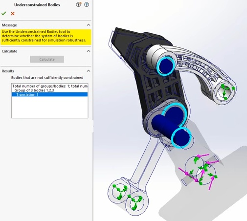

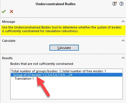

  5. In the study tree, go to Connections > Underconstrained Bodies (or use the new Diagnostic Tools Simulation CommandManager button) and click Calculate.​​​​​​​
  6. Observe that there is one free mode listed, composed of a group of 22 bodies which move together. Click on the group to highlight the offending bodies in the SOLIDWORKS graphics area.​​​​​​​

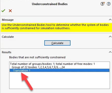

  7. Click on Translation 1 to animate the movement of this group of bodies relative to the rest of the model.​​​​​​​

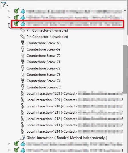

  8. Close the Underconstrained Bodies tool. In the SOLIDWORKS graphics area, click on a body belonging to the aforementioned group to highlight the body in the study tree. Ideally, choose the body that connects the offending group to the remainder of the model.​​​​​​​
  9. Expand the study tree and review any study definitions which include geometry from the body of interest. The animation of the free mode above is likely to help you narrow down a prime suspect or two (especially if you are the one who defined the study).

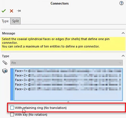

  10. In this case, review of the two pin connectors in which this body participated immediately revealed a mistake in the setup. Considering the design/analysis intent, both pin connectors should have had the With retaining ring (No translation) option active. However, the checkbox was unintentionally cleared for one of them (allowing a completely unrestrained sliding of a group of bodies), which caused the solver to fail due to instability.

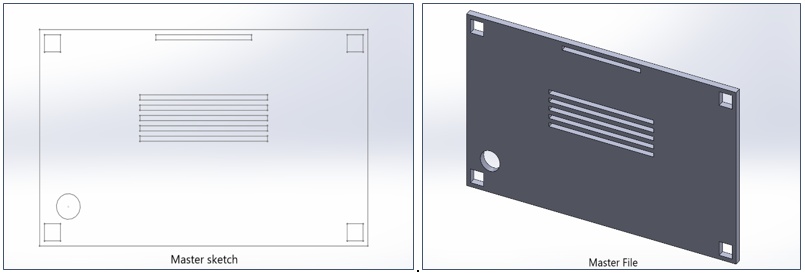

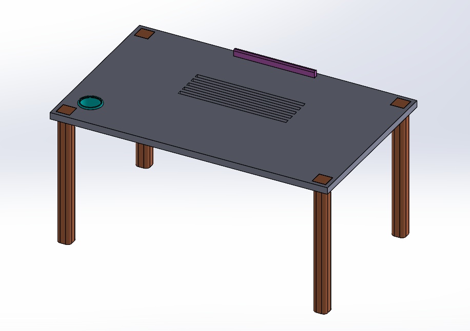

  1. Creating the master sketch & master part file : In this example, we will create an assembly for the table using single sketch which we will call a master sketch. The master sketch contains the rectangular outline along with the profiles which are required to create respective parts. We will extrude the inner contour of the master sketch to construct the rectangular table top with the cut outs to fit the parts. Once finished, this part will serve as the master control file

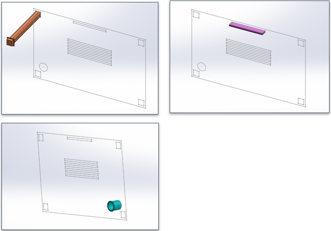

  2. Creating multiple parts from master sketch: In order to control the parts with master sketch, we will need to have a way to link them to the master sketch. This is where the Insert Part command in SOLIDWORKS will come in handy.
    1. Create new part.
    2. Go to Insert > Part > select Master part file
    3. Insert Part PropertyManager > Check the options Absorbed sketches and Unabsorbed sketches.
    4. This will bring master sketch into the new part in its original form. Use this sketch to create the part and do the necessary modifications. Repeat this process for every part. Once the parts are created, we will insert them into a new assembly.
  3. Creating assembly from parts : Now, once we are ready with all the parts we need to create table assembly. Let’s add all these parts into new assembly and create the model for table.

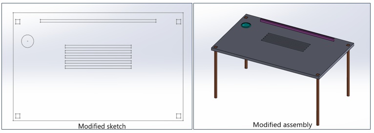

  4. Controlling the parts with the master part Sketch/file: As we have all the parts linked to the master sketch, We can edit the master sketch and make the changes in master file. The part affected by the change will update automatically. As an example I have changed the size and location of the cutouts/profiles in master file. The parts and the assembly are updated automatically.
Note: The mates given in the assembly may require the manual editing for missing references depending upon the change done.

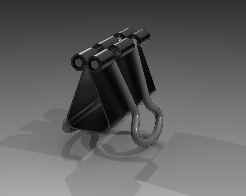

I always have odds and ends sitting on my desk at home and in the office. I picked up a binder clip the other day to see if it was possible to quickly make in SOLIDWORKS. Indeed it was, but then I was set on creating a really cool rendering in SOLIDWORKS Visualize Professional.
In this post, I’ll walk you through creating a custom appearance in SOLIDWORKS Visualize Professional. That’s the main objective of this blog post. I’ll also do a quick camera set up and add a few final touches to achieve the rendering seen below:

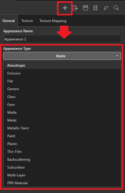

  1. Navigate to the Appearances tab and select the Add button ( ‘+’ ) > New Appearance
  2. When you navigate to the drop down menu for ‘Appearance Type,’ you should have the following options:
  3. Pick any Appearance Type that you desire. As you can see above, I chose a Matte appearance, because I wanted to make my binder clip unique. You can also choose a color as well, by selecting a color in the ‘Color’ box.

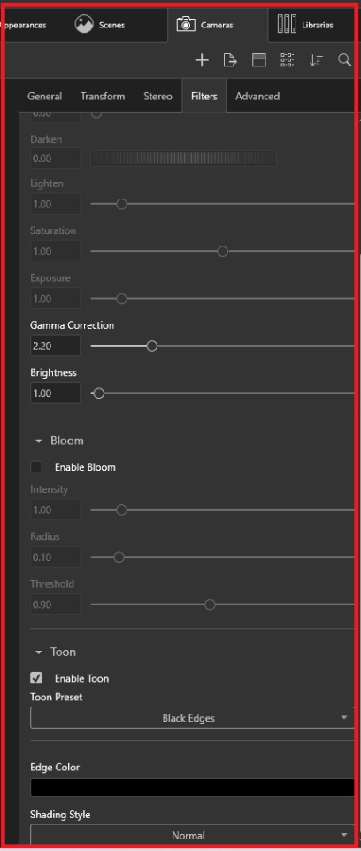

  5. As an added bonus for this post: a little trick I performed for this render was adjusting one of the camera options to create a “cartoon-like” effect.
