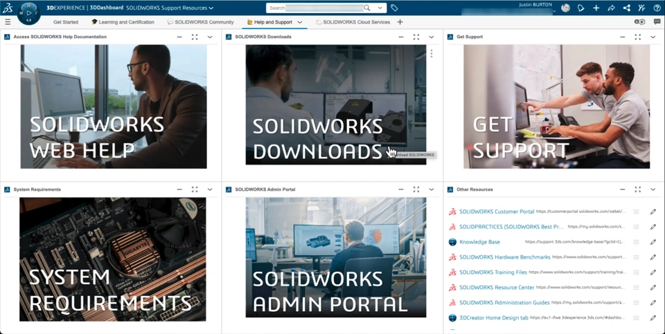

5. ➕ Provide added value by creating your own custom Support and Resources Dashboard
🆕🔥 Make Activation a pre-requisite to providing added value by creating your own custom Support and Resources Dashboard to share support information and access to your valuable onboarding resources.
Support and Resources Dashboard for Your Clients
Creating a support Dashboard can help you make Activation part of your client's onboarding process whilst providing value through the 3DEXPERIENCE platform.
This dashboard can include access to:
  • Your support services via a media link or embedded web page reader
  • Your knowledge base
  • Training content
  • Other partner-provided resources
  • Cloud Services learning and onboarding content
  • And more...
Once you have created a default Support and Resources Dashboard you can create a generic link and then share this with your clients.
We would advise that you use the following app widgets:
  • Web Page Reader - to Embed a website (be sure to double-check how this works for your website before sharing)
  • Media Links - To create thumbnail images that link to resources
  • Quick Links - To display a list of linked resources
  • 3DSwym - To provide direct access to a Community

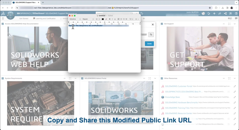

How to share this dashboard with your clients:
Instructions:
  1. Share the Dashboard using the Share icon in the top right
  2. Choose to Share a Copy of the Dashboard
  3. Copy the Generated Public Link URL
  4. Use a Text Editor to remove the Tenant ID from the URL
  5. Share the modified URL
