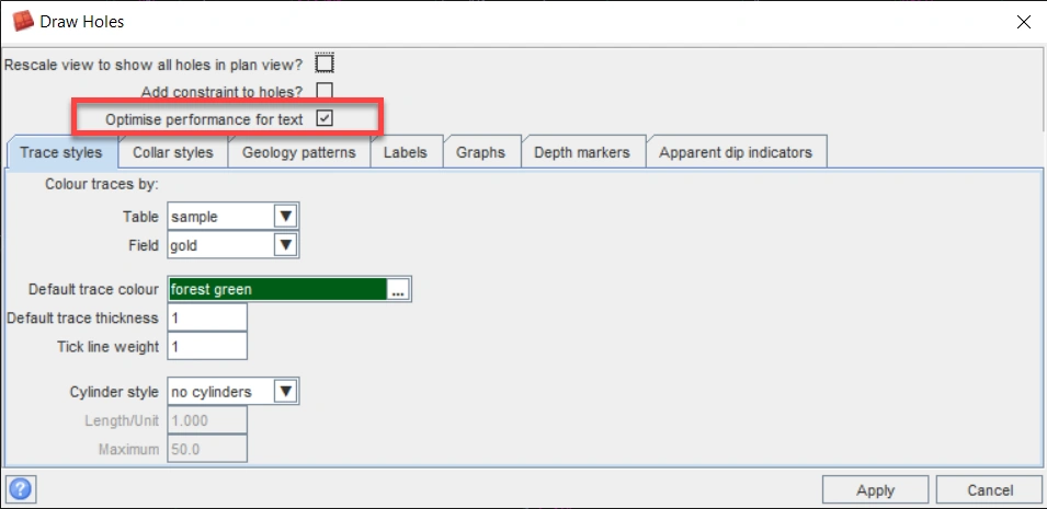

  • Open up the drillhole database and display the drillholes. REMEMBER to tick the box to optimize performance for text if the database is large and text is being displayed.

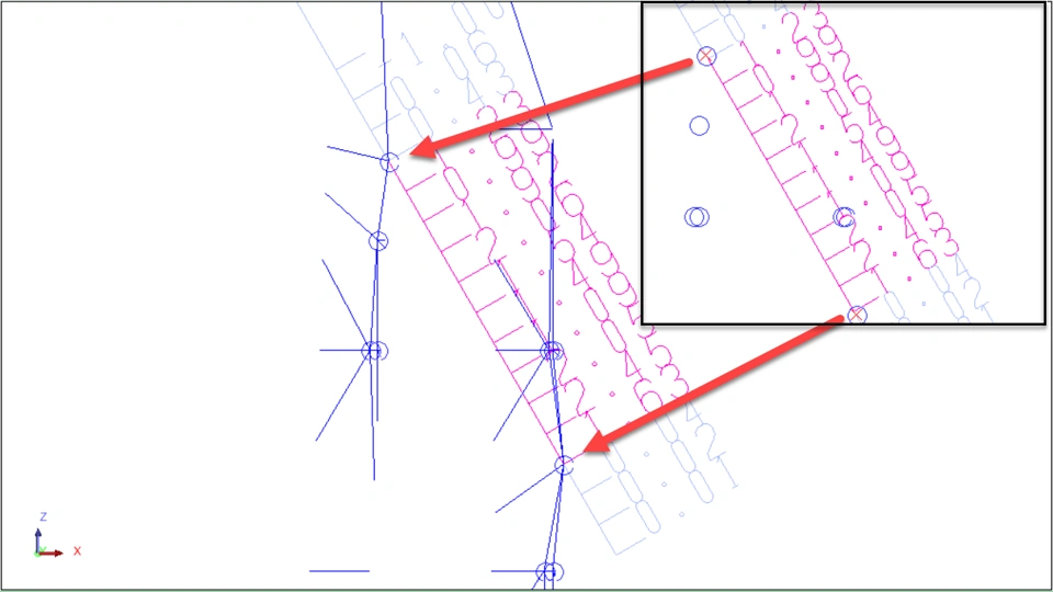

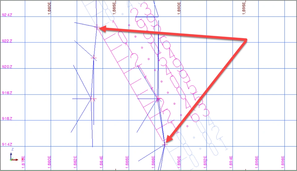

  • When you move through the sections, you may notice that the wireframe is not snapped correctly to the drillhole, but in the third-party software, they were. Remember each third-party software may use a variety of curved trace algorithms, which affects the positioning of the drillholes.

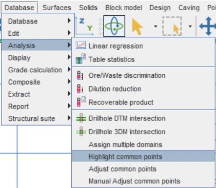

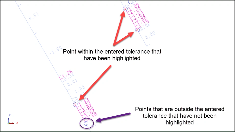

  • Database>Analysis>Highlight common points. This will highlight points that are not snapped correctly to the sample intercept.

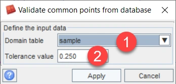

  • The Domain table is the table you want to compare the wireframe to. This would usually be the table that contains the sample/assay values.
  • Tolerance Value is the distance from the snapped string point/wireframe vertex to the assay interval. It is important use a tolerance that will capture the points that are not snapped to the correct sample intercept, otherwise the intercepts will not be highlighted. In this example we used a tolerance of 0.25. If you use Bearing and Distance (BD) to measure the distance between a few points and the assay intervals, read the slope distance you will get an idea of the tolerance distance to use.

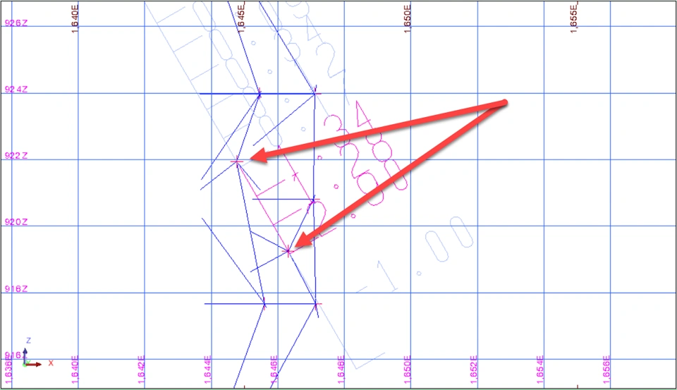

  • Once the function has run, move through the sections to view the wireframe/string points that do not match up with the assay/sample intervals. If the tolerance distance is too small, then they will not be highlighted. Use “Bearing and Distance” to measure the distance between the drillhole and the string point/wireframe vertex. If you have diamond drilling with small intercepts, you may want to run the function in stages.
  • If you notice that valid intercepts are not being picked up, it may indicate that the tolerance distance is too small, and you may need to adjust it accordingly to ensure all relevant points are captured.

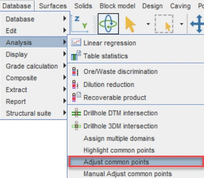

  • Once the highlighted points have been validated, you can then use the “Adjust Common Points” Function. This process adjusts the wireframe so the points are snapped correctly for compositing.
