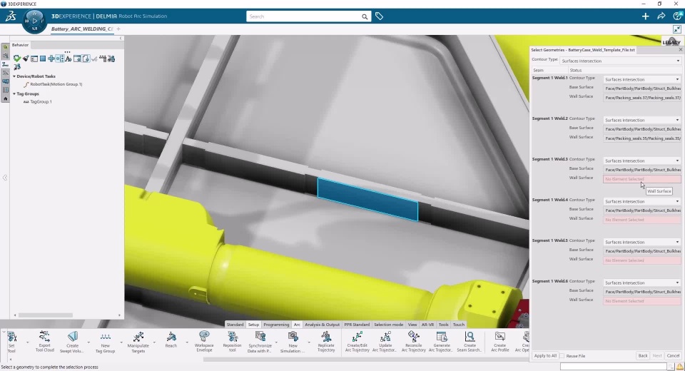

This post is intended to show how you can use the Weld Template System command to capitalize on standard welding applications.
In the video below I explain how you can generate weld programs faster using this template system. In the example we are manufacturing a Battery Module structure for an Electric Vehicle, the structure contains a repeating pattern, so this is an ideal candidate to take advantage of the weld template system command.

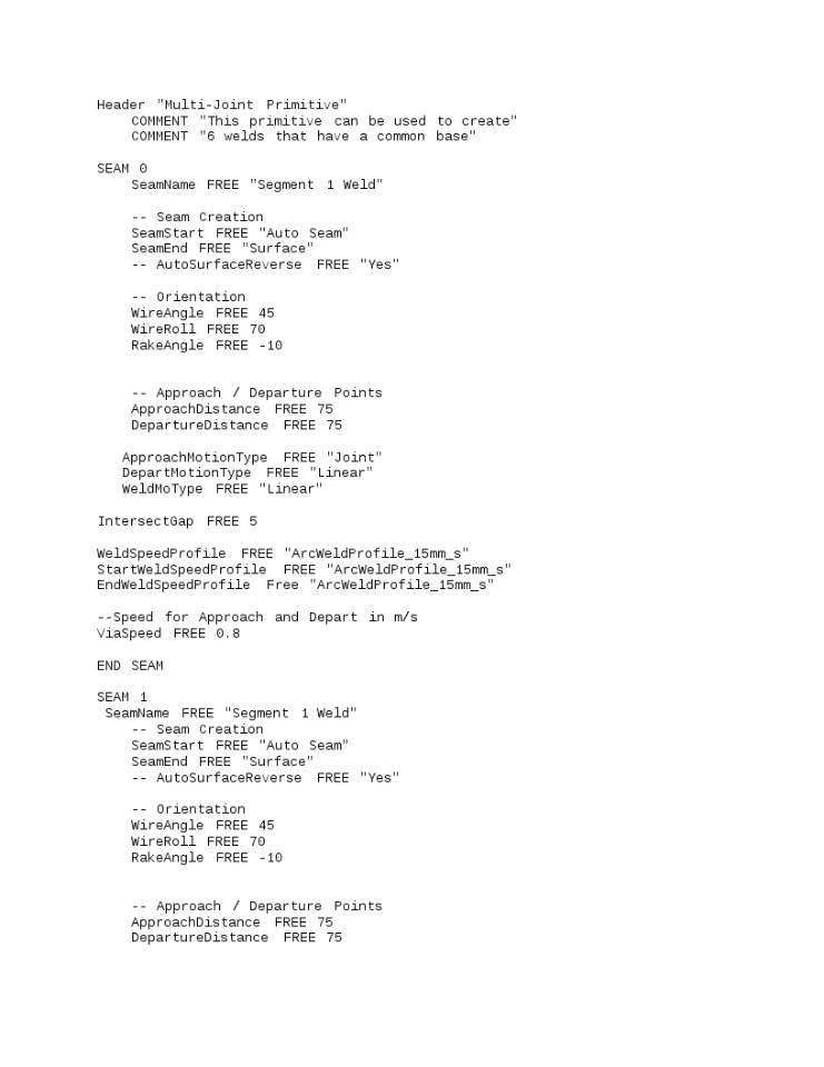

For more information on how to create a weld template primitive file please see the help documentation:
Sample Weld Template File
