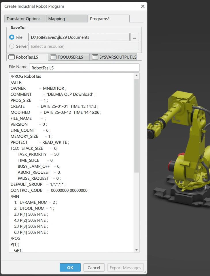

If you have to work with few different versions of 3DEXPERIENCE in one same computer/laptop, don't forget to register the versions you are running to use OLP translators or macros.

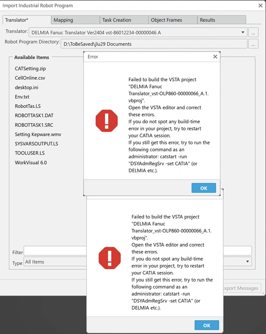

The situation is you were able to download/upload robot programs , but after installed  new 3DEXPERIENCE platform, you cannot download OLP or upload robot backups.   Normally like snapshots:

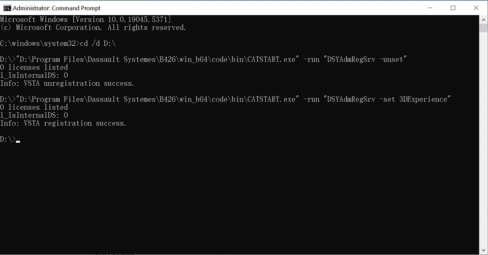

Solve it please follow the steps below :
  1. Run the "cmd"  as administrator
  2. Follow the official instructions:
Run the following command:
"\\win_b64\\code\\bin\\CATSTART.exe" -run "DSYAdmRegSrv -unset"
For example:
"\\win_b64\\code\\bin\\CATSTART.exe" -run "DSYAdmRegSrv -set 3DExperience"
For example:
INFO: VSTA registration success.
Please refer to my example:
3. Enjoy it, have a fun!
