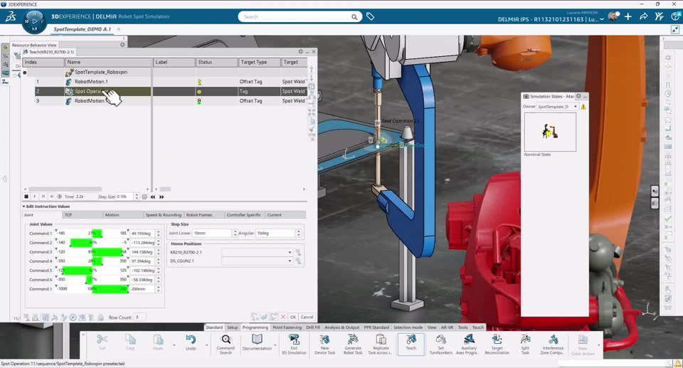

How to: DELMIA Robotics - Spot Task Templates
Below is a voice over video explaining how to use Spot Task Templates to apply templates to each spot operation as you generate a task. In the example below a customer asked how we could simulate the "robospin" action that Kuka robots employ for Aluminum spot welding. The robot spins about the TCP after each spot move.
