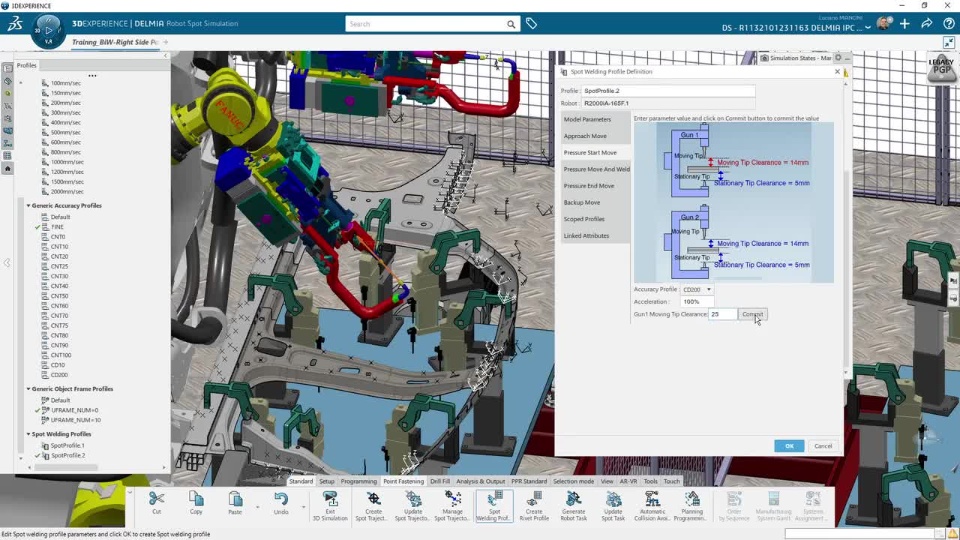

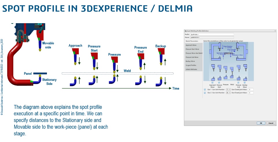

Hello in this post you will see how Spot Welding is handled in DELMIA Robotics, more specifically how to properly set Spot Profile parameters, create Applicative profiles and link them to Spot profiles for FANUC. Also how to generate these profiles based on an upload from the shop floor.
The video (voice over) below explains how to correctly create and set a Spot Profile:

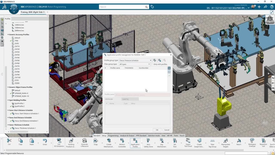

The video (voice over) below explains how to correctly create applicative profiles and linked them to a Spot Profile (FANUC Example):

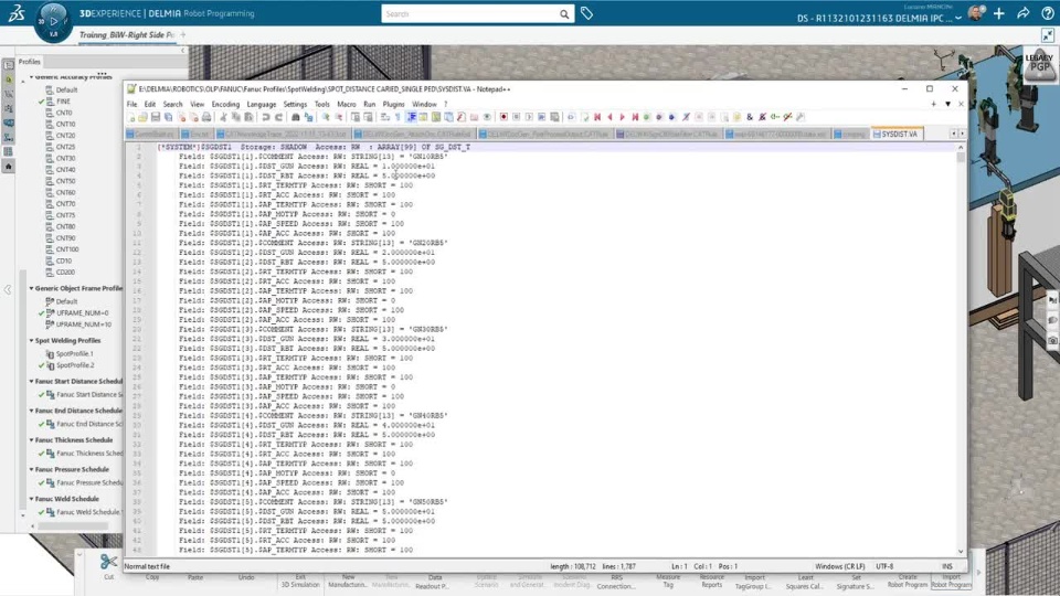

The video (voice over) below explains how to generate Spot Profiles and Applicative profiles based on an upload from the shop floor.
