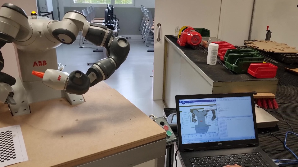

Development of a digital twin
As you know, many people do not distinguish between "digital twin" and digital model (or 3D model)
We do believe that we can only talk of a digital twin when there is an exchange of data between the virtual and real model and some common states.
It is in this context that we use 3DEXPERIENCE to create the digital twin of the ABB cobot "YuMi".We are currently looking at how to improve the transmission in order to make it real time.
What do you think about it ?
