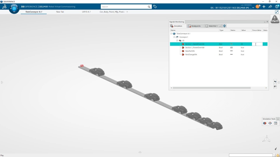

With DELMIA Virtual Commissioning, is is possible to simulate realistic conveyor behavior, thanks to capabilities that allows to:
- Create, Transform & Delete volatile product instances based on Manufacturing Products
- Manage the Creation / Transformation / Deletion activation using variables
- Manage the Conveyor Speed and Start & Stop using Inputs
These new capabilities make it possible to run a simulation in loop, and simulate some "what-if" scenarios that can happen on a line: Speed reduction, Emergency Stop …
Since the release of 3DExperience 23x, the conveyors are managed in a new way, which is much easier and realistic than before.
Once the conveyor is defined, it is possible to activate Simulation variables to manage its Speed and Power (Start & Stop)
