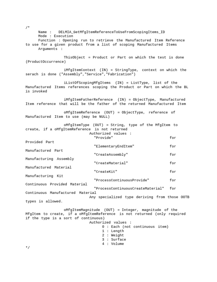

Using this BL we can retrieve the Item reference to use for a given product.

DELMIA_GetMfgItemReferenceToUseFromScopingItems.CATRule

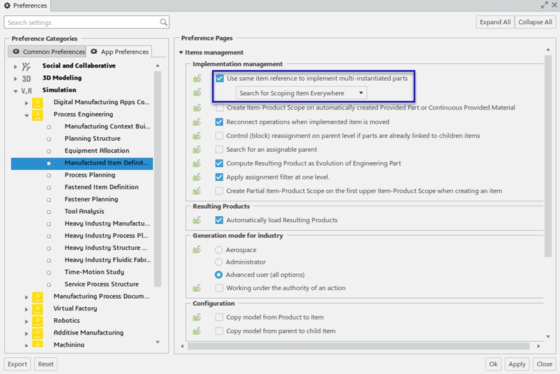

Following preference setting (use same item reference to implement multi-instantiated parts) is required to check for this BL to get invoked. If it is unchecked, the BL won’t get invoked.
No Reuse:
When the “Use same manufactured item reference to implement multi- instantiated parts” is NOT checked, a NEW Mfg. Item Reference gets created to implement an Eng. Item and no already scoped items are reused. The Business Rule is not invoked in this case.
Reuse:
The existing Mfg. Item Reference object is used for each Instance you create.

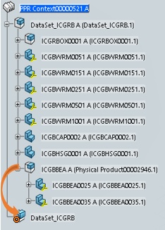

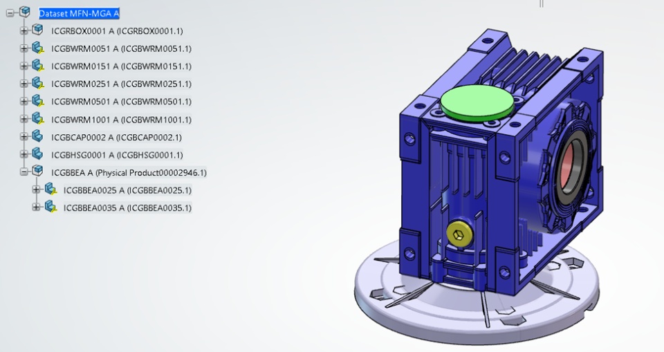

Consider an EBOM structure for Gearbox as shown below.

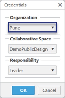

Let’s change the current organization to Pune.

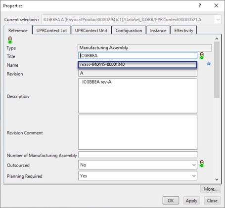

Now let’s create a MBOM structure for bearing assembly in above EBOM structure. A manufacturing assembly ‘ICGBBEA A’ implementing the bearing assembly is created in ‘Pune’ organization.

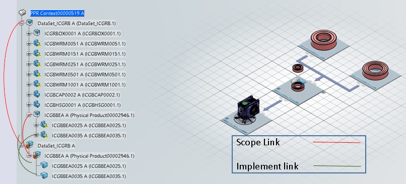

Scenario 1

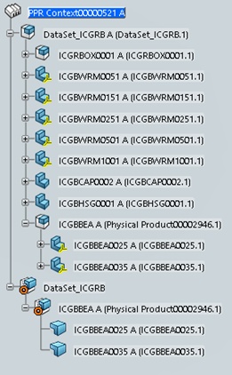

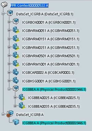

Now in ‘Pune’ organization let’s try to create another MBOM structure implementing the same bearing assembly. Let’s drag and drop the bearing assembly on the new MBOM root node.
In default case (without reuse) it should create a new Provided part on drag and drop of any product.
We can see that the earlier created Manufacturing assembly scoped with Bearing Assembly is reused here. Note that both the current organization and organization of existing scoped Manufacturing assembly is same and that is Pune here.

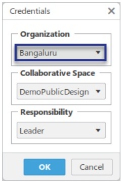

Now let’s change the organization to Bengaluru.
Now in ‘Bangaluru’ organization let’s try to create another MBOM structure implementing the same bearing assembly. Let’s drag and drop the bearing assembly on the new MBOM root node.
We can see that a new provided part is created to implement the bearing assembly. This is default OOTB behavior.
 Note that the current organization (Pune) and organization of existing scoped Manufacturing assembly (Bangaluru) are different here. This does not allow the reuse in the above Business Rule.

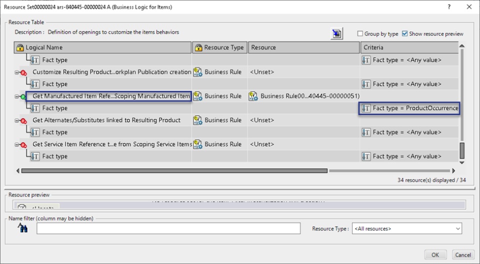

Business Rule Deployment
The below page can be referred for Business Rule deployment.
How to Deploy Business Rule
For deployment using Data Setup app following Resource set and Opening needs to be used
Resource Set:
Opening:
