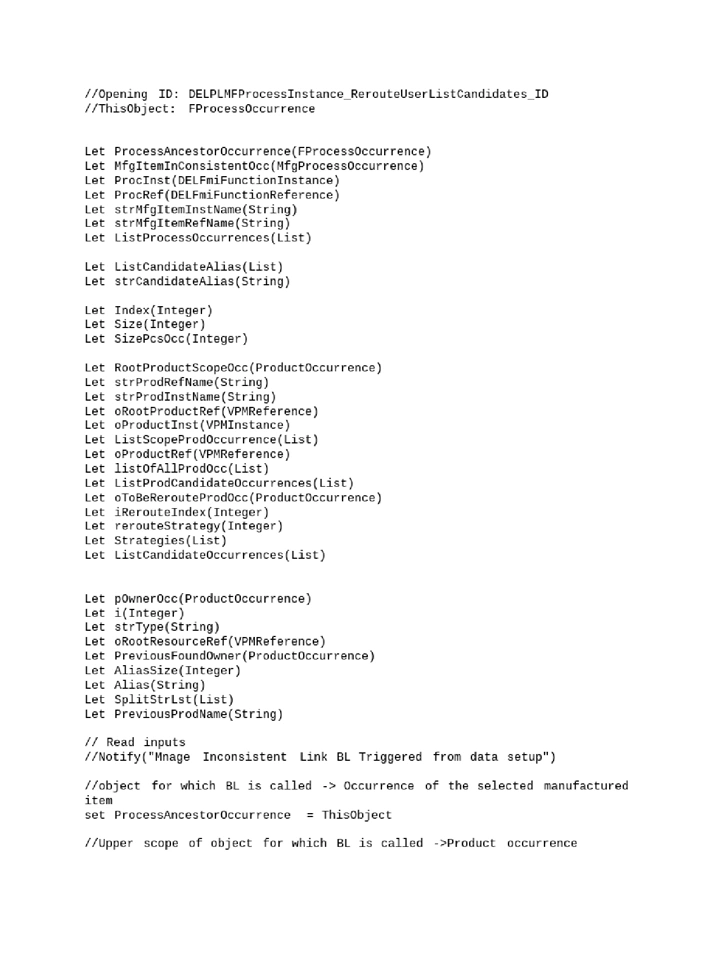

Sample Script
Sample Script
Working of the Business Logic
Get first upper scoped Physical Product
//Upper scope of object for which BL is called ->Product occurrence
set RootProductScopeOcc=Parameters->GetAttributeObject("iFirstScopeAncestor")
Get list of Mfg. Items Bearing the Inconsistent Implement Links
//List Occurrence ->List of the manufactured item occurrences holding the inconsistent link
set ListProcessOccurrences=Parameters->GetAttributeObject("iListOccurrence")
set SizePcsOcc = ListProcessOccurrences.Size()
Trace(1 , "SizePcsOcc : #", SizePcsOcc)
Get list of paths of the previously linked Physical Product Instances
//ListCandidateAlias -> List of the product alias (string) stored in the link, i.e., the old implemented products. This alias contains the retrieved path.
set ListCandidateAlias = Parameters->GetAttributeObject("iListCandidateAlias")
set AliasSize = ListCandidateAlias.Size()
Trace(1 , "ListCandidateAlias : #", AliasSize)
Get children of Fist Upper Scoped Physical Product
//Get all products under the first upper scoped Physical Product
listOfAllProdOcc = RootProductScopeOcc->Query("ProductOccurrence", "")
set Size = listOfAllProdOcc.Size()
Trace(1 , "listOfAllProdOcc Size : #", Size)
This script processes each manufacturing item from the list that contains Mfg. Items bearing the inconsistent links and retrieves the path of their corresponding previously linked physical product instance. Subsequently, it utilizes the instance name obtained from the path of the previously linked physical product instance to search for the product instance within the list of children of the first upper-scoped product. The product that corresponds to the name of the previously linked product instance is then recommended for rerouting.
Here, the 1st Element in the list "ListCandidateAlias" corresponds to the path of the previously linked Product Instance on the 1st Mfg. Item in the List "ListProcessOccurrences" and so on. Therefore, they need to be accessed simultaneously in the loop.
for Index = 1 while Index <= SizePcsOcc
    iRerouteIndex = Index
    MfgItemInConsistentOcc = ListProcessOccurrences->GetItem(iRerouteIndex) //Get Mfg. Item bearing the Inconsistent Implement Link
    set Alias = ListCandidateAlias->GetItem(iRerouteIndex)  //Get the Alias or Path of the previously linked Product Instance
    set SplitStrLst = SplitString(Alias, "/") //split the path at "/"
    Set PreviousProdName = SplitStrLst->GetItem(SplitStrLst.Size()) //Get name of instance from the list
    SplitStrLst.RemoveAll() //empty the list
    if(MfgItemInConsistentOcc <> NULL)
        set ProcInst = MfgItemInConsistentOcc.Instance //Get Mfg. Item Instance
        set ProcRef = MfgItemInConsistentOcc.Reference //Get Mfg. Item Reference
        if(ProcInst <> NULL and ProcRef <> NULL)
            set strMfgItemInstName = ProcInst.PLM_ExternalID  //Get Mfg. Item Instance Name
            Trace(1 , "Inconsistent Mfg item instance : ", strMfgItemInstName)
            set strMfgItemRefName = ProcRef.V_Name //Get Mfg. Item Ref. Title
            Trace(1 , "Inconsistent Mfg item Reference : ", strMfgItemRefName)
            for oToBeRerouteProdOcc inside listOfAllProdOcc
                set oProductInst = oToBeRerouteProdOcc.Instance //Get product instance
                set oProductRef = oToBeRerouteProdOcc.Reference //Get Product Reference
                if(oProductInst <> NULL and oProductRef <> NULL)
                    set strProdInstName = oProductInst.PLM_ExternalID //Get product instance name
                    Trace(1 , "Product instance Name: ", strProdInstName)
                    //if(strMfgItemInstName == strProdInstName)
                    if(PreviousProdName == strProdInstName)
                        Trace(1 , "Reroute mapping found")
                        ListCandidateOccurrences->SetItem(oToBeRerouteProdOcc,iRerouteIndex) //Set the product to be rerouted on current item
                        rerouteStrategy = 1 //reroute
                        Strategies->SetItem(rerouteStrategy,iRerouteIndex) //Set strategy to Reroute
Update the list of Parameters
// Set output parameters
Parameters.SetAttributeObject ("oCandidateOccurrences",ListCandidateOccurrences)
Parameters.SetAttributeObject ("oListStrategies",Strategies)
