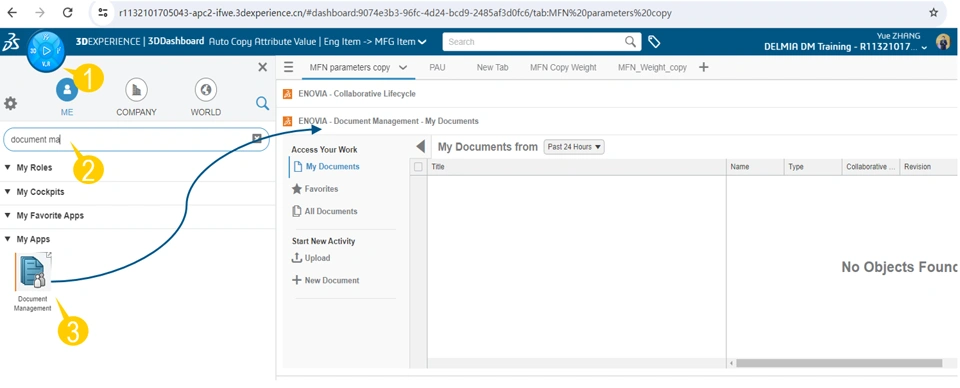

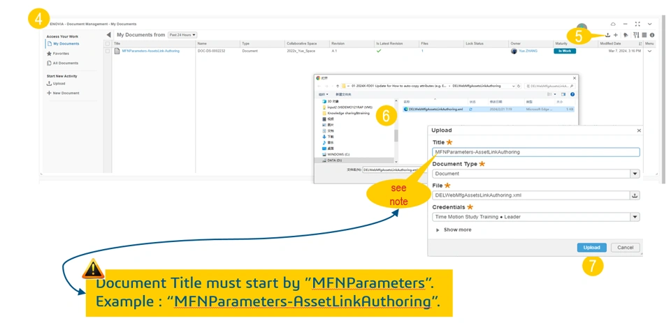

1. Utilize ENOVIA Document Management as the container of customized files.

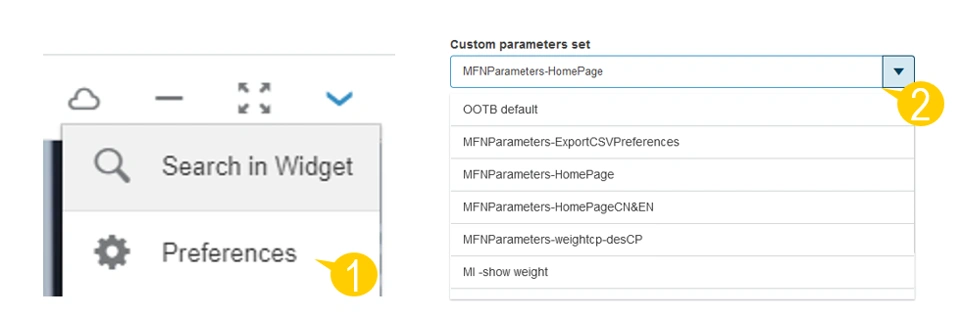

2. Utilize the parameter set within the MFN Preferences to pick the customized file that you uploaded.

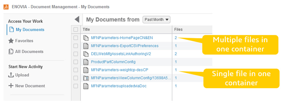

When there are multiple customized files that require being utilized simultaneously, you can upload multiple files to one via the Document Management, and then select your container name in the MFN preferences to attain your objective.
You can utilize Document Management to contain multiple files in one container by right-clicking on the single file to upload files, and below presents the following multi-file and single-file containers.
Then in the custom parameters setup of MFN preferences, you can choose the container name such as the above one, which can be "MFNParameters-HomePageCn&En", for using both the two custom files in it.
