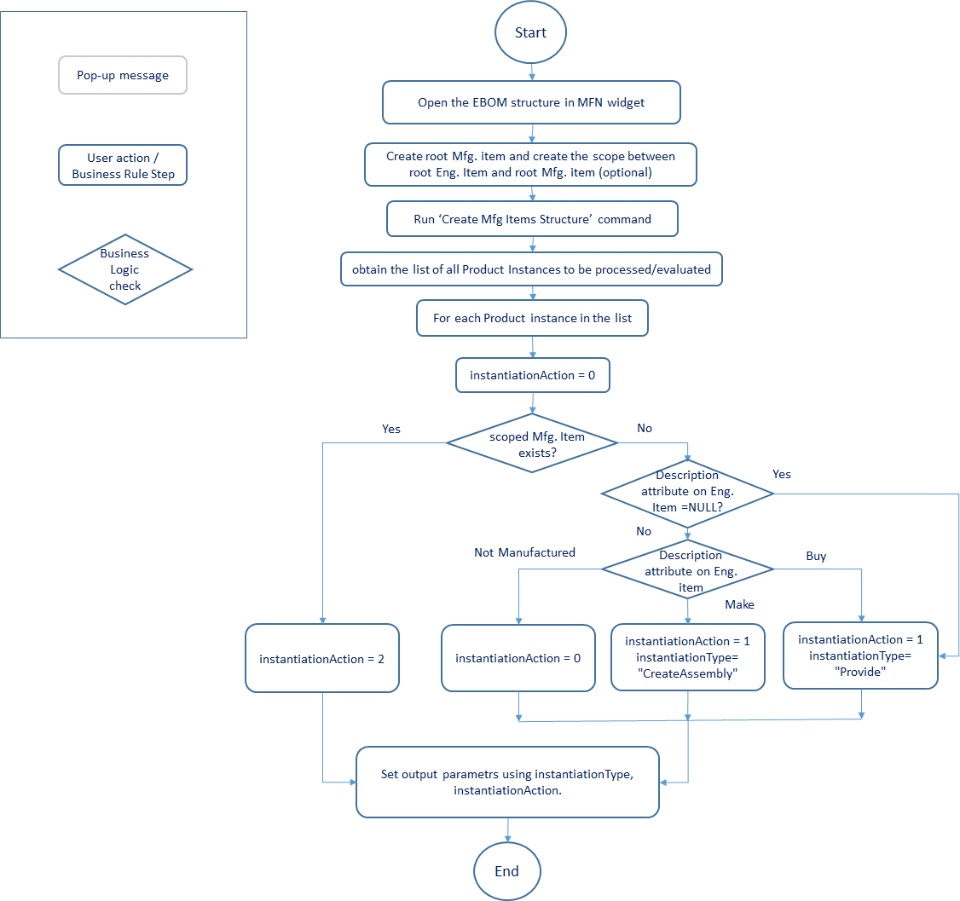

Logical Flow
Example Business Rule

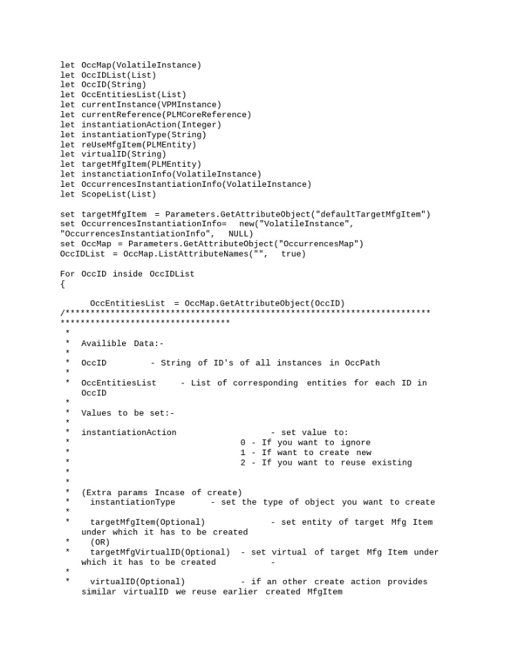

First of all we check if we have any existing scoped items for the Eng. Item.
Logic to check if any scoped Mfg. Item exists
ScopeList = GetProcessScopesFromProduct(currentReference)
If the scoped Mfg. item exists then we can reuse that Mfg. item.
Logic to ‘reuse’ the existing Mfg. Item if scope link exists.
if(ScopeList.Size() <> 0)
      set instantiationAction = 2
      set reUseMfgItem = ScopeList.GetItem(1)
Here simply the first item in the scoped Mfg. items list is considered for reuse. We can select any particular item from the list which is matching a certain criterion according to the requirement.
If no scope links exist, ‘create a new Mfg. Assembly/ Provided Part or ignore’ based on the Make/Buy input. According to the Make/Buy value the MBOM structure will be generated.
Logic to create the MBOM structure based on Make/Buy value
if (  0 <= currentReference.V_description->Search("Not Manufactured") )
     set instantiationAction = 0
else if(0 <= currentReference.V_description->Search("Make") )
      set instantiationAction = 1
      set instantiationType= "DELAsmAssemblyModelDisciplines/CreateAssembly"
      set virtualID = "EKLVirtual" + currentReference.PLM_ExternalID
else if (0 <= currentReference.V_description->Search("Buy") )
      set instantiationType= "DELAsmAssemblyModelDisciplines/Provide"
InstantiationAction:
  1. 0 - If you want to ignore
  2. 1 - If want to create new Mfg. item
  3. 2 - If you want to reuse existing Mfg. item
Here Description attribute on Eng. Item is used to take Make/ Buy input. We can use any OOTB/ custom attribute as per the requirement.

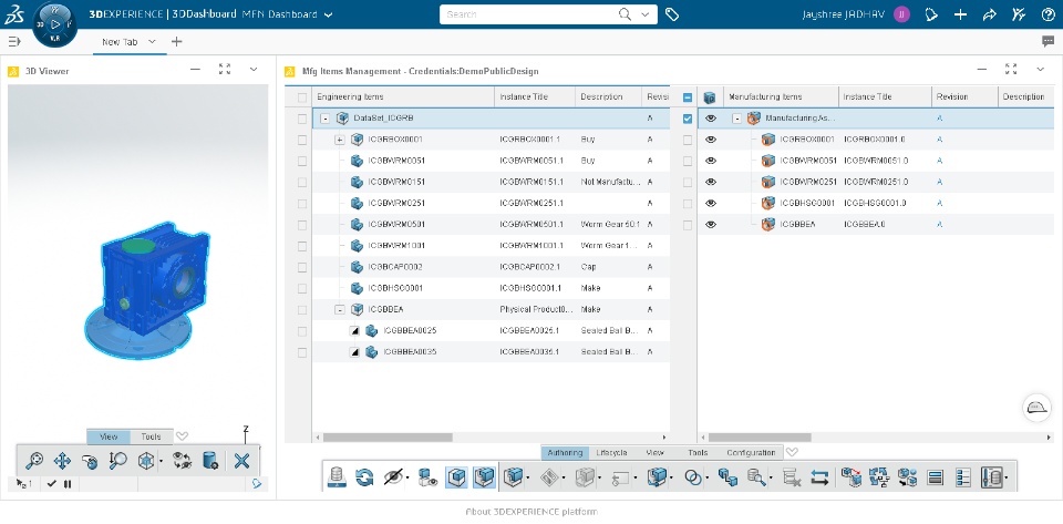

Scenario

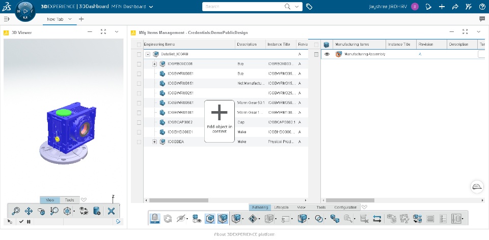

Consider an EBOM structure for Gearbox assembly as shown in below image.
Let’s create a MBOM structure for the Gearbox assembly.
In below image we can see a root Mfg. assembly is created and it is scoped with the root Eng. Item in EBOM structure.

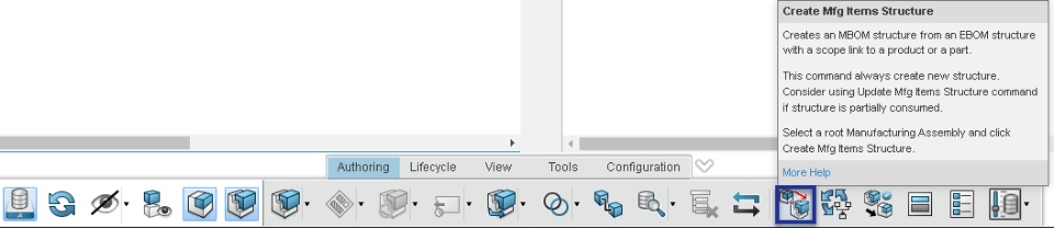

Now let’s run the ‘Create Mfg Items Structure’ command from the Authoring section.
Here we can see the resulting MBOM structure in below image.
We can see that the ‘provide’ is created for ICGRBOX0001 because the Description attribute contains string ‘Buy’. For part ICGBHSG0001 the Description attribute contains string ‘Make’ hence Mfg. assembly is created for it.
Similarly depending on the Description attribute value the Mfg. items are created for corresponding Eng. Items and reused if scoped item exists.

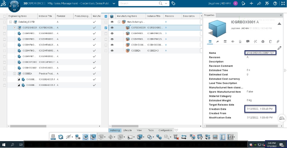

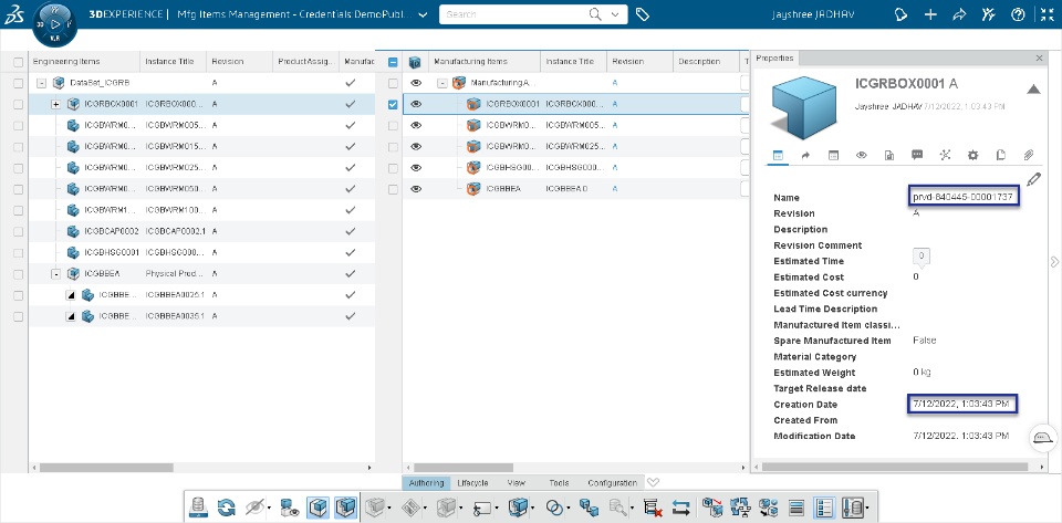

Reuse:
If we detach the MBOM structure under the root MBOM and then re-run the ‘Create Mfg Items Structure’ command then the following structure will be created.
This MBOM structure reuses the Mfg. items created initially. We can see that the Name for Mfg. item ICGRBOX0001 is same as the Mfg. item created for ICGRBOX0001 initially. Please refer the below image.
In similar way the other existing Mfg. items (created initially) are reused here.
We can see that the Creation time differs from the current time. This means the existing scoped Mfg. item reference is reused here.

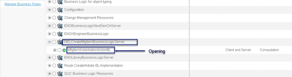

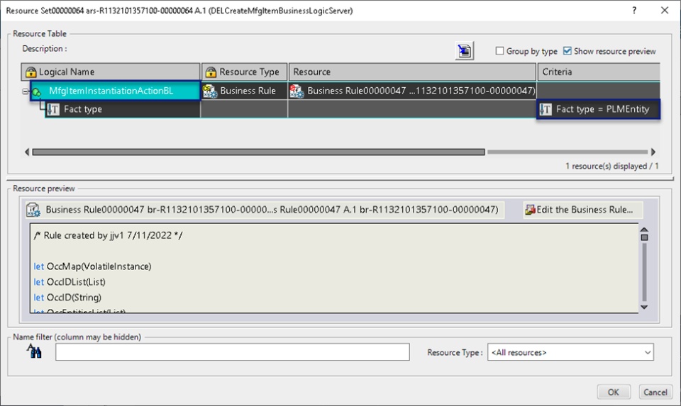

Business Rule Deployment
On Premise:
The below page can be referred for Business Rule deployment using Data Model Customization app (TXO).
Business Rule Deployment using Data Model Customization App

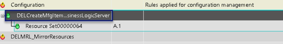

Resource Set and opening:
On Cloud:
The below page can be referred for Business Rule deployment using Data Setup app.
Business Rule Deployment using Data Setup App
Resource Set:
Opening:
When you create your Business Rule using the Data Setup App you must specify "Server-only" for the scope of this Business Rule.
We cannot change the scope of the business rule once it is created.
