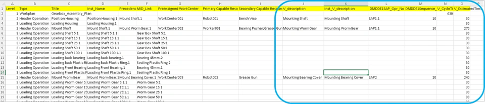

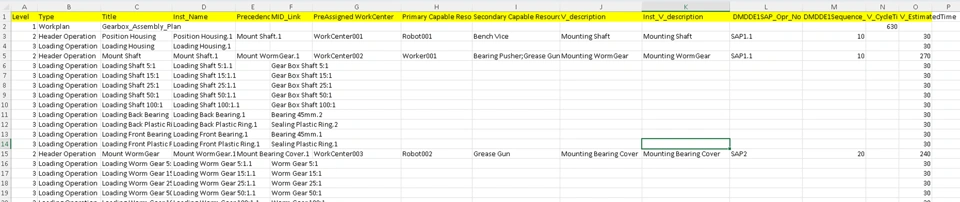

The template excel format is as shows below:
The 1st 9 columns are reserved and necessary to be added.  Their description is as given below:
Column Title Significance
Level
Defines level of object inside structure,
1 – Root
2 – First level child of root or child of level 1.
3 – Second level child of root or child of level 2.
N – Child of level N – 1.
Type
Type of object to create
In the provided EKL Script "new()" function is used to create objects based upon the OOTB object's type name.
 The following OOTB Processes and Operation objects can be created using the "new()" function:

Preassigned Work Center Work Center to be assigned to a particular header operation.
Primary Capable Resource Mention the Primary Capable Resource for the Header Operation (Only 1 resource is allowed)
Secondary Capable Resource Mention the Secondary Capable Resource to be assigned to the Primary Capable Resource. Multiple resources can be assigned and must be seperated by a ";" (Only for Header Operations)
Note: If instance attributes value needs to be set then add “Inst_” keyword before attribute name. For example for instance description, it will be “Inst_V_description”

How to set additional attribute and other custom attributes:
To set other extra attributes of the created objects, add extra columns in the excel file after column 9. 1st 9 columns are reserved for Level, Object type, Title(Reference Name), Instance name, Precedence link, MID Link, Preassigned WorkCenter, Primary and Secondary Capable Resource. While creating the column, column name should be the attribute name. Add the values in respective rows. While setting the column name for attribute of instance object, add “Inst_” as a prefix in the column name.
The EKL script manages to set the additional attributes if they are specified in the excel file. The condition is, the attribute should be available on the object. User can specify custom attributes also if available.
For example: Additional attributes to be set are highlighted in blue box.
The code between below comment lines in attached EKL script is responsible for setting additional and custom attributes. It set both reference and instance object attributes.
//Logic to read remaining columns and set additional attributes
//End of for loop to set Additional Attributes

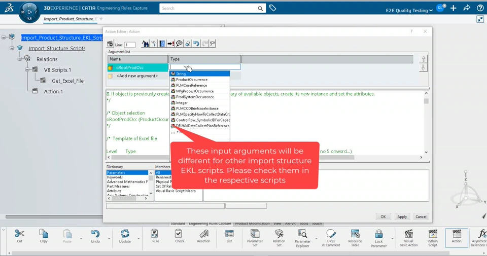

How to Deploy
This video describes: How to deploy the "Import Product Structure from Excel?" EKL Script. However, the process is same for following EKL Scripts:
   1. Import Resource Structure from Excel
   2. Import Mfg. Item Structure from Excel
   3. Import System Structure from Excel
(Note:
1. Instead of creating a separate Physical Product for containing each script, you can create the action files for the above three EKL scripts in the same Physical Product that we are going to create for "Import Product Structure from Excel" EKL Script.
2. The Excel File Selector VBScript is same for all the above EKL Scripts. So, you can create it only once and use it in all the above EKL Scripts.
3. The input arguments are different for different type of structure script. The information is provided in the respective EKL script as a comment at the top section.​​​​​​​​​​​​​​
