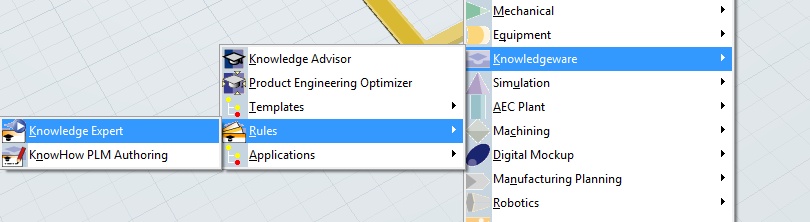

The Report Template Creation launched from a command in Knowledgeware/Rules/Knowledge Expert Workbench.

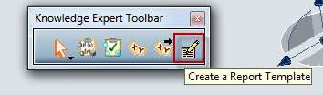

Just call the command Create a Report Template.

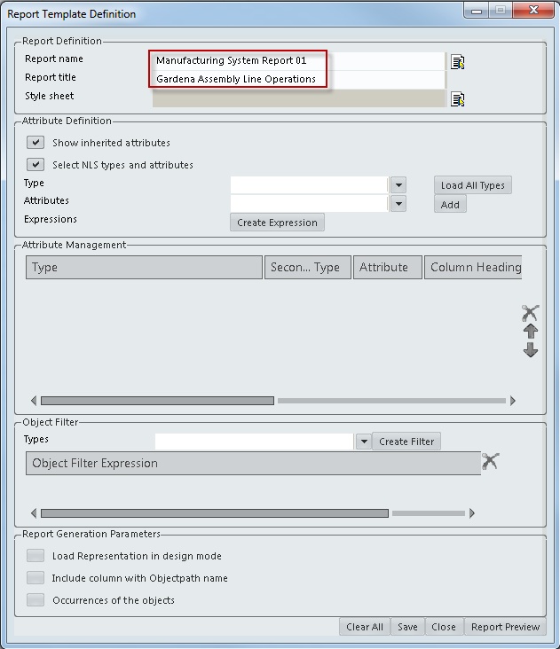

This opens the Report Template Definition dialog
In the Report Definition frame, you have to provide a Report Name. This is the (unique) name of the Report document that is stored in the V6 database. You also have to provide a Report Title. This title appears as a header in the report created by the user. In this example, we use a standard Style Sheet that comes with the installation. Just leave the field blank(!) as it is.
In the Attribute Definition frame, you select the type(s) and the attributes to report. Theoretically its possible to have a single table report on multiple object types, but I would recommend to you not to mix types, because this can lead to strange results. The first thing you should do: Click the Load All Types button to make sure that all selectable types are actually available in the drop down list.
The next step is to select the Type to report from the drop down list. Depending on this selection, the Attribute drop down list is filled. In this first example we don't use Expression, please ignore. In the test example, we would like to report the so-called "Loading Operations" under a certain "Production System". The type to select is "PLM Production Loading Operation Reference". From the attribute list, we select the attribute "Name" (this is the NLS translation of the attribute "PLM_ExternalID", which is available on all PLM objects). Then press the Add button.
Once you have pressed the Add button, a new line is added to the Attributes Management frame
Then we add another attribute "Estimated" Time. The result should look like the following screenshot:
We are done with the attributes definition. Using the buttons on the right, you can remove rows as well as change the order of rows here (this translates into column order in the final report).
We will not specify an Object Filter in this example. Actually it is possible to filter the result list based on e.g. an attribute value/range.
Then, please make the following settings in the Report Generation Parameters (uncheck all options if checked). I am not going to explain here what it means.
Last but not least, we Save and Close the report template definition. Caution: The button Report Preview does often not work depending on the workshop and the UI activated object!
