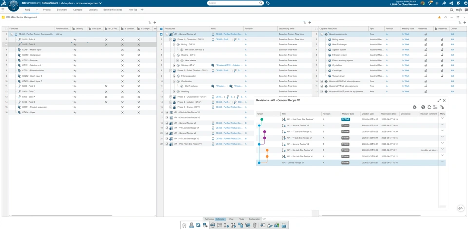

How to go from a General Recipe to a Master Recipe
A key capability defined by ISA-88 is the ability to structure recipes hierarchically, where each level is derived from the one above. For example, a site recipe is derived from a general recipe and a master recipe is derived from a site recipe.
From General Recipe to Site Recipe
- Branch the full General Recipe process structure from Header Workplan to the last level of General Operations down to Work Instructions, rename the Ttile as (Site_Recipe_ProductXXX).
- While branching the process, select also all Continuous Manufactured Materials, Continuous In-Process Materials, Phases and Continous By-Product without the Continuous provided materials (as they will be replaced by local materials)
- While branching the process, select also the scoped "Capable Resource Structure" node without the Continuous provided materials (as they will be replaced by Site Representative resources).
- Replace the General provided materials with the Site Specific Materials (create any to be qualified if necessary) that are referenced in classification and can be dragged & dropped from IP Classify & Reuse
- Replace the General Resources with Representative site equipment that are referenced in Classification.
From Site Recipe to Master Recipe
- Branch the full Site Recipe process structure from Header Workplan to General Operations down to Work Instructions, rename the Ttile as (Master_Recipe_ProductXXX).
- Replace Site Representative equipment with real serialized equipment that are referenced in Classification and/or modeled in an Asset Structure.
Remarks:
- Branching Processes + Resources + Materials can be done in RME through the auxiliar view, users can drag & drop the given objects in the auxiliar view, multi select them and execute the branching actions. This would keep the Implement and capable resource links between the different objects.
- For additional clarity, the customer can add an additional custom attribute per Recipe Type with a combo list (General, Site & Master) that can be filtered through a 6WTag.
- Starting 27xFD02, it will be possible to define "Originate links" between Header Workplans, that could be a more flexible solutions to manage links between General, Site and Master types of recipes but without further possibilities to do change impact assessment that could be envisioned through branching.
- Relations between branched recipes can be visualised through the "Revision" command in the Lifecycle Tab from the toolbar in Recipe Management:

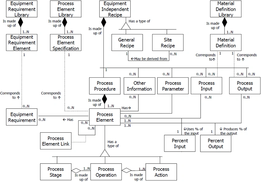

The recipe structure
Process & Procedural Structure
Definition
The general and site recipe procedures are structured using the levels described in the process model which allows the process to be described in non-equipment specific terms.
The master and control recipe procedures are structured using the levels described in the procedural control model, the elements of which have a relationship to serialized equipment.
Process Model

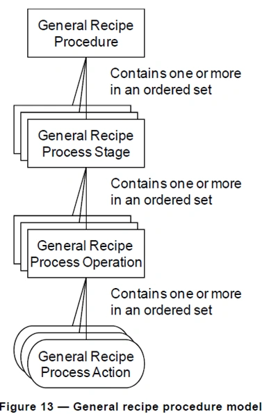

ISA-88 requires that a batch process is broken down into 4 well-defined levels through the Process Model for General and Site Recipes which correspond to the functionality of the analogous levels :
- Process: Produce Antibody Drug Conjugate
- Process Stage: Conjugation
- Process Operation: Reaction
- Process Action: Add linker
This gives a clear, structured decomposition of the recipe. A "Mixing Process" may include a process stage like "Add Ingredients" with Process Operations like "Dose Solvent" and process actions like "Open Valve".
In general, there is a 1:1 correspondence between the process stages, operations and actions in a general recipe and in a site recipe except that the site recipe stages, operations and actions can be made site-specific.

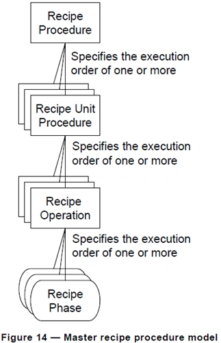

Procedural model

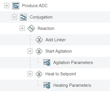

The ISA 88 introduces another model, the procedural model that goes a bit deeper as the phases are representing process parameters that are going to be executed with the target vale setpoint of machines, collected target value, ranges, criticality, units and dimensions. This model is mainly use to model Master Recipes and is made up of ordered sets of recipe unit procedures, operations and phases, using the Procedural Control Model.
- Procedure: Produce ADC
- Unit Procedure: Conjugation
- Operation: Reaction
- Phase: Add Linker

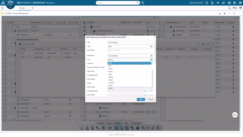

- Parameters: Quantity
- Phase: Start Agitation
- Parameters: SET 200 rpm
- Phase: Heat to Setpoint
- Parameters: SET 20°C / GET pH 7.2 (7.1/7.3)
- Phase: Add Linker
DELMIA Data Model allows to model the Procedural Model with the following objects:
- Procedure: Header Workplan
- Unit Procedure: Workplan (APRISO: Process / BIOVIA_ENOVIA: Phase)
- Operation: Header Operation (APRISO: Operation)
- Phase: General Operation (APRISO: Step)
- Parameters: DCP / RPP rows (APRISO: Activity)
Remarks:
- ISA-88 is using the name of "Phase" for the last level of the procedural model level, in the 3DEPXPERIENCE platform, Phase is used by BIOVIA Formulation Design and XSR Specification Management to represent the second and last level of their process structure level (first one being the Procedure reflecting the manufacturing of a given product and second one being the phase, example: "Mixing" can be a "Phase"). Phase is also used as a Formula Item object in RME that can be scoped to Header Worplans or Workplans, it represents a grouping of Continuous Provided Material.

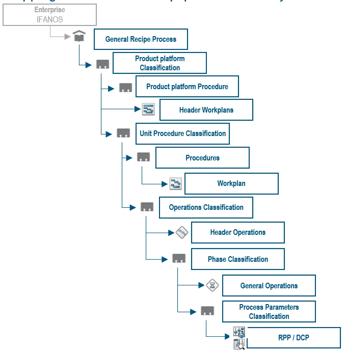

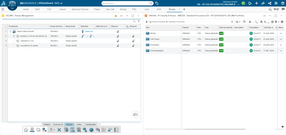

Enable Process Reusability
ISA-88 promotes building processes from reusable elements, standard phases (heating, mixing) and standard operations instead of redefining everything each time.
All process objects are referenced in the 3DSPACE and therefore be found and reassigned where needed through search for example.
Admins can also define Libraries, through IP classification editor for process reusability, defined through Procedure/Unit Procedure/phases/operations, here is a best practice proposal:
Users can then navigate and reuse process objects along the recipe definition process through drag-and-drop Procedural Objects.

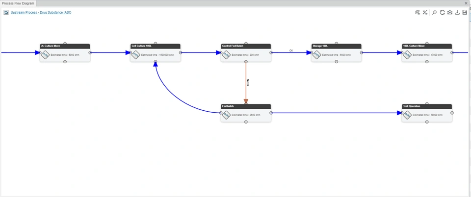

ISA-88 requires defining how process operations are sequenced and connected. Each step follows a clear order, with transitions and conditions (if/then logic) determining when to move to the next step, ensuring a consistent and controlled process flow.
The Process Flow Diagram / Pert Chart available in Recipe Management allows to define product flow links between process objects of the same types (Wokplans/Header Operations & General Operations) under the same parent with specific types of flows / conditions (Alternate / Scrap / Good / Failed).
It enables the implementation of conditional logic, which is required when process steps depend on real-time conditions rather than a fixed sequence. For example, in a fed-batch process, buffer (a raw material) must be added each time the pH exceeds a defined threshold. Since the timing and frequency of these additions cannot be predetermined, the process must continuously evaluate the pH and trigger the addition only when the condition is met.
It also supports parallel operations, allowing different product flows and quantity splits.

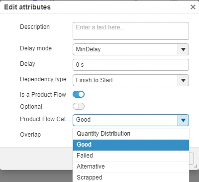

User has to select the "Sequencing mode" of the parent operations from which he wants to create links between as "Based on Product Flow" (this mode sequences child operations dynamically, based on explicit product flow connections defined between operations with conditional logic, parralel flows, quantity splits or time constraints) vs "Based on Tree order" (this mode sequences child operations statically, following their hierarchical order in the process tree. It enforces a strict linear execution with no conditional branching or parallelism). Available as a column in the spreadsheet view of RME on the Operations tab
- Users can also detail additional information on the "Linkk Attributes" such as Delay mode, delay, dependency type or quantity overlap

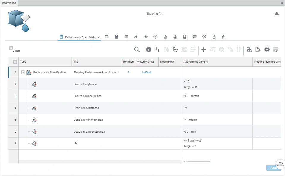

Quality attributes are defined through Performance Characteristics for raw materials, WIP and finished products (conductivity, cell density,...) with acceptance criteria and release limits and can be accessible directly from the information panel of the material in Recipe Management application.

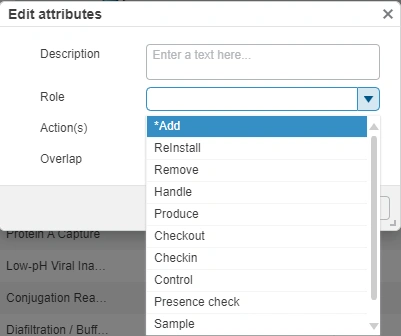

Relationships between the process and the material through Implement links
In ISA-88, materials are not simply defined in a list but are explicitly linked to specific process steps within the recipe. This means that each material is introduced, consumed or produced at a defined point in the process flow, ensuring a clear connection between the formula and the procedural execution. This linkage enables precise control of when and how materials are handled during batch execution, improving consistency and traceability of the process.
Different materials can be scoped / implemented based on their nature with different roles that are owned by the implement link that define permissible actions or states for items/processes:
| Items | Operations Link Types | Possible roles defined on implement links |
| Continuous Provided Materials | Can be implemented to Header Operations or General Operations | |
| Provided Parts | Can be implemented to Header Operations or General Operations | |
| Continuous In-Process Materials | Can be implemented to Header Operations or General Operations | |
| Continuous Manufactured Materials | Can be scoped to Header Workplans and Workplans Can be implemented to Header Operations or General Operations | |
| Phase | Can be scoped to Header Workplan or Workplans | NA |
Remarks:
- The roles that are on the implement link can be customized by the admin in the Control Center.
If there is a need to have an OOTB integration to APRISO, even if the materials could be found at Header Operations level, the best practice would be to implement them to General Operations. If there is a project with only Ortems, the best practice would be to have them implemented at the Header Operations level. If there is a project for both APRISO & ORTEMS, the users would have to implement them at General Operation level and then the service team would manage the retrieval at Header Operation level for Ortems. Need to be defined for the best practice for OOTB integration with PSL.
- The links are then displayed as is in the grid view with the (role):

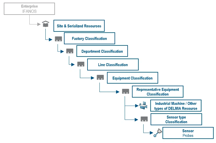

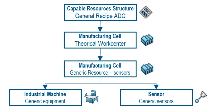

The physical model

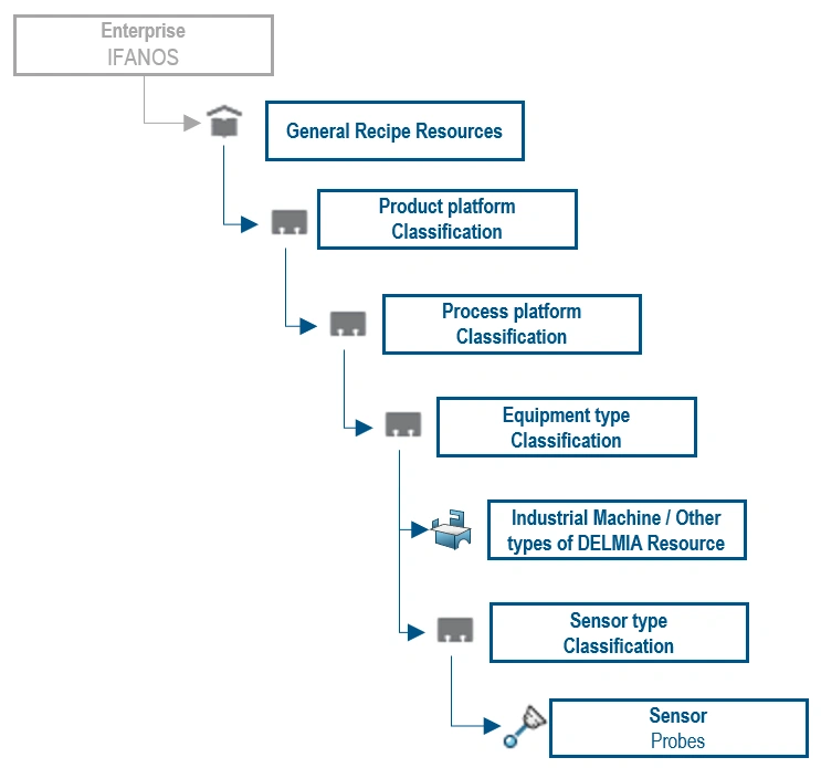

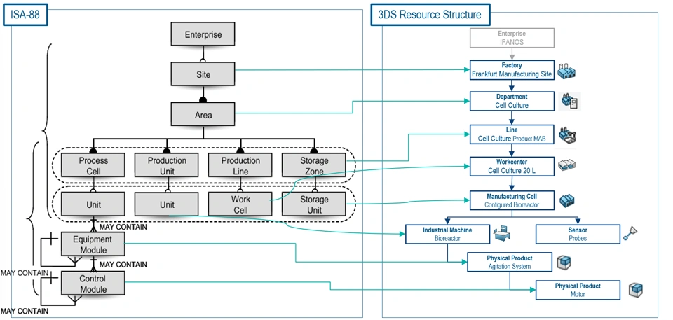

In parallel to the process, ISA-88 defines a hierarchy of equipment from site level down to units and control modules.
The requirement is that the process steps can be mapped to this equipment structure but are not hardcoded to specific assets too early.
| Recipe Level | Type of resource Structure used for process modeling | Resource Structure example | Classification Structure of equipment | Asset Structure |
| General Recipe | Capable Resource Structure | Not applicable | ||
| Site Recipe | Capable Resource Structure | Not applicable | ||
| Master Recipe | Asset Structure | Not applicable | Not applicable |
Remarks:

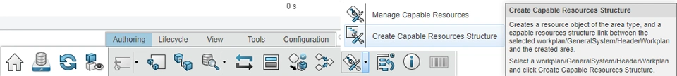

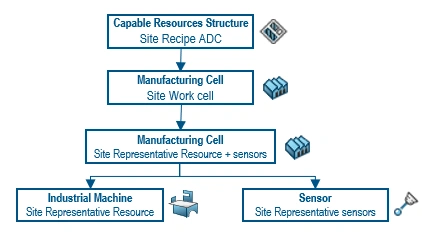

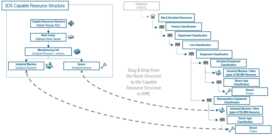

Capable Resource Structure [For General & Site Recipe]: A Capable Resource Structure is a hierarchical framework that defines and organizes the physical or logical resources required to execute one given recipe with generic equipment. The definition of Capable Resource Structure from a Classification Structure is relevant for the definiton of General and Site recipes, where Generic Resources are referenced in Libraries. It can be modeled by drag & dropping objects from IP Classify & Reuse to the Capable Resource structure.
A "Capable Resources Structure" can be created from the authoring tab in RME:
Asset Structure [For Master Recipe]: An Asset Structure represents the physical or logical hierarchy of a company with one or multiple factories, organizing key elements such as workcenters (logical or physical units where operations are performed), serialized assets with individual machines or pieces of equipment (a mixer with a serial number) and pools (groups of similar assets or resources managed collectively for efficiency). This structure serves as a foundational framework for linking manufacturing resources to production processes, particularly for scheduling and execution. This hierarchy mirrors the logic of the factory layout, with Serialized Assets and is independent of specific Recipes / production processes but can be dynamically linked to them. The best practice would be for Master Recipe to:
Link the Header Workplan with an "Asset Structure" link to the "Factory" or "line" level
The Workplan with a "Pre-assigned" link to the Workcenter
The "Industrial Machine" as Primary Capable Resource
The "Sensors" as Secondary Capable Resource
Asset Structures can be created from Factory Resource Management application, by deriving an existing General Resource or creating it from scratch and then reusing them in Recipe Management application.
Decoupling process and equipment
It's an important concept of ISA 88 to decouple process logic vs equipment logic, the process defines what to do and the equipment defines how it is done, it is even more important for General recipes as they should strictly NOT be tied to specific equipment, the recipe says “heat to 37°C” and then the equipment decides how to do it.
Then, the Master Recipe can in addition consider equipment constraints and slightly modify the recipe based on this constraint. The ISA 88 also mention that the Parameters definition should be decoupled of the equipment execution logic, the recipe gives the parameters and the equipment manage the automatism logic.

Therefore, users have to execute the following tasks based on type of recipes:
| Recipe Level | Tasks | Illustration |
| [Process Model] General Recipe |
| [Process Model] Site Recipe |
| [Procedural Model] Master Recipe |
Remarks:
- RPP and DCP rows allow to manage the Setting of Instructions for a resource or to a resource or the collection of data during the process that can be manual collection of resource based data collection.
- DCP rows would be defined for data that are collected and referenced as is in the Electronic Batch Record.
- RPP rows GET would be defined for data that are collected but not influencing critically quality therefore don't need to be put in the EBR.
- The visualisation of RPP / DCP rows is optimized through the Swimlane view.
