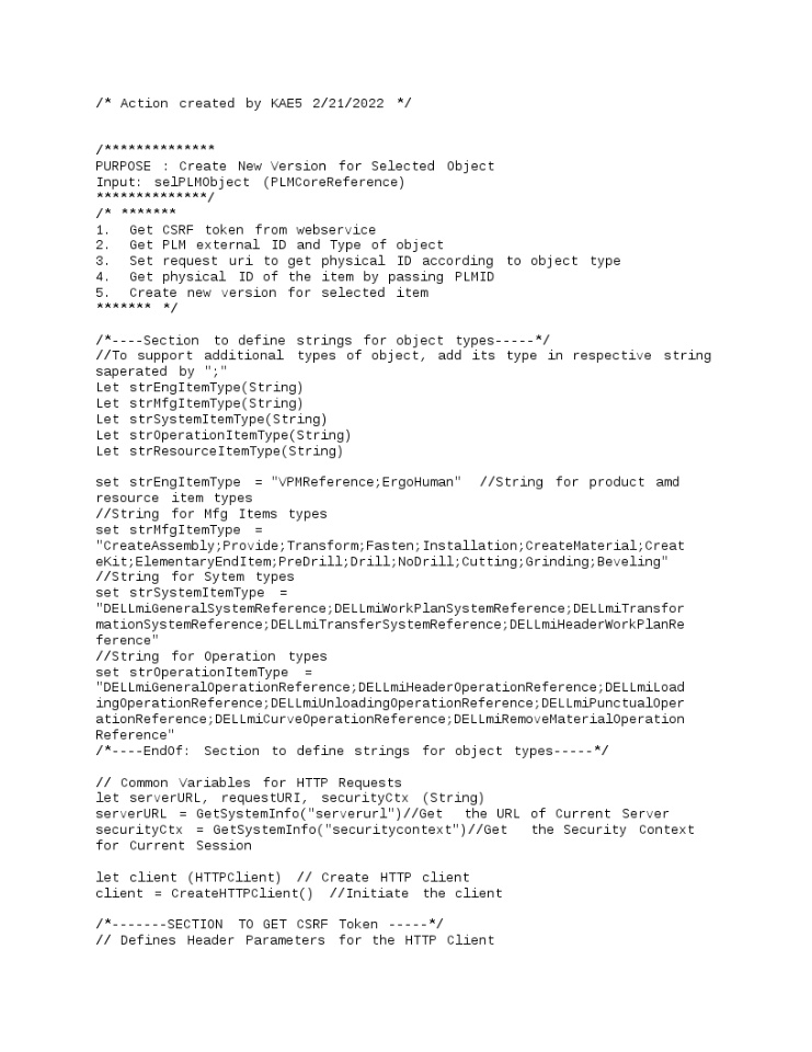

Selecting Web Service URI to get Physical ID
To get physical ID of objects, there are different web service URI's for different objects.
At the start of the code, there are strings defined for each type of objects , which contains all subtypes available in that type. For example:
set strMfgItemType = "CreateAssembly;Provide;Transform;Fasten;Installation;CreateMaterial;CreateKit;ElementaryEndItem;PreDrill;Drill;NoDrill;Cutting;Grinding;Beveling"
For selecting the correct URI as per the selected object type, "IF Else" blocks are used. Please find the section of code between below two comments in attached EKL script:
/*----Section of code to select web service URI according to object type----------------------*/
/*----End of: Section of code to select web service URI according to object type--------------*/

/*-------SECTION TO Create New Version of Selected Object -------------*/
/*---- End of: SECTION TO Create New Version of Selected Object--------*/
