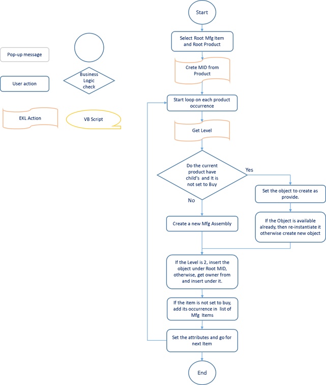

Logical Flow
Below is the logical flow for Creating Mfg. Item structure from product structure
Example
Create Mfg. Item Structure from Product Structure

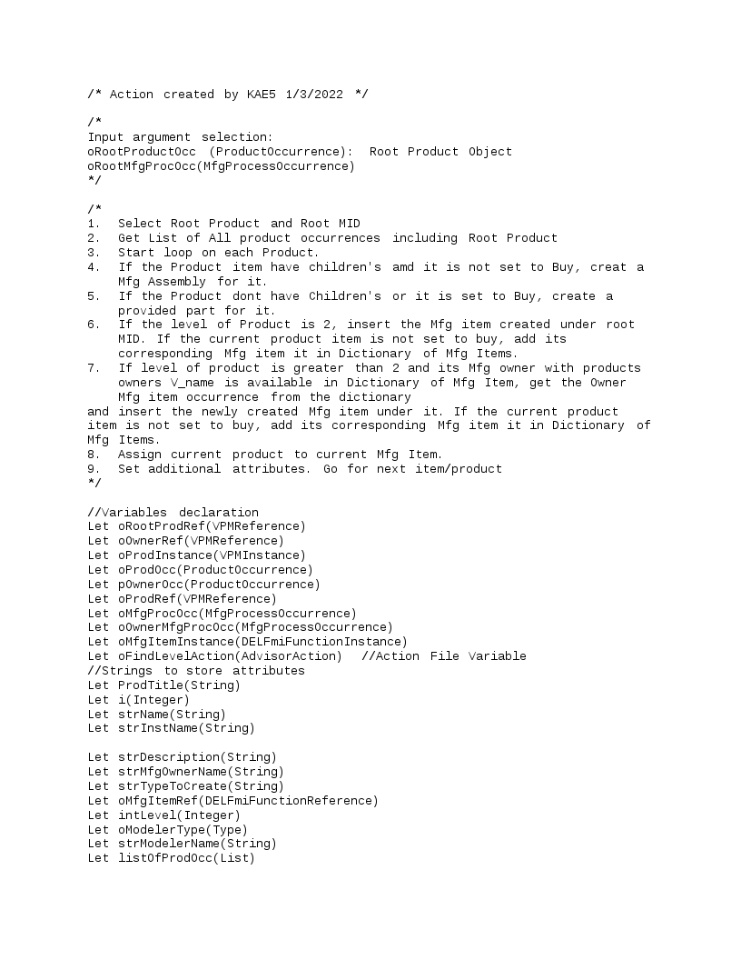

Get Level of Product Item
Detail Explanation
Get list which includes root product and its children’s in same sequence as they appear in tree.
Below lines of code is responsible to get list of all “ProductOccurrence” including root product in a same sequence as they appear in the tree.
listOfProdOcc->AddItem(oRootProductOcc, 1) //Add root product to this list
//Find all the objects of type "ProductOccurrence" inside Root Product Occ
listOfChildProdOcc = oRootProductOcc->Query("ProductOccurrence", "")
// Above list will be the entire list of ProductOccurrence objects available under Root Product node
listOfProdOcc = listOfProdOcc + listOfChildProdOcc //Add both the lists

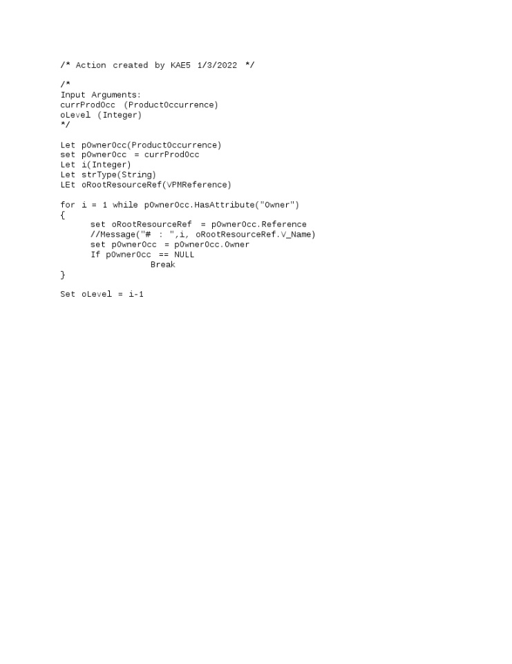

Get level of Current Product from tree:
To get level of product item in tree, another EKL script is called by passing Product occurrence and a variable to store Level. The script returns the level of the passed product as output.
The below lines of code calls the external action file
oFindLevelAction.Run(oProdOcc, i)  //A action script which finds the level of occurrence in the tree
The Action file called above is attached in this page in Example section.
How to decide Mfg Item type, manage Make or Buy scenario and how to manage Multi-Instantiation
Make and Buy Scenario:
If it is needed to create a Provided Part for a Product, which is an assembly, but it is Outsourced or will be purchased from outside, the user needs to set the “V_description” attribute of that products items reference to “Buy” (The attribute is case sensitive. if specified as "BUY" it will not work.). The code will handle the scenario as given below.
If the user don’t need this scenario, just keep “V_description” of the products reference as either Make, blank or any other value than “Buy”.
Steps followed to decide Mfg item type:
  1. If the product item have children’s and its “V_description” attribute is not set as “Buy”, then create object of type Manufacturing Assembly.
  2. If the product have no children’s or its “V_description” attribute is set to “Buy”, then create Provided Part for the product.

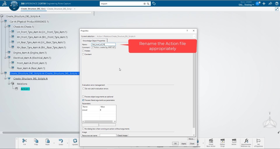

How to Deploy
This video given below describes: How to deploy the "Create MID Structure from Product Structure" EKL Script?. However, the process is same for following EKL Script:
   1. Create Process Structure from Mfg. Item Structure
(Note:
1. Instead of creating a separate Physical Product for containing each create structure EKL script, you can create the action files for the above EKL scripts in the same Physical Product that we are going to create for "Create Mfg. Item Structure from Product Structure" EKL Script.)
