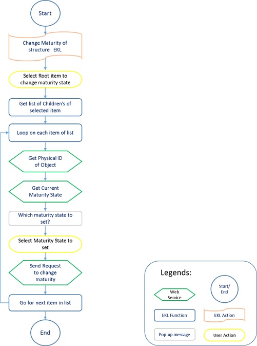

Logical Flow
Below is the logical flow of the script to change maturity:

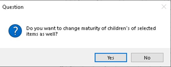

Option to change maturity of children
When the script executes, it will ask user "Whether to change maturity of children's of selected items as well?". If user selects yes, maturity of selected item as well as its children's will be changed. Otherwise, maturity of selected item will be changed only.
The code given below is responsible to show the dialogue box.
//Show dialogue box to ask user whether to set maturity of root or all its children's as well
set ChangeMaturityOfChildrens = Question("Do you want to change maturity of children's of selected items as well?")A list of objects is created.
- If user selects "Yes", selected item and its child's will be added in list.
- If user selects "No", then only selected item will be added in list.
Objects in the list will get their maturity changed.

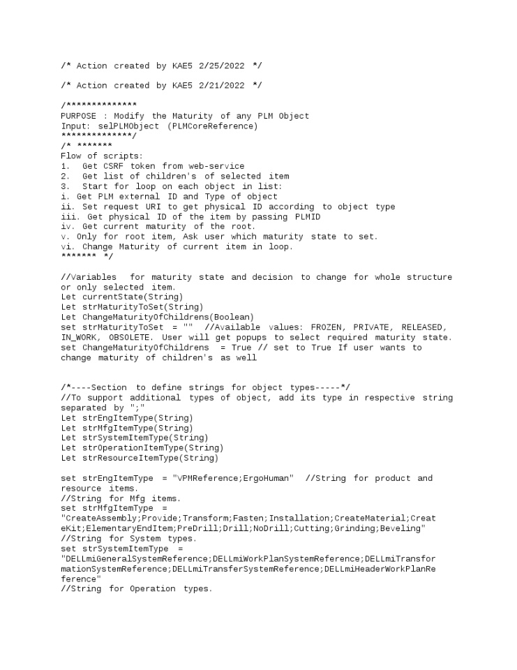

At the start of the code, there are strings defined for each type of objects , which contains all subtypes available in that type. For example:
set strMfgItemType = "CreateAssembly;Provide;Transform;Fasten;Installation;CreateMaterial;CreateKit;ElementaryEndItem;PreDrill;Drill;NoDrill;Cutting;Grinding;Beveling"
These strings will be used in "IF Else" blocks conditions to select URI according to type of object. Code for this is available in attached script between below lines/comments:
/*----Section of code to select web service URI according to object type----------------------*/ . . /*----End of: Section of code to select web service URI according to object type--------------*/

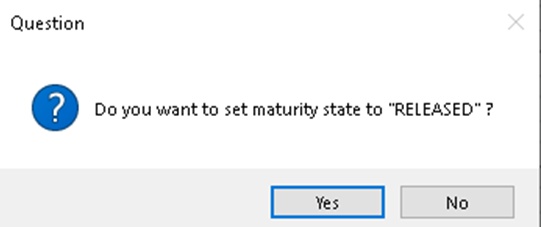

Once the current maturity state is found, we need to decide the next state to be set. The code between below given comments will ask user for the desired maturity state according to current maturity state:
/*-------SECTION TO select next maturity state. -----*/ . . /*-------SECTION TO select next maturity state. -----*/
Below is the example dialogue box:
