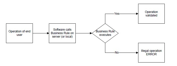

  • A business rule is a piece of logic that will be triggered during the execution of an app to make decisions or prevent an operation. The logic is described using the Enterprise Knowledge Language that enables to manipulate almost all the objects of the different apps.
  • Some are invoked on the server side during life cycle operations (maturity change, revision change, transfer ownership, cloning and workspace delivery).
  • Some are invoked on the client side to implement object naming strategies, or rules for aggregating and inserting objects in structures.
  • Some are invoked in standard User Interface components like PLM New or Edit properties to control the valuation of attributes.
