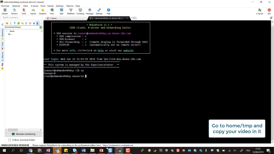

The first step is to upload your files on the server.
You can use a program like Mobaxterm. Use the existing folders:
- For a picture : /home/data/RTV/DEMORXXX/apache-tomecat/webapps/3DSpace/webapps/DEL_IC_Static/Sketches
- For a PDF: /home/data/RTV/DEMORXXX/apache-tomecat/webapps/3DSpace/webapps/DEL_IC_Static/PDF
- For a video : /home/data/RTV/DEMORXXX/apache-tomecat/webapps/3DSpace/webapps/DEL_IC_Static/Player
You will find below an example video.
