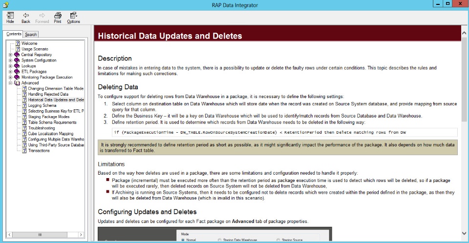

The subject is covered also in RAP DI help "Historical Data Updates and Deletes" in advanced topics section.

In order to properly configure archiving processes with MPI, "retention" period of ETL packages generated by RAP DI should be set.
Retention period is time range, when delete action on source database is considered as performed by user and should be reflected in DW. In other words during retention period, row removed from source system DB will have corresponding action in Data Warehouse of MPI. The rule is defined in the following way (refer to configuration guide in RAP DI help file):
IF (PackageExecutionTime - DW_TABLE.RowOnSourceSystemCreationDate) < RetentionPeriod then DELETE matching rows from DW
 Based on the way how deletes are used in a package, there are some limitations and configuration needed to handle it properly:
  • Package (incremental) must be executed more often than the retention period as package execution time is used to detect which rows will be deleted, so if a package will be executed rarely, then deleted records on Source System will not be deleted from Data Warehouse,
  • If Archiving is running on Source Systems, then it needs to be configured not to delete records which were created within the period defined in the package, as then they will also be deleted from Data Warehouse (which is invalid in this scenario).

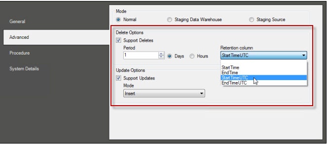

Retention period should be configured in Advanced settings of RAP DI ETL package:
To configure source system delete row action:
  1. Go to Delete Options group box and select the Support Deletes check box.
  2. Use the Period field to specify the time for which data will be possible to be deleted.
  3. Select the column that will be the base for counting the time set in the Period field. To do this, use the Retention column drop-down list.
