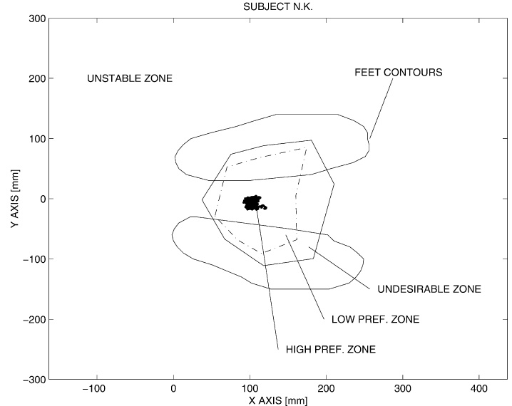

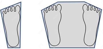

In order to predict such plausible posture, some constraints are imposed on the DHM. First, postural stability is ensured by constraining the floor projection of the center of gravity (COG) inside the base of support. The base of support, also known as sustentation polygon, is the area enclosing the body extremities (e.g. feet, hands) in contact with the environment (e.g. single foot, two feet, two feet + single hand). The closest the COG is from the boundaries of the base of support, the more difficult is to keep postural stability. For that reason, the COG is constrained within a "region inside a region', i.e. the high preference zone inside the base of support (Fig. 3, Popovic et al. 2000). The COG control in multiple supports is possible through the concept of augmented bodies (Boulic et al. 1997). Note that the EWD application has been originally designed to deal with postures with the two feet touching the same horizontal floor. More complex scenarios may eventually involve single or both hand bracing, which would affect the sustentation polygon.
Fig 2. Example of sustentation polygon (blue) in single and dual foot support. Source : Phu et al. 2019.
Fig. 3: High preference, low preference, undesirable and unstable zones for a single subject. Source: Popovic et al. 2000.
