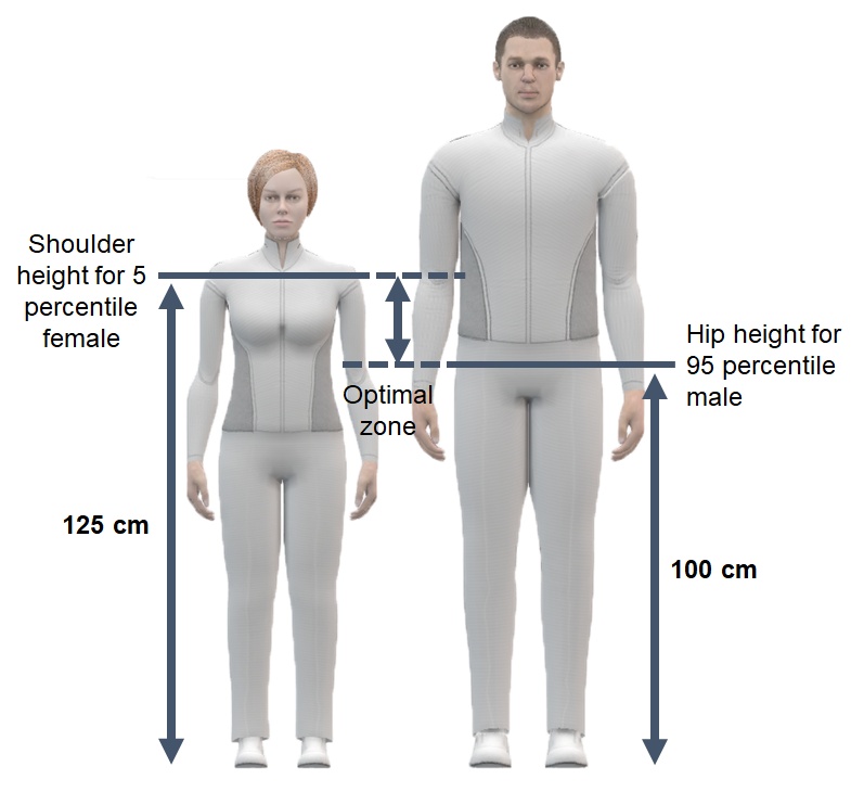

Ideally you want to design your workstation for a wild range of people. Here we will consider the 5 percentile  female and 95 percentile male to determine the optimal object location.
In the image above, we are using the ISO 14738 to determine the optimal hand zone. Indeed, the standard is explaining the object should be located between the hip and shoulder.
Using a rough measurement, we determined that the object should be located between 1 meter to 1.25 meter high in order limit the risk of MSD for the worker.
