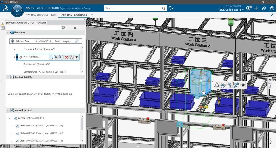

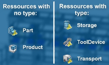

​​​​​​​You can tell if a resource is typed by the icon on the left of it:
Or by going to the object properties:
You can also see the resource ergo category by going down on the on the properties panel:

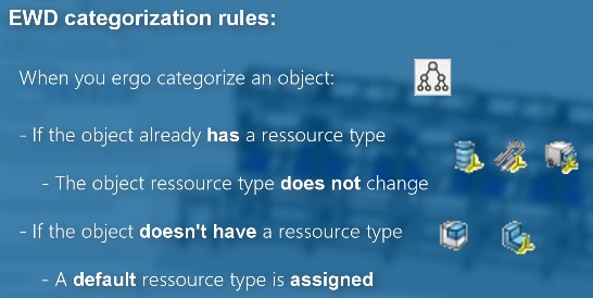

How EWD handle resource type​​​​​​​

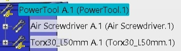

 Tool categorization
When categorizing tool that are composed of several parts (a power screwdriver + a tool end), make sure to categorize the parent product to be able to move all parts together.
