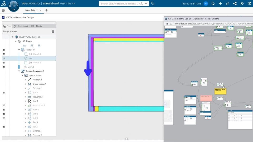

Management of end cuts of wall layers:
Convention used : 1-1-3 means
layer 1 is cut by layer 1 of the end of previous wall,
layer 2 is cut by layer 1 of the end of previous wall
layer 3 is cut by layer 3 of the end of previous wall
the complementary coding (for the other side of the wall is done automatically)
You can also define every wall layer thickness
Set a different number of layers and different corner priority codes
in this case you need to manually fill a list with "Build List" operator
