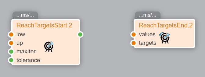

Two new advanced operators have been implemented since R2023x FD01 release, to find proper input values to reach specific targets values.
Those operators are requiring "CATIA Engineering Rules Capture" application (and installed on your local machine), to be accessible in "CATIA Visual Scripting".

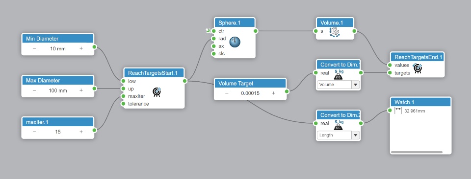

A simple usecase to find the diameter or a sphere in order to get a specific volume as target.
Reach Target for Glass Volume :
3dxml to download

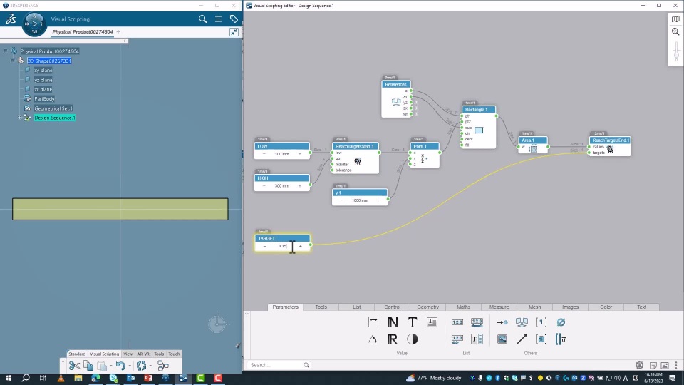

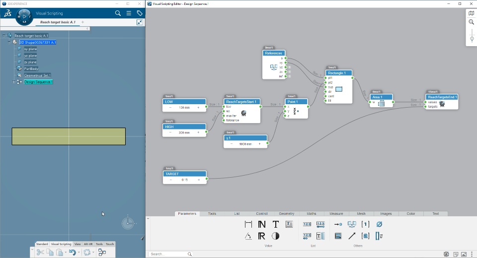

Rectangle by target area
From @CB 's post : here is a model to check if you want to start trial of "REACH TARGET" loop function
3dxml below
the model is to create a rectangle of 1.5m2 by tuning its height between 100mm and 300mm... I think super basic for everyone in the community.
the purpose is that you can refer to a visual script for more complex use case.

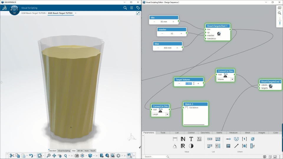

Bottle by volume target
I also added @TV ​​​​​​​video for bottle volume use case (more complex). Thanks R&D!
