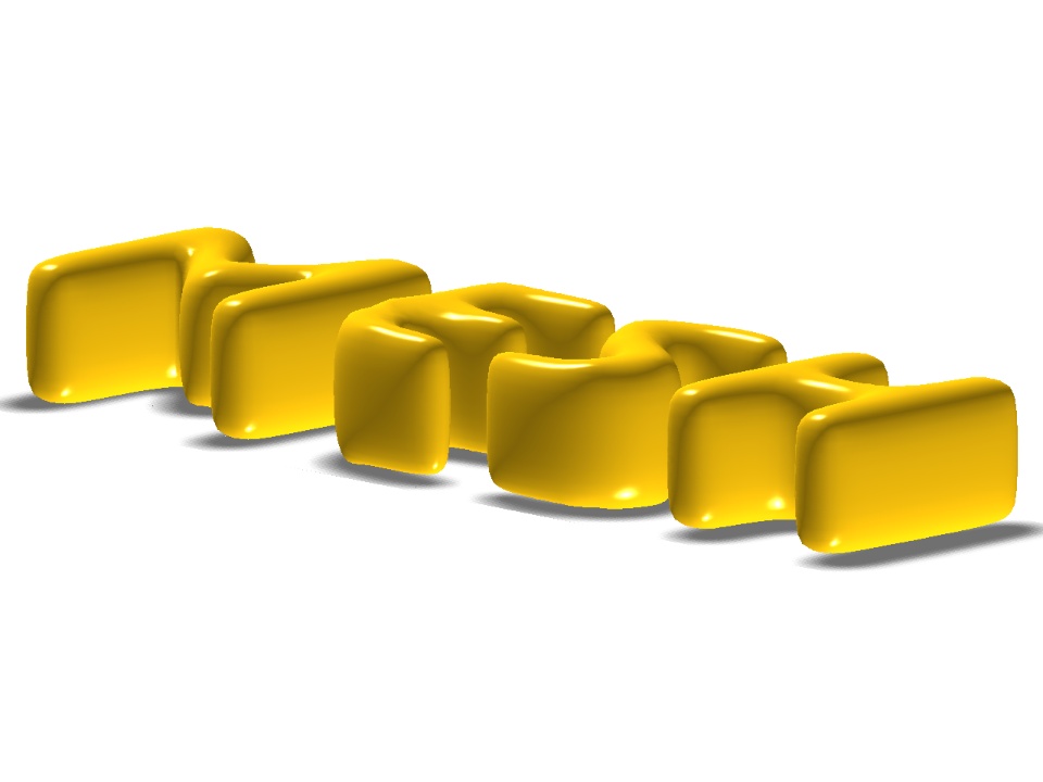

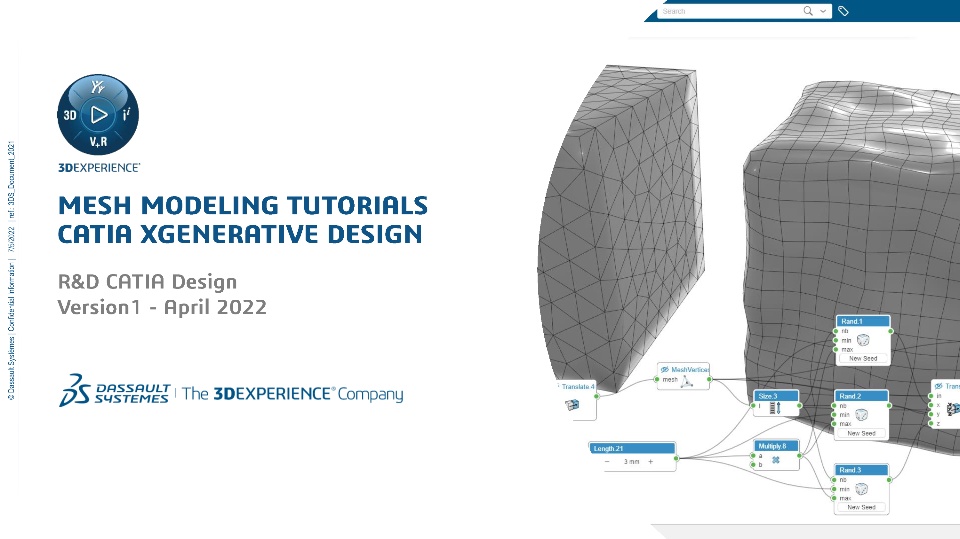

Hi community, here you will find a 3DXML file with 15 tutorials to learn the basics about mesh modeling (a new set of operators available since the R2022xFD02 update, with "3D Shape Designer" or "Computational Designer for Construction" ROLES.

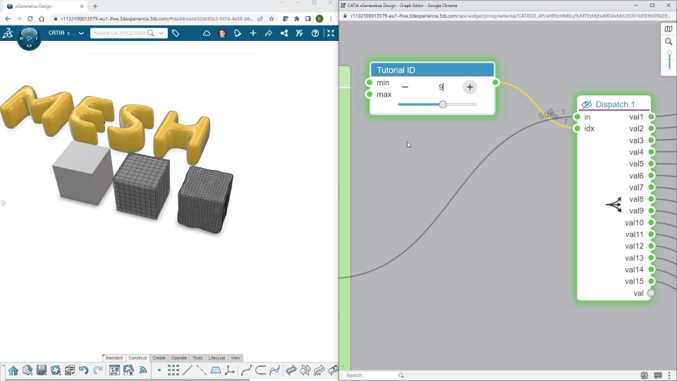

A simple 3D cube is used as data sample, use the dispatch tutorial ID parameter to load the corresponding sequence.
