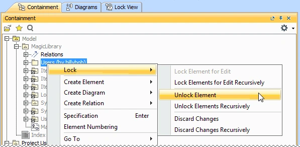

Lock and Unlock a ProjectManaging access to the projects becomes crucial while working with a team. Let us read more about locking and unlocking of the CATIA Magic project and it's elements. Lock Elements and DiagramsYou must lock the part of the model you are going to edit to prevent other users from editing it at the same time. An element/ object can only be locked by one user at a time. Once it is locked, other users can only access it but not edit it. The following table lists editable elements after you lock a single element, single diagram, diagram with elements, symbol styles and project usages.
Unlock Elements and DiagramsYou can use commands from the shortcut menu to unlock elements and diagrams. Unlocking modified elements will trigger to commit the project. Project BranchingProject branching enables multiple users to work on the same model at the same time. For this, you need to create a project branch, which is a copy of the project. You can modify the branch as required, independent of other branches. Branches can be merged back when required. Conflicts between the branches are resolved during the merge process.

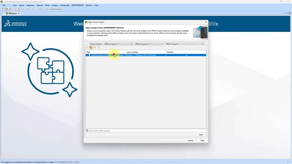

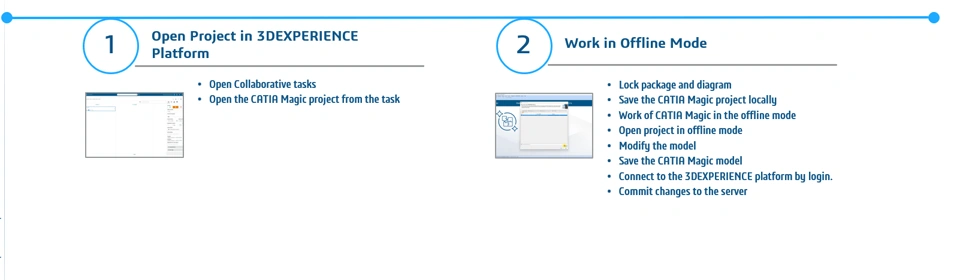

Use Case: Working in Offline ModeScenario:A systems engineer is assigned to make changes in the CATIA Magic project. He is currently in the low bandwidth area, due to which he cannot be continuously connected to the 3DEXPERIENCE platform. Let us see how the systems engineer uses CATIA Magic in offline mode for making the changes and later commits the project in the 3DEXPERIENCE platform. Actors/Personas:Mark, Systems Architect: Mark is responsible to make changes in the CATIA Magic model. But due to low bandwidth, he cannot be continuously connected to the 3DEXPERIENCE platform. He now needs to work on the CATIA Magic model in the offline mode and later commit the modification to the server. Workflow:
Prerequisite Roles3DSwymer (IFW-OC), Collaborative Industry Innovator (CSV-OC), Collaborative Designer for CATIA Magic (SSY-OC) | ||||||||||||

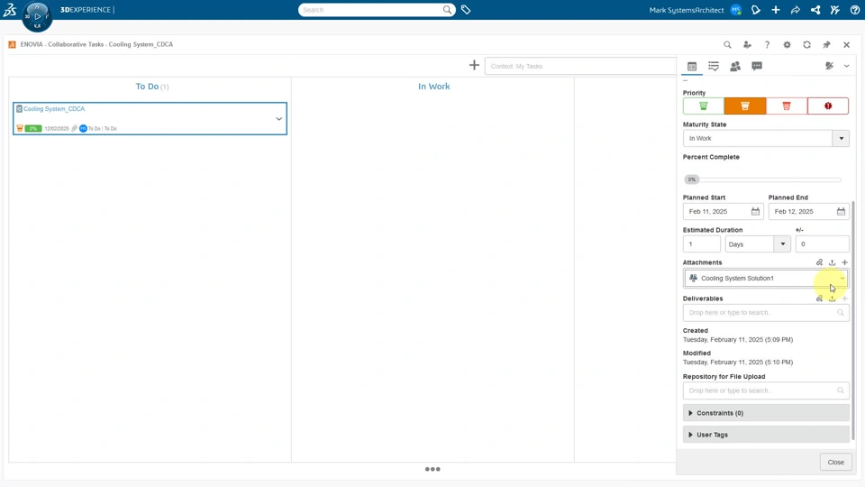

Step 1: Open CATIA Magic Model | ||||||||||||
Step 2: Work in Offline Mode | ||||||||||||
