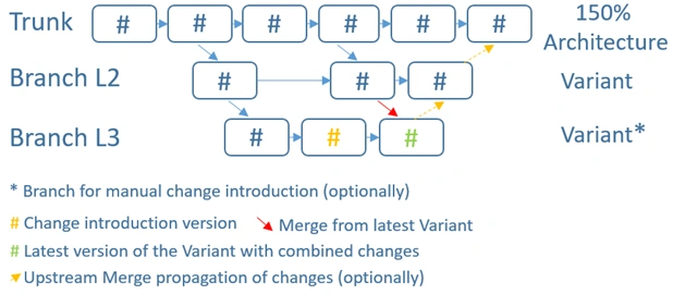

Now to the second aspect regarding the Variant Architecture Management. A practical solution is to store the 150% Architecture Model in the Trunk and 100% Architecture Models (Variants) in the Branches of the same Project. Branches are Configuration Specific – each Variant is realized to its own Branch.
The Development of the 150% Architecture Model in most cases usually takes place in the Trunk and the snapshots of Variants are realized as required to their corresponding Branches. This is the case when Variant models are used only for analysis, publishing, giving to OEMs, etc.,-- not for further Architectural development.
However, depending on internal processes, changes sometimes need to be introduced in the Variant Model. As illustrated, a third level is required for change introduction. The changes in the Variant Architecture can then be optionally merged back to the second level and then back to the 150% Architecture.
