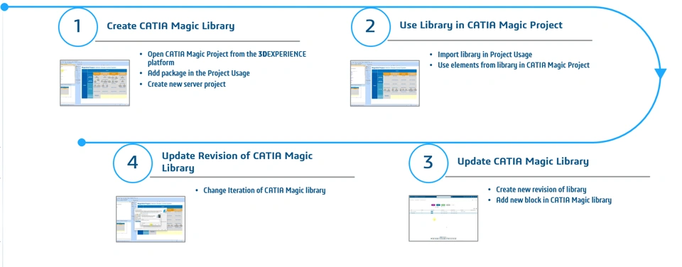

Workflow:
Prerequisite Roles
3DSwymer (IFW-OC), Collaborative Industry Innovator (CSV-OC), Collaborative Designer for CATIA Magic (SSY-OC)

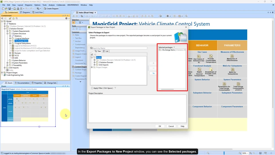

Step 1: Create CATIA Magic Library

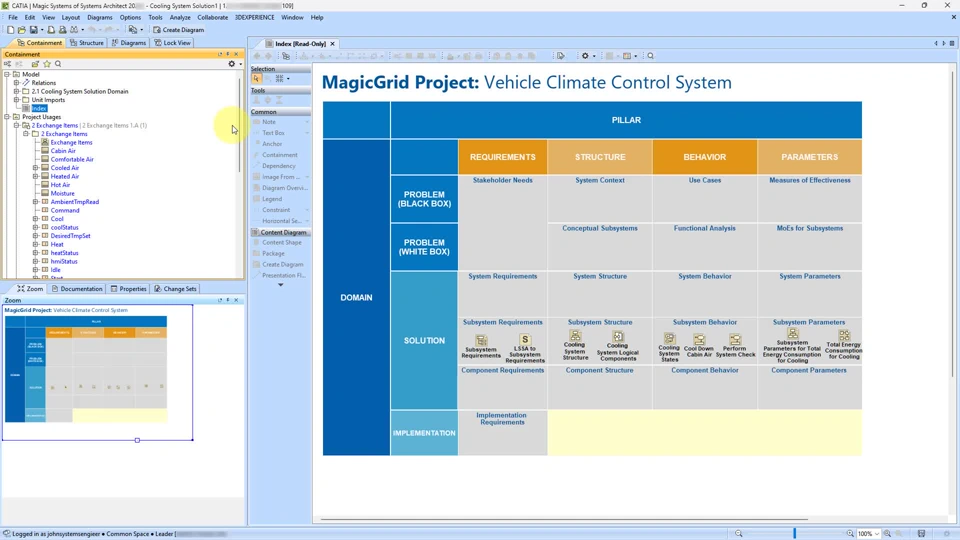

Step 2: Use Library in CATIA Magic Project
Step 3: Update CATIA Magic Library

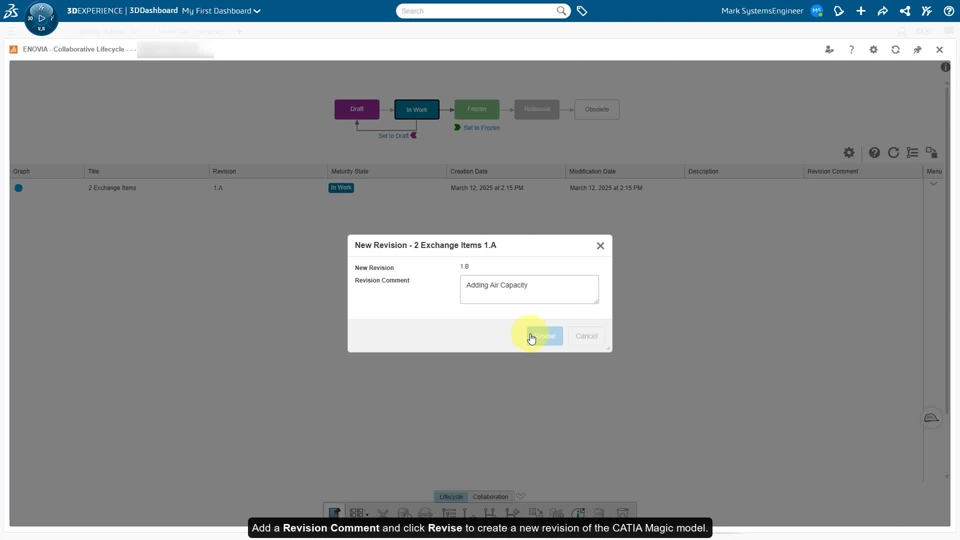

Step 4: Update Revision of CATIA Magic Library
