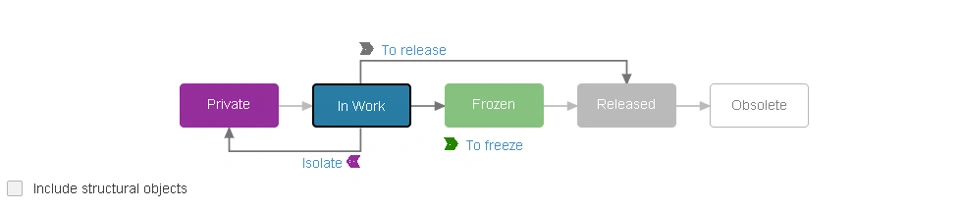

Maturities of System Models
In the 3DEXPERIENCE platform, the maturity states of a physical product help manage its lifecycle by defining distinct stages. Here is an explanation of each state:
1. Private
Description: This is the initial state where a physical product is only visible to its creator or a restricted group.
Purpose: This state allows early development work and iterations without broader visibility. It is useful for preliminary drafts and experimental designs that are not yet ready for a team review.
2. In Work
Description: This state indicates that the product is under active development and can be accessed and modified by designated team members.
Purpose: This state facilitates collaboration among team members, enabling collective development, editing and refinement of the product. This state is crucial for iterative development and incorporating feedback.
3. Frozen
Description: The product is in a state where no further changes can be made except by an authorized personnel.
Purpose: This state ensures stability before the final review and release. It allows thorough validation, testing and quality assurance without the risk of unapproved changes. This state acts as a checkpoint for critical reviews.
4. Released
Description: In this state the product is finalized, fully validated and approved for use or production.
Purpose: This state marks the product as complete and ready for deployment, manufacturing, or customer use. This state signifies that the product has passed all necessary checks and meets all required standards and specifications.
5. Obsolete
Description: In this state the product is no longer in use and is retired from active development or production.
Purpose: This state helps manage and archive older versions or products that are replaced by newer models. This state ensures that obsolete products are clearly marked, preventing their use in current projects and maintaining an organized product catalog.
Each of these maturity states serves a specific role in managing the product development process, ensuring that products are developed systematically, reviewed thoroughly and transitioned smoothly from concept to completion and eventual retirement. The structured approach of the 3DEXPERIENCE platform for maturity states helps maintain high standards of quality, compliance and efficiency throughout the product lifecycle.

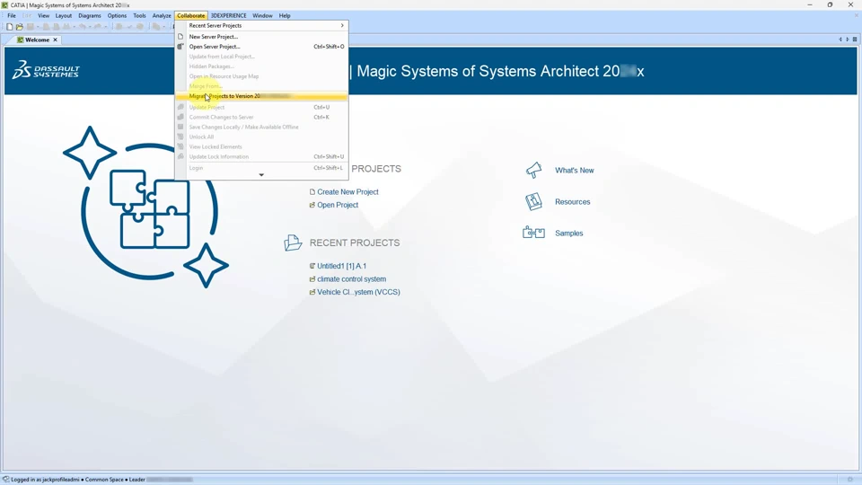

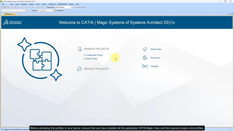

Step 1: Upload CATIA Magic Profiles on 3DEXPERIENCE Platform
Step 2: Change the Maturity of CATIA Magic Profiles
Step 3: Update Profiles on 3DEXPERIENCE Platform

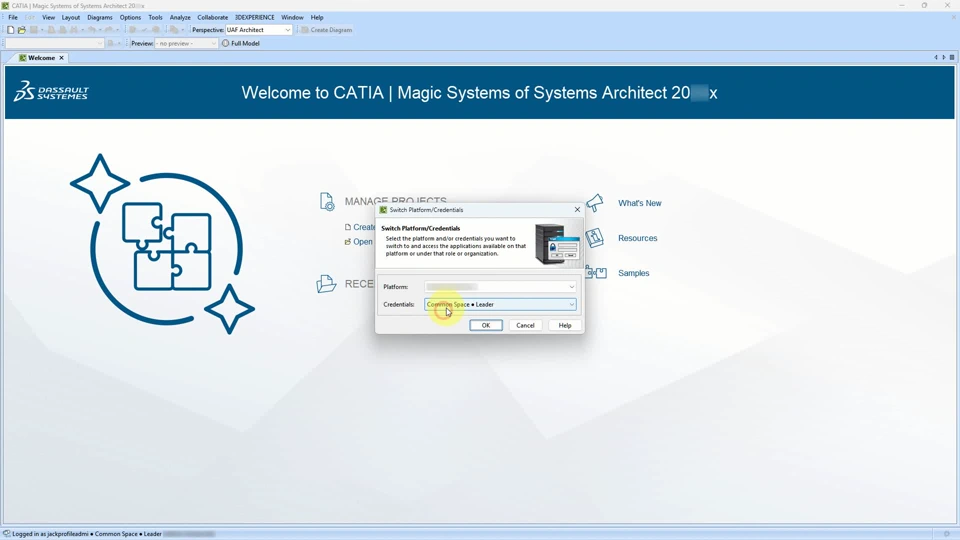

  • Ensure, you are on the right 3DEXPERIENCE platform server and Collaborative Spaces.
    • Navigate to the 3DEXPERIENCE menu in the CATIA Magic application.
    • Select the Switch Platform/Credentials option.
    • Select the desired platform and credentials.
