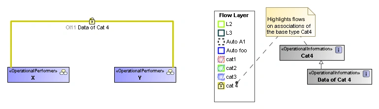

In the video below, this is a complex query for a legend than sets the color and icon for the flow realized on an association. The customer wanted to be able to see the type or category of item flowing. Thus the query needs to navigate from the association (Operational Association in this case because this is UAF), then to the flow, then to the conveyed, then its generalization. This returns a list of general types of all the flows realized by the association. We then use the operation from model called contains, to test is one of the categories we are targeting is in the list. The contains returns a true if one of the items matches. Note that this is a common concept in queries where many stages of the query can return collections rather than single elements, so we need to do collection test operations rather than simple boolean logic.

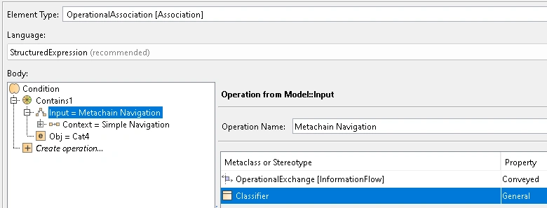

Here are the steps for this example:
- New legend Item Created.
- Legend adornment is set to change line color (pen color), line width, and the icon.
- Click into the Element By Condition.
- set the Element Type (in this case it is OperationalAssociation)
- Create a Simple Navigation
- Note: Unclick the Show relations criteria available only for context may be necessary depending on the stage.
- Select the relation criteria, Realization (Information Flow), also note that this is target to source
- Select the Condition root, then Create operation and add a Metachain Navigation.
- Expand the metachain and drag the Simple Navigation onto THIS. The concept is that the Metachain starts from the result of the Simple Navigation.
Click onto the root of the Metachain and set it as follows:
Metachain to fined conveyed element's general classifiers - OperationalExchange - Conveyed (note that we need to change the type to OperationalExchange as this is the result of the SimpleNavigation)
- Classifier | General
Click on Condition root and click Create Operation and select Operation From Model, then search for contains.
Operation from model: contains - Drag the Metachain onto the input parameter (this will be the collection we are searching for a match)
- Click on the obj parameter then click Create Operation and select from the Values section, Element. We get a dialog popup to select the item we want to search for.
- The query is complete and we can close the dialog.
To summarize we have created the following query contains(metachain(SimpleNavigation-Realization,OperationalExchange.Conveyed.Classifier.General),Element(Cat4))
