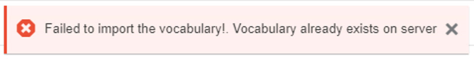

Failed to import the vocabulary!. Vocabulary already exists on server
Probable Cause:
  • The error occurs when the RDF contains a reference to an old RDF file that has been uploaded to the platform.
Probable Solution:
  • Confirm if the RDF title has been updated throughout the RDF file.
