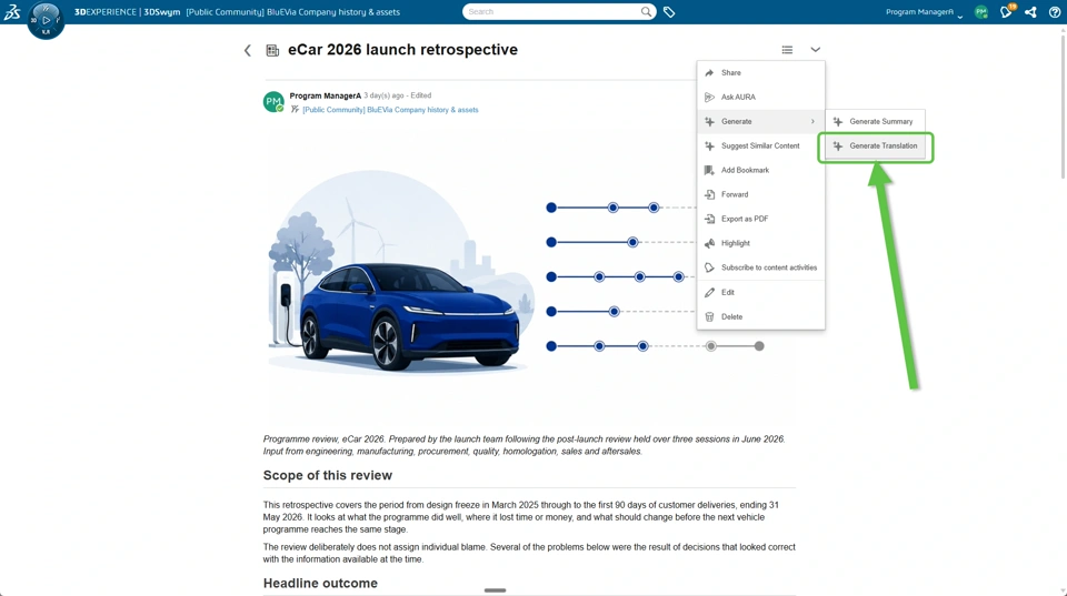

From published content

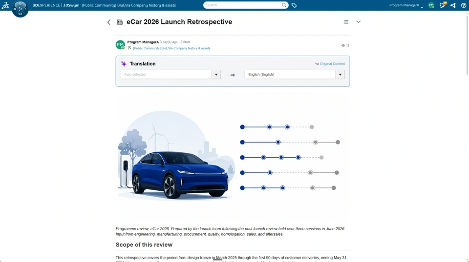

This translates the whole content and keeps exactly the structure it had: titles, tables and the rest. It shows you the translation without editing the content. You are the only one who sees it, and only for as long as you keep it open. | |

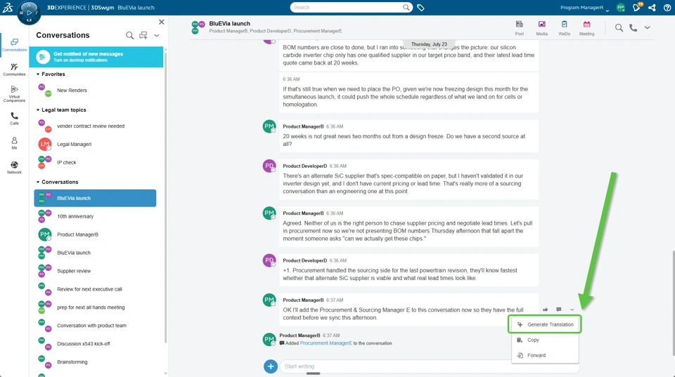

On a message in a conversation
It shows you the translation without editing the message. You are the only one who sees it, and only for as long as you keep it open. | |

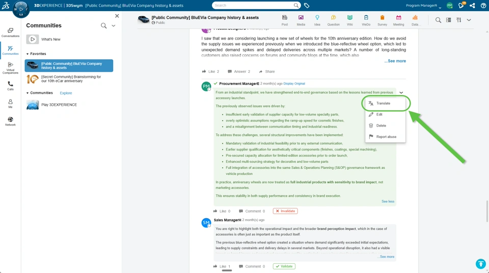

On an answer or a comment
It shows you the translation without editing the answer. You are the only one who sees it, and only for as long as you keep it open. |
Choosing the language
When translating published content (Post, Wiki, etc) you can manually choose the output language
Comments and messages skip this step. They translate straight away into your default 3DEXPERIENCE platform language.
