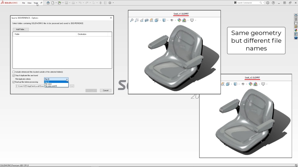

The Save to 3DEXPERIENCE command now allows better management for duplicates. The process could stop in case two files with the same name are found or even if file names are different but the geometry is the same.
