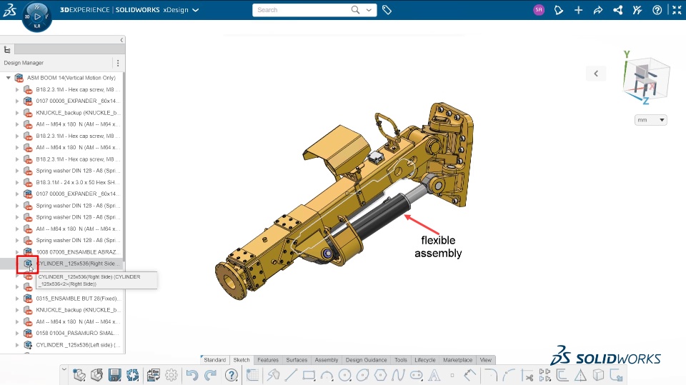

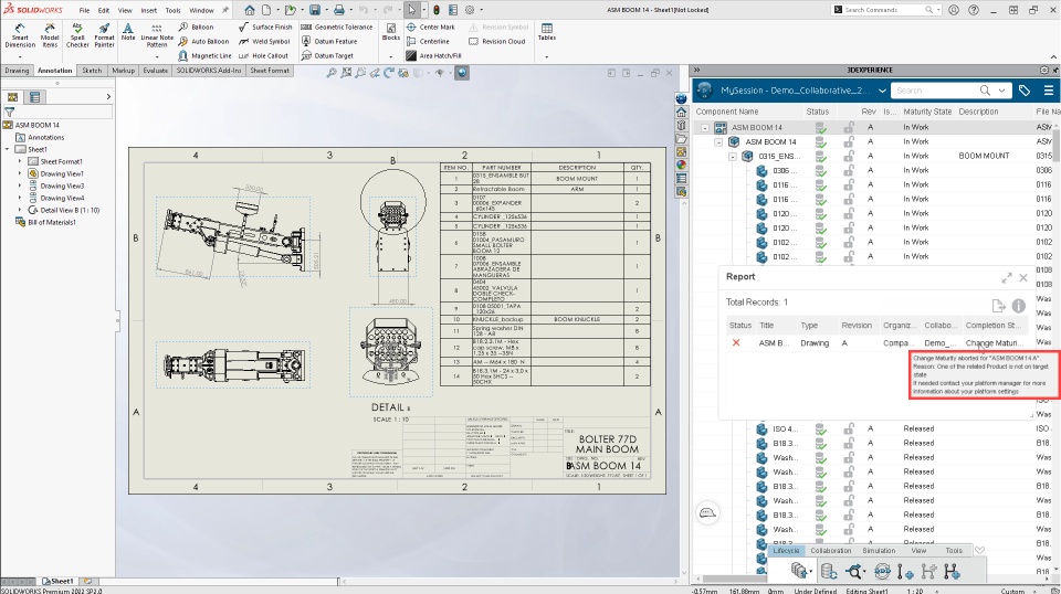

Support for flexible assemblies will be provided for the ease of managing complete assembly structures on the 3DEXPERIENCE Platform. Workflow improvements will be introduced to only allow release of drawings when its children are released.

Support flexible assemblies on 3DEXPERIENCE Platform

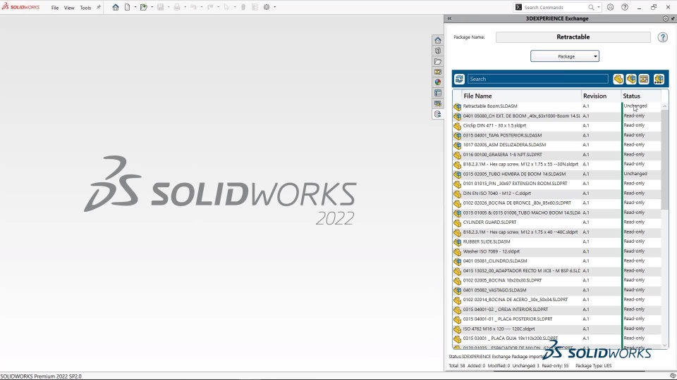

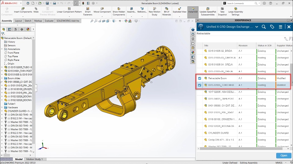

Support data exchange between OEM supplier and 3DEXPERIENCE Platform, modified data from the OEM is highlighted
New maturity transition rule is now available to block drawing transition if its referenced components are not in the targeted maturity state

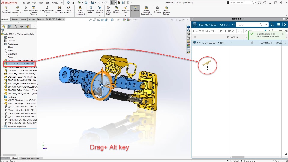

Support drag and drop components from Feature Manager Design Tree to 3DEXPERIENCE Platform apps
