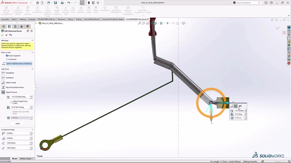

[ENHANCED] More Refined Flattened Harness Drawings
Description: Create a flattened harness drawing with more refined results and an improved workflow. Improvements include:
Show/Hide Flatten Route Items: An option to show/hide Leader lines in connector
tablesQuantity Display in Balloons: Display quantity in connector balloons, similar to wire
balloonsColumn and Row Formatting: Prompt users to apply formatting changes for columns
and rows in other tablesTable Updates: Prompt users to apply updates to all tables in the drawing
Formboard Frame Visibility: An option to show/hide the formboard frame in the Flattened Items PropertyManager
Benefit: Flattened harness drawings are critical for manufacturing. Refinements made to the harness drawing workflow speed up the creation of the finished drawing and ensure accurate communication to manufacturing.

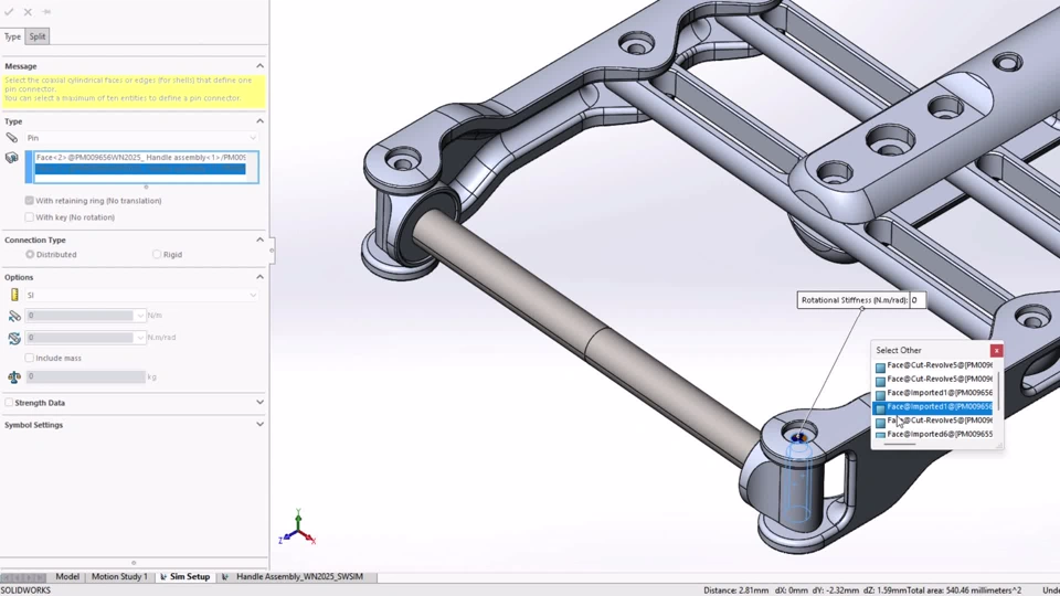

[ENHANCED] Pin Connector
Description: Improve the solution performance of all studies when using the distributed Connection Type for pin connectors.
Benefit: Increase the accuracy of simulation studies using the improved pin connector

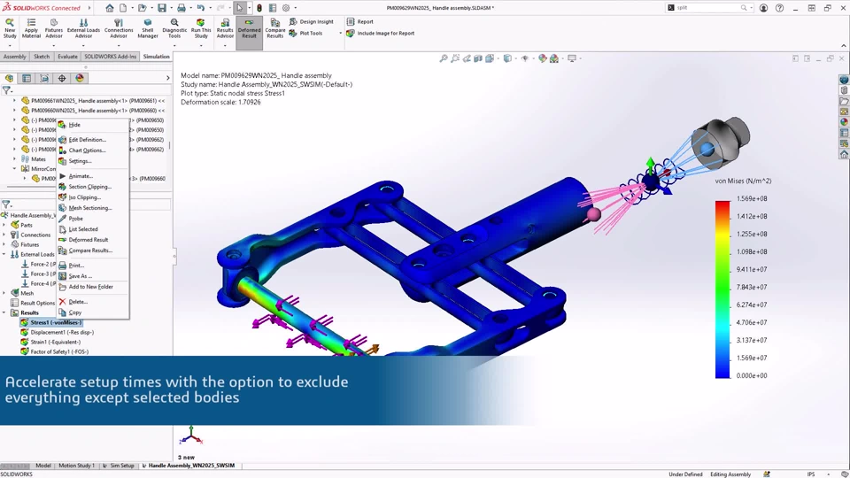

[ENHANCED] Handling of Large Models
Description: Accelerate study setup times with the new UI option to exclude everything except selected bodies. Concentrate on what is important by removing parts or bodies excluded from the simulation study.
Benefit: Easily set up large models and select boundary conditions with a clean display.

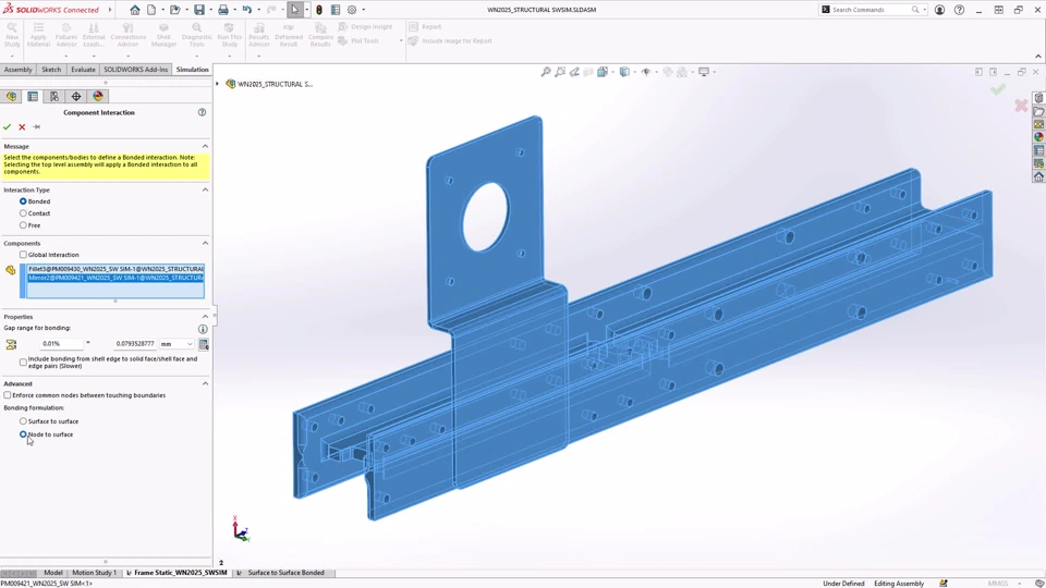

[ENHANCED] Node-to-Surface Bonded Interactions
Description: Avoid gaps between surfaces in Mid Surface mesh studies. Experience enhanced offset bonded interaction to improve contact results accuracy for linear static, linear dynamic, frequency, buckling, fatigue, design scenario, and pressure vessel studies.
Benefit: Perform more accurate simulation studies and solve faster.

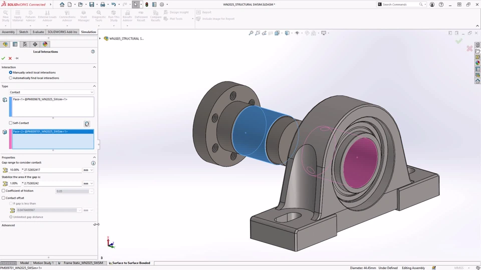

[ENHANCED] Surface-to-Surface Bonded Interactions
Description: Improve the accuracy and performance of cylindrical, spherical, and conical surfaces for all linear studies with enhanced surface-to surface-bonding.
Benefit: Enjoy improved usability without sacrificing accuracy.
