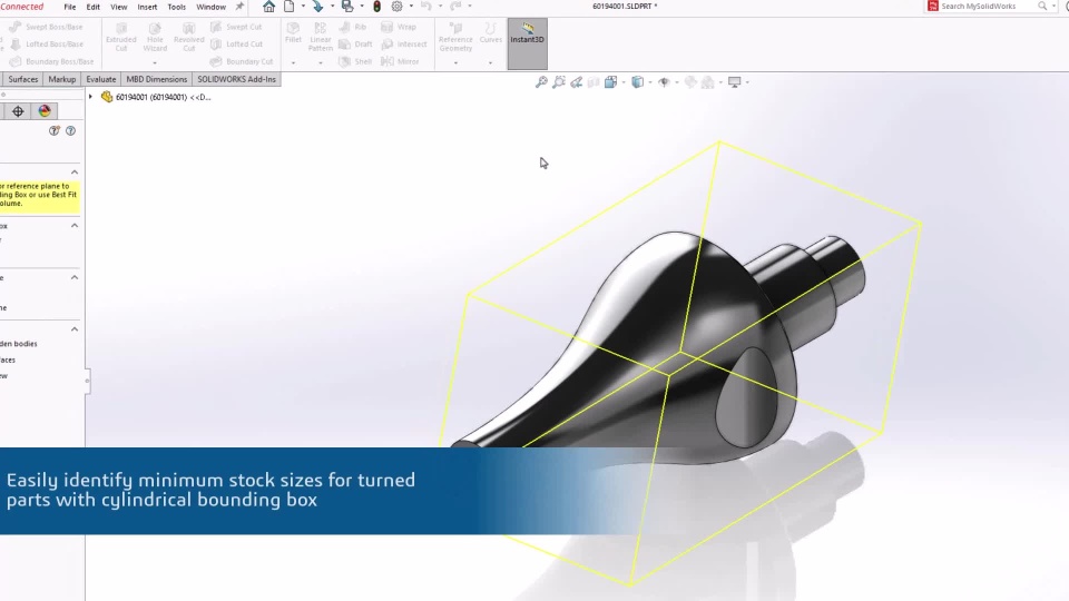

Parts and Features
Speed up sketching and capture design intent more clearly. 3DEXPERIENCE SOLIDWORKS 2024 includes a new options to
  • Preview and edit a dimension as soon as you select one or more entities.
  • Create bidirectional symmetric patterns with the Symmetric option for Linear Pattern.
  • Display the unit of measurement as a custom property in notes and tables.

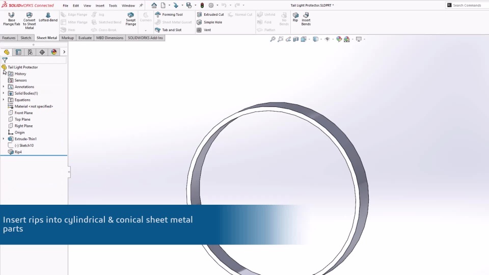

Sheet Metal and Structure System
Save time and meet manufacturing standards more easily. For sheet metal design
  • Use the new Rip tool to create rips in hollow or thin-walled cylindrical and conical bodies.
  • Simply by selecting an edge on a cylindrical or conical face, you can flatten the part as sheet metal.
  • Normal Cut option for slots when tabs are created at an angle and automatically propagate slots to all instances of a tab that intersects a specific part.

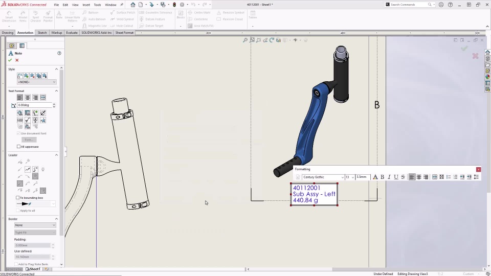

Drawings and Detailing
Create drawings that communicate designs more clearly and ensure your design intent is crystal clear with new options and detail drawings faster with improved chain dimensioning alignment and adherence to drawing standard
  • Clean up dangling dimensions more efficiently by reattaching them to the proper reference points.
  • Exclude hidden sketches from DXF™ Flat-Pattern with a new option.
  • Provide awareness of items with highlight reference at your fingertips.
  • Reduce chance of error with differentiated color of overridden dimensions.

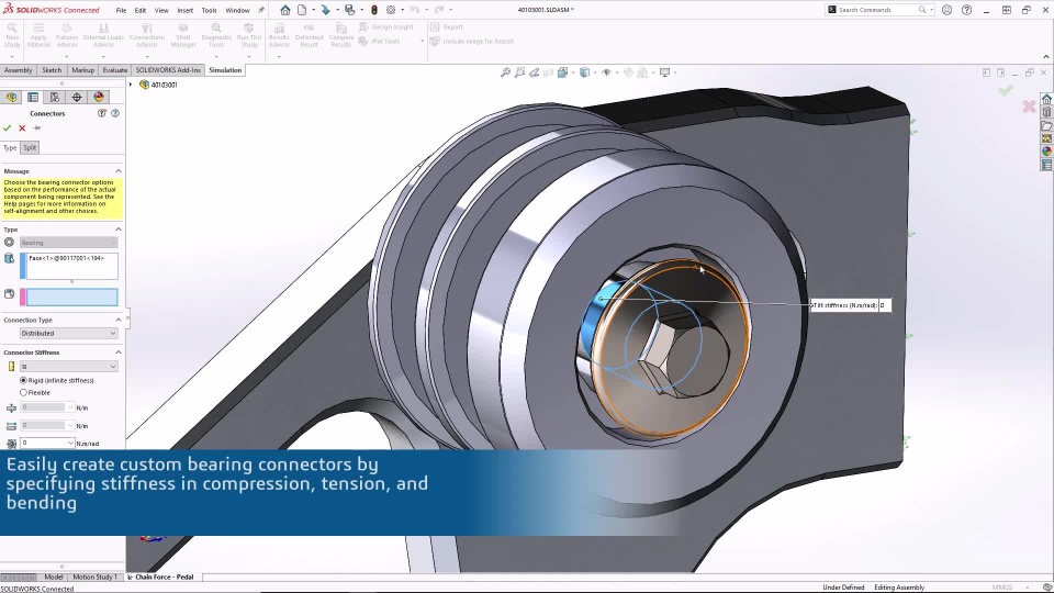

Simulation
  • Save time when creating duplicate studies by excluding the mesh and the results data.
  • Easily create custom bearing connectors by specifying stiffness in compression, tension, and bending.

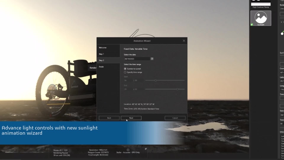

Visualize
  • Ensure consistent experience across 3DEXPERIENCE platform applications with DSPBR appearances.
  • Provide greater clarity and efficiency with new manipulator.
  • Advance light controls with new sunlight animation wizard.
  • Provide greater efficiency with Streamlined Render Output Wizard and craft stunning product animations with interactive video output.
