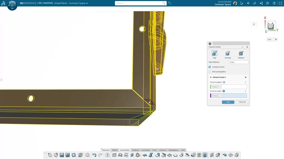

To ensure a watertight seal and optimize the structural integrity of sheet metal design, any gaps between overlapping flanges must be closed off. Close Corner feature eliminates the manual process of extending the flanges to close the gaps.
