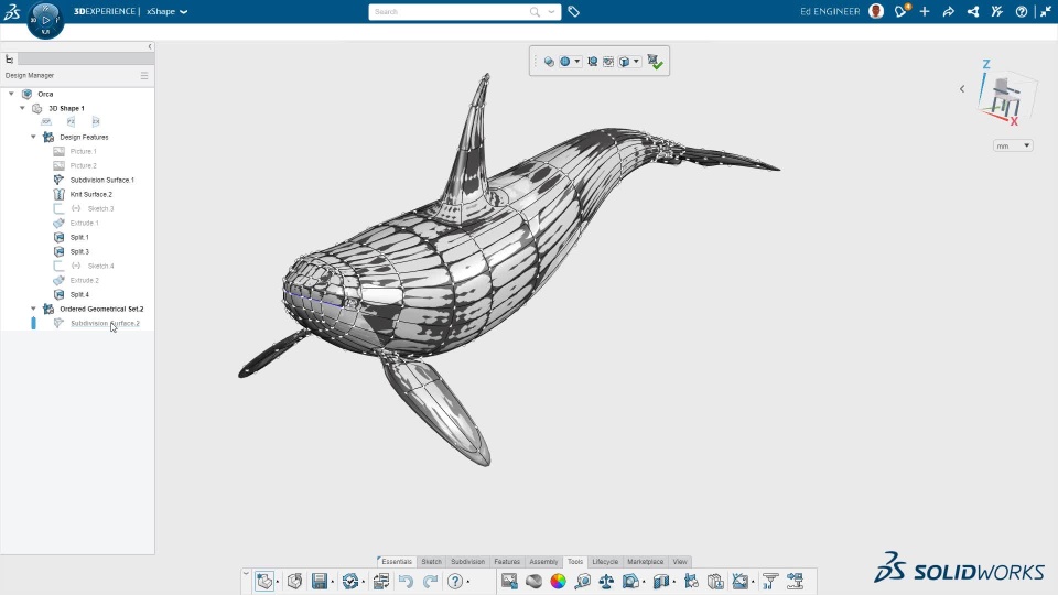

New shaded previews to improve visual feedback given to users so that the parameters for commands can be set as desired without confusion. Create Ordered Geometric Sets (OGS) in order to more easily organize your designs.

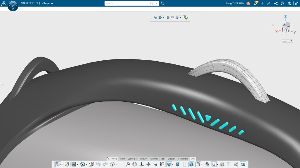

Subdivision primitives can be created with sharp edges and can snapped to the model origin. Ordered Geometric Sets help users organize their models. Copy/paste of subdivision speeds modeling. Bounding box lets users quickly resize subdivision geometry.

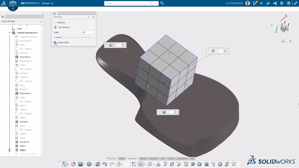

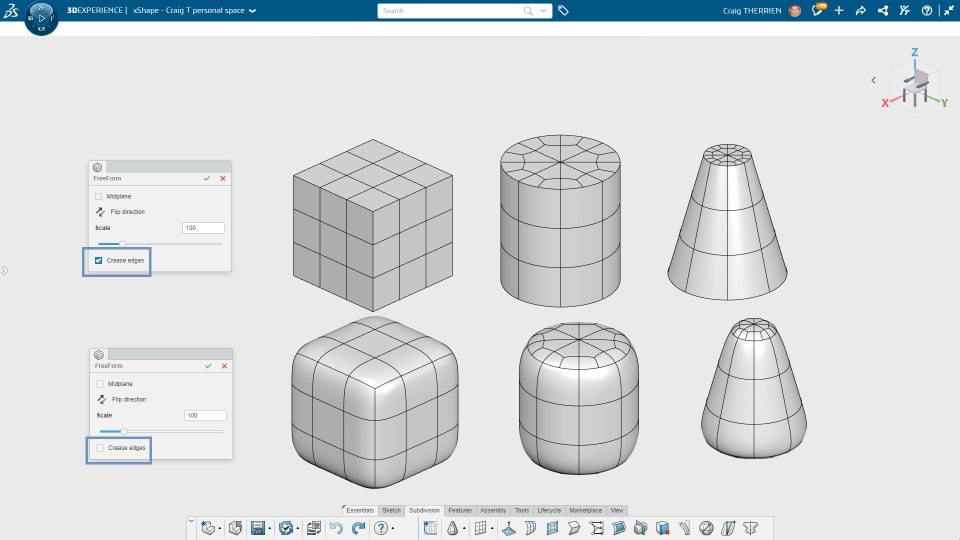

Subdivision primitives can be created with sharp edges as an option, and can snap to the model origin.

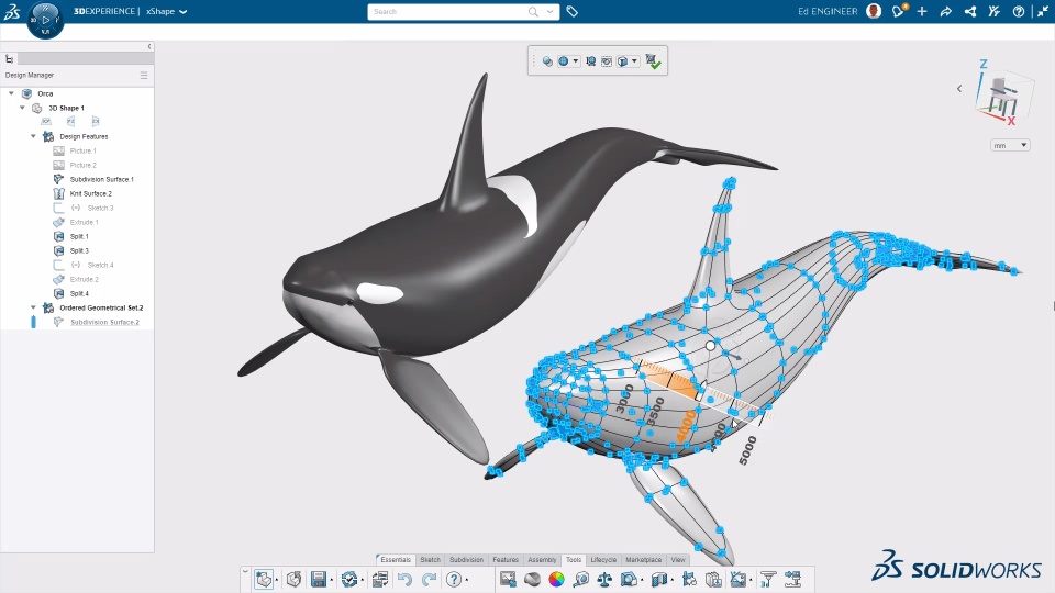

Users can copy, paste and manipulate subdivision geometry quickly and easily.

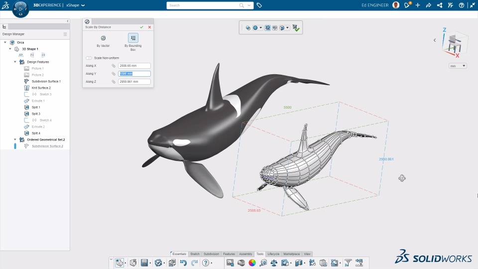

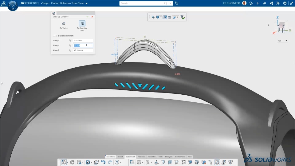

The bounding box tool lets users scale subdivision geometry uniformly and non-uniformly.
