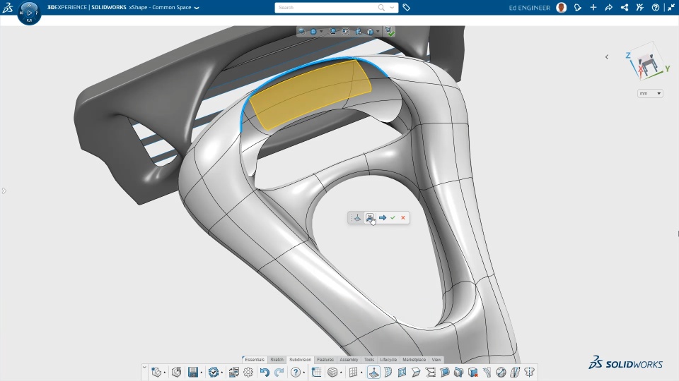

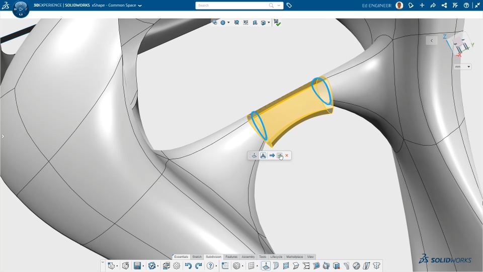

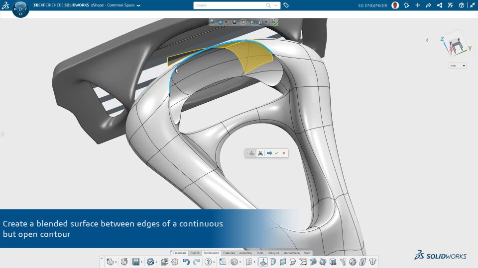

Create and modify geometry with more options. In this release, subdivision geometry creation is improved once again. Users can now merge edges of subdivision surfaces together allowing more flexibility in the way they create their subdivision geometry.

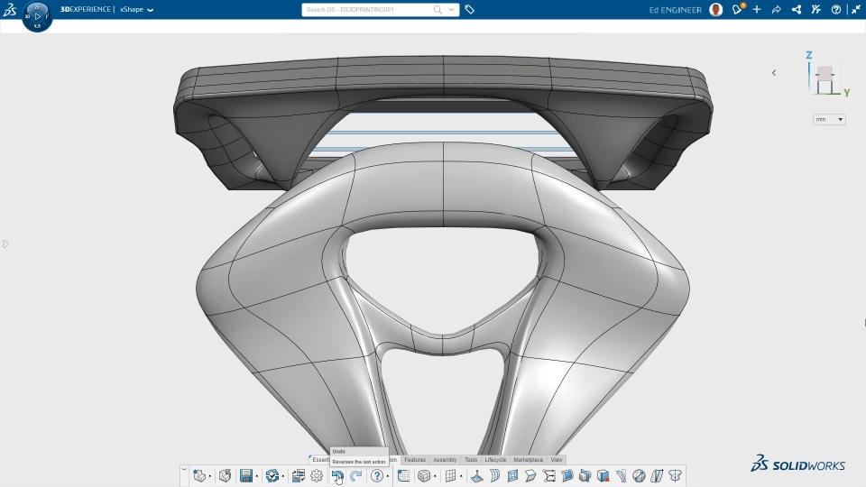

Make changes with the confidence that you can recover your previous state. A great enhancement for this release is the improvement of the Undo command. Now Undo works even after exiting the subdivision environment. This allows users to correct mistakes they may have made editing subdivision geometry, even after exiting the subdivision environment.
